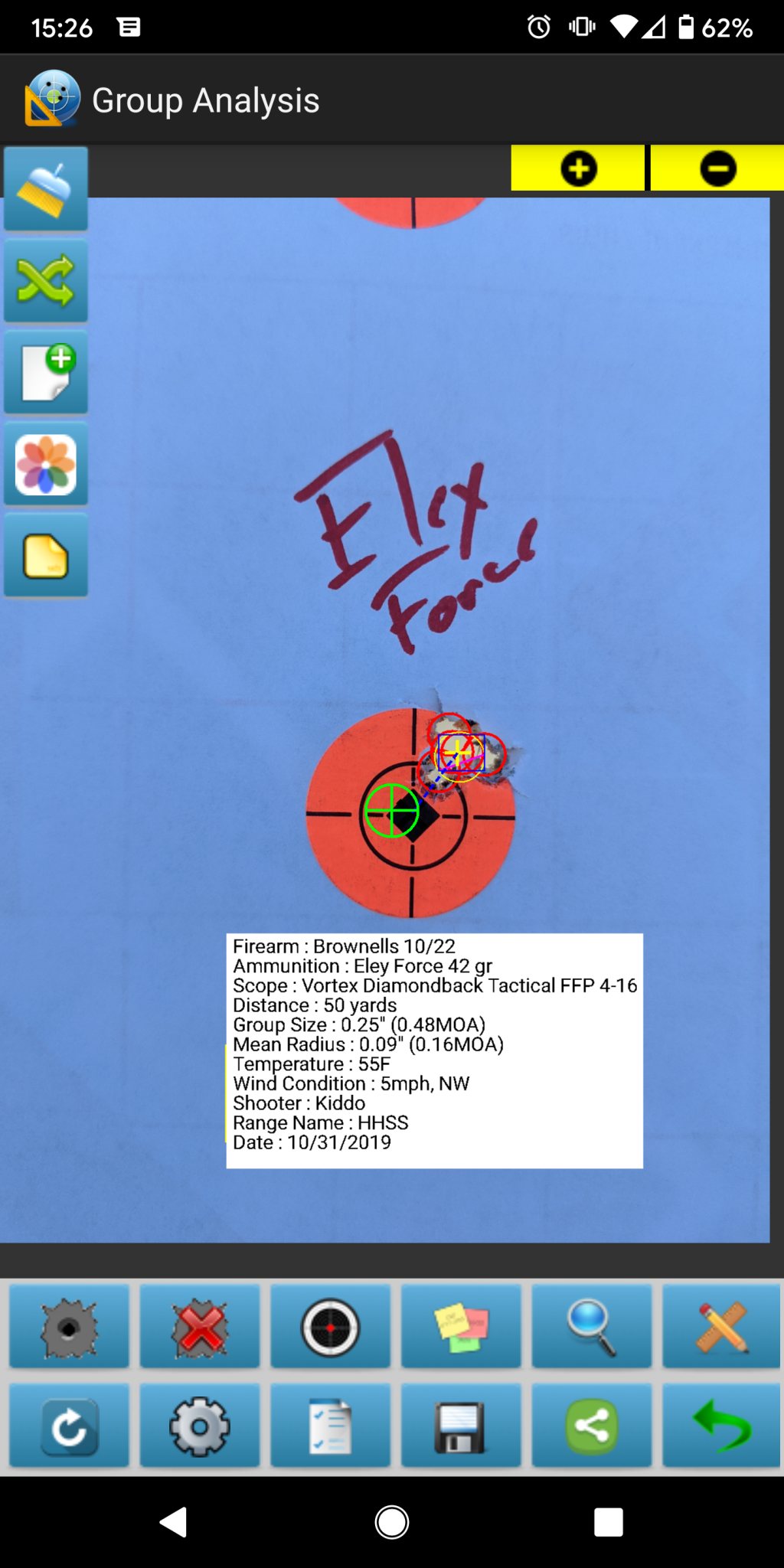

I built a 10/22 last year. Had fun with it but it did get somewhat costly. Here's the list of parts:
-Brownells receiver (Kidd bolt, guide rod and spring, charging handle, bolt buffer, receiver pins and v-block)
-.920 straight fluted barrel from Shaw Barrels
-Brimstone tier 1 single stage flat trigger
-Magpul Hunter stock (Recently changed to KRG Bravo and it was such a great upgrade)
It shot pretty damn good and favored the Eley ammo the most and it surprisingly shot federal automatch extremely good as well. Here's how the Eley shot. The automatch wasn't far behind for performance.

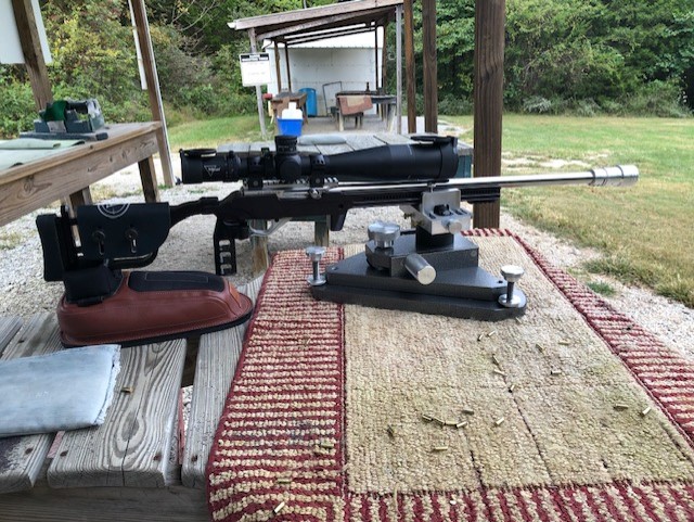

A KIDD or Joe Chacon custom are the only 10/22 platforms I would want.
I have a Chacon and it shoots very well for its intended purpose.
Actually pretty close to a Vudoo at times.

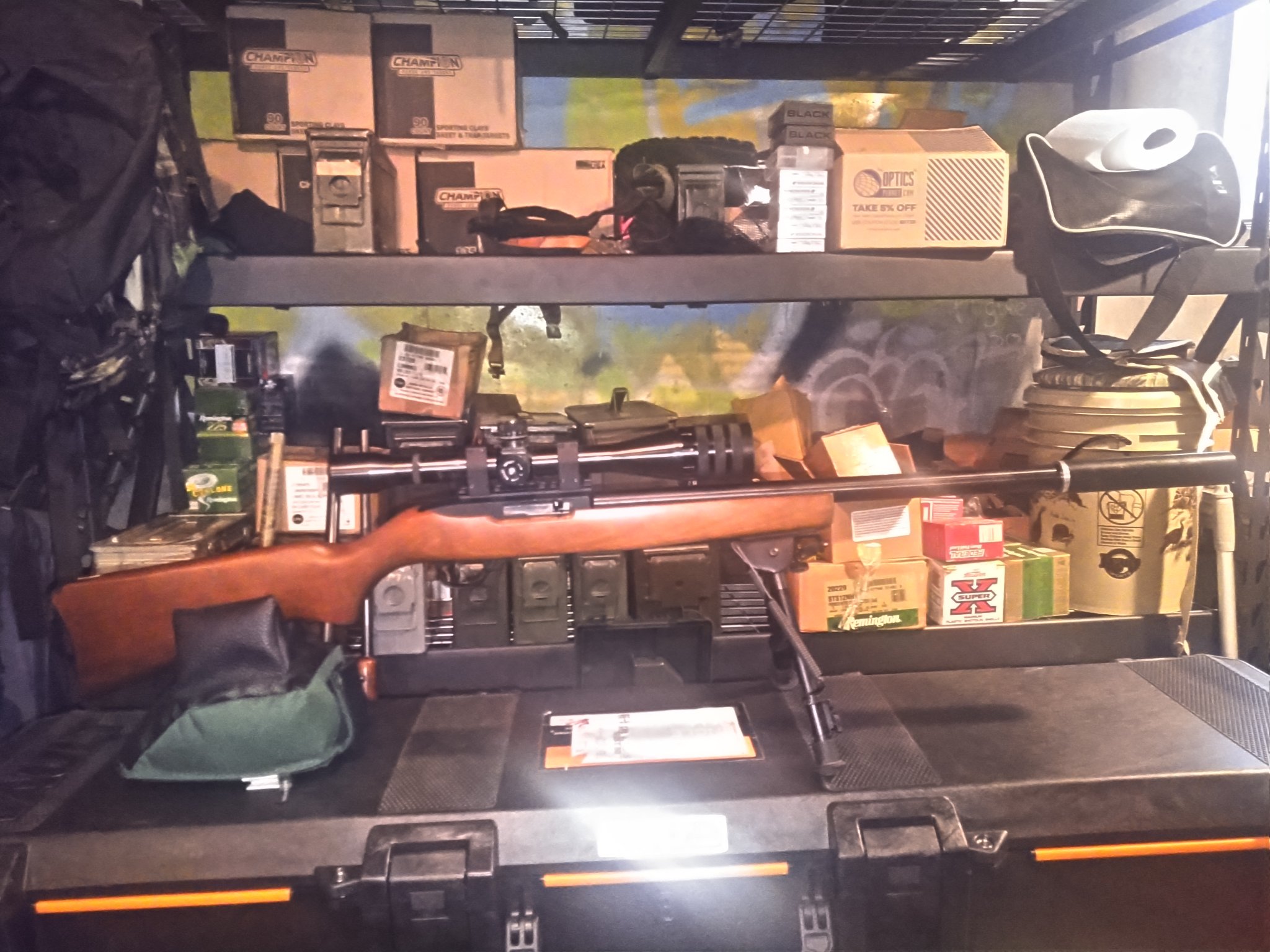

I decided to see what I could do with some of the 10/22 pieces and parts laying around the shop. So here we go. Stock receiver and bolt from a mid 70's gun, Adams and Bennett (E.R. Shaw) 16.5 inch barrel. 1/14 twist. It's threaded so a 00,LLC suppressor also. I have no idea what generation the trigger came out of. I opened up a standard stock to clear the .920 barrel and reshaped the fore end. 0 MOA base, EGW 1" rings and the Weaver T-10 that's been on half the project rifles I built since the mid 80's. I'll try it out tomorrow.
