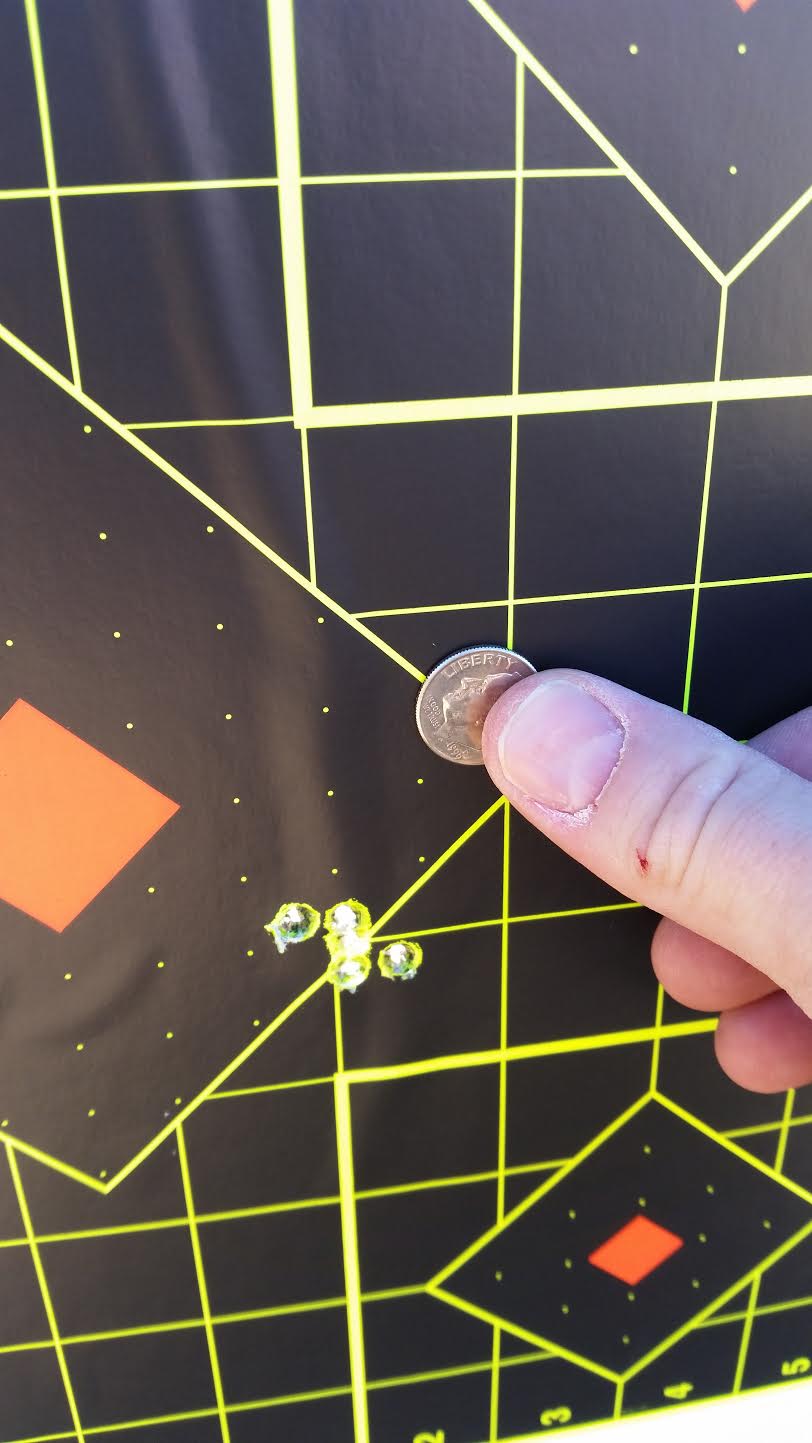

Ruger predator is amazing. This is a 5 shot group at 100 yards with 77gr Norma match. Got my Omega muffler in today which might of helps with the group ;). Might have to get a Tikka t3x varmint in a 223 now. :)

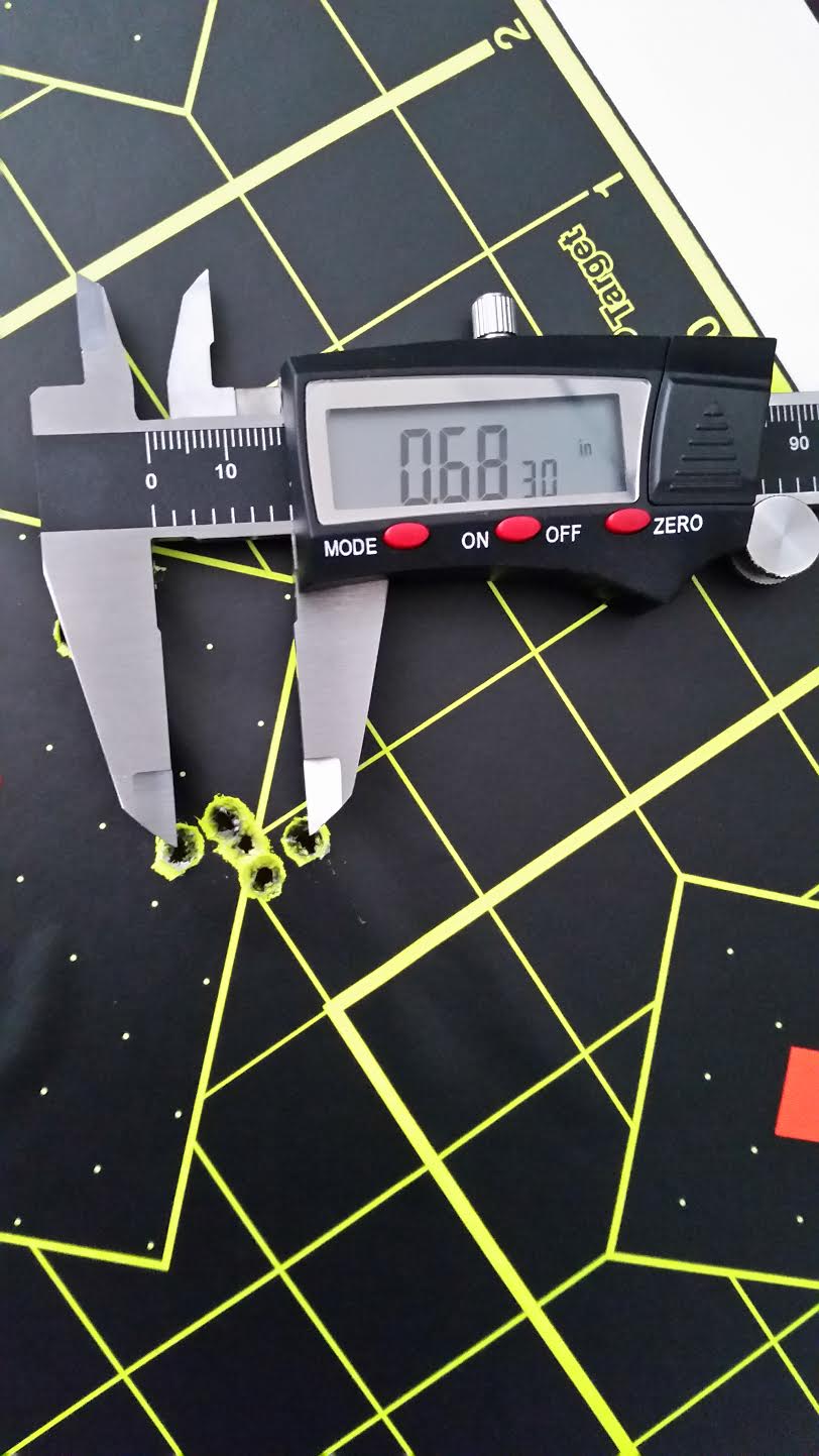

I love mine as well. Group pictured is 5 shots at 100 yards with 73gr ELD-m handloads at 5 thousandths off the lands, 2900fps. It’s consistently sub 0.50” at 100 yards even on my bad days. Hangs around 1/4” when I’m “on my game”
First time I ever took it(and 223 for that matter) out to 1,000 yards I averaged a 5/10 hit(or miss) ratio on a 1 MOA gong. Next time out to do it I was averaging 8/10 hits and had a couple 10/10 hits, doing 10 shot strings the whole time.
It’s become my favorite rifle to shoot.

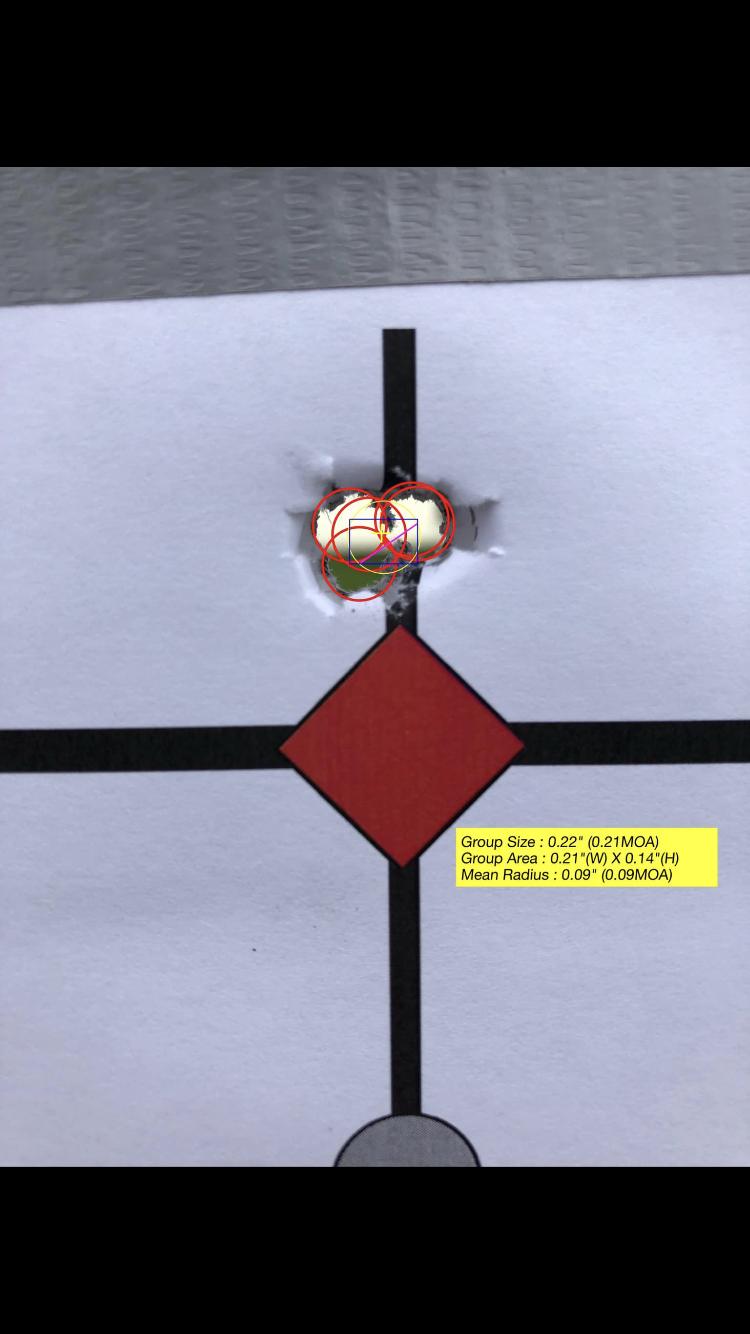

This is the best that I have shot. looks like I can do better!

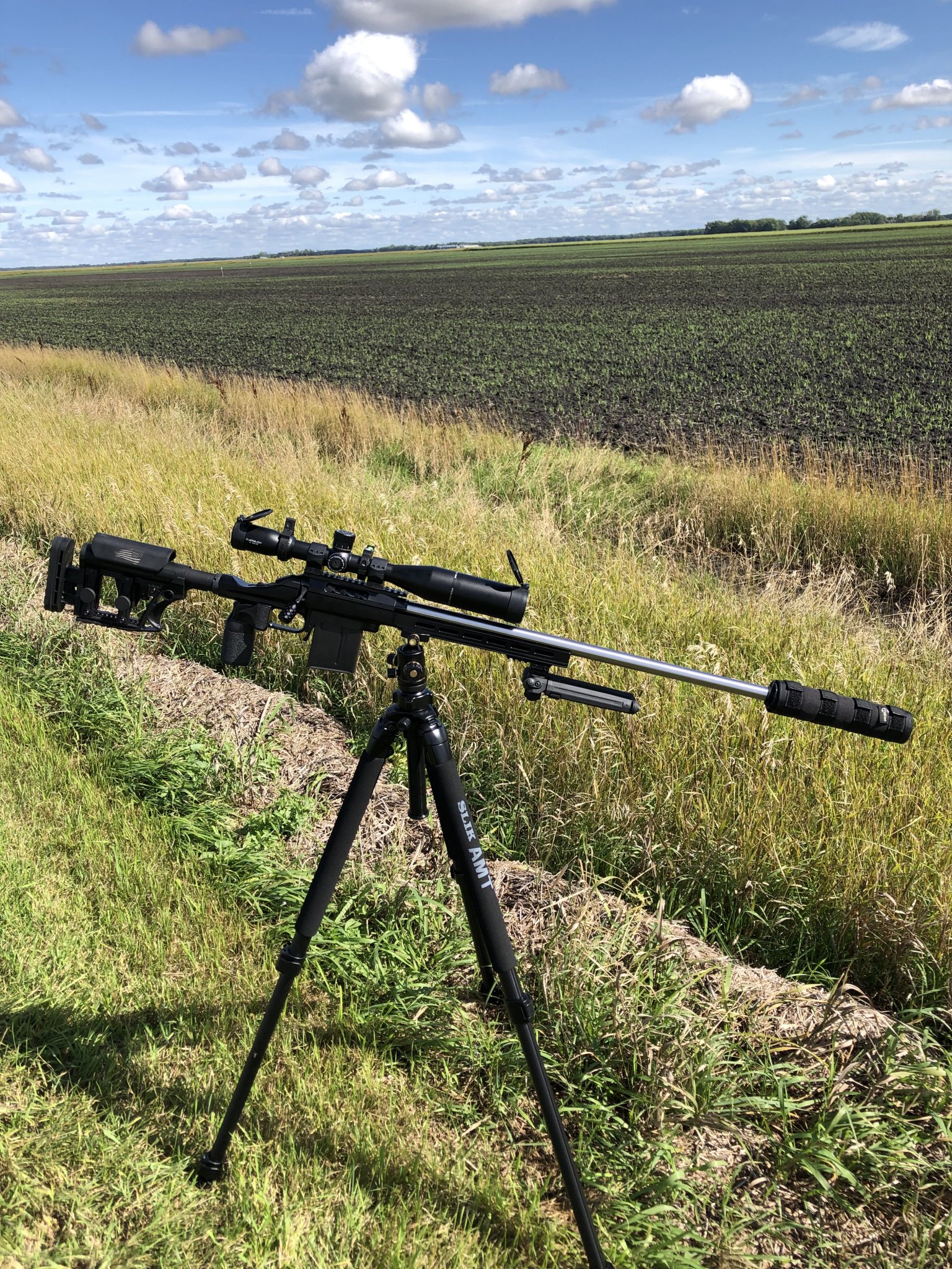

This is my RAP 6.5 with PVA barrel in an American made Indian Creek Design MoFo chassis
Reactions: CarbonMTN

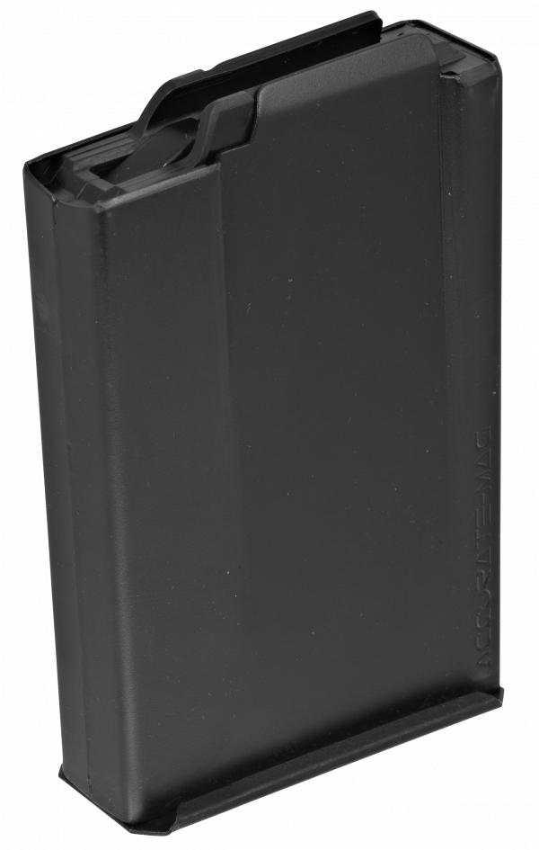

To feed 223/300bo you just need to email accurate mag for their extended feed lip 223 aics mag. It controls the round long enough for the bullet tip to start into the chamber before popping free of the mag for reliable feeding.

Has that been successful in the Magpul stock though? A big issue in the Magpul stock has been the magazines sitting too low in relation to the action/bolt because of Magpuls messed up AICS specifications they use
I use the Long feed lip magazines(accurate mags) that the old Ruger Scout used in a chassis for my RAP 223 and they work great. But others said they couldn’t get them to work in the Magpul stock. I told them to build up the magazine catch so the magazine would sit higher in the action, but nobody was willing to “tinker” with the magazine
Idk, my problem when I tried the magpul hunter was that the magazine feed lips weren’t long enough. Never had an issue with the rounds not getting picked up by the bolt, just popping free of the magazine before having entering the chamber so they rattled about freely and ran into the barrels face and never fed completely. I returned it but have since gone to the oryx and with the old mags it’s the same problem but extended feed lips mags work great.

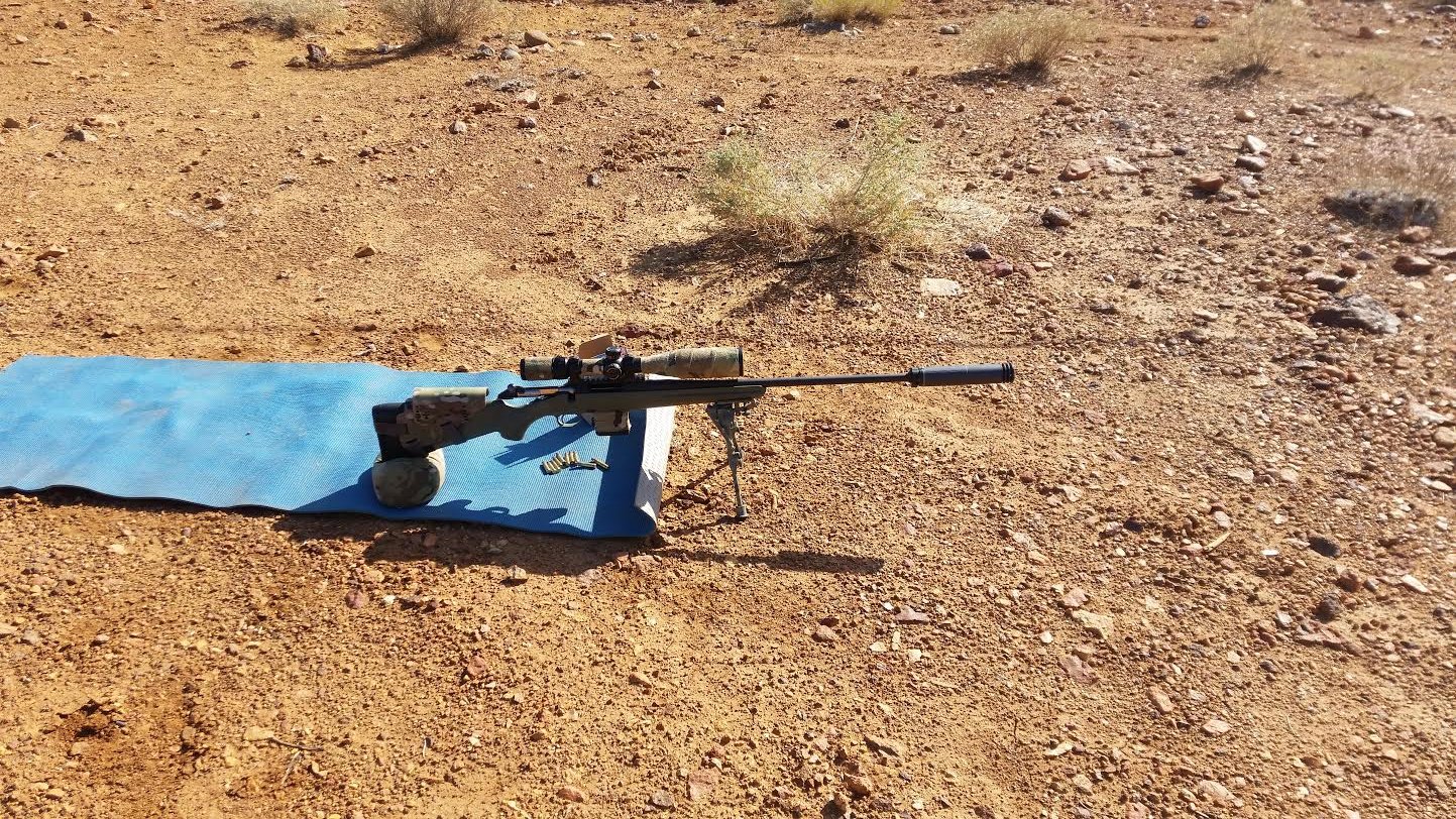

For those that have the Ruger Predator AND have tried to hang a muffler off the front, how much does the barrel flex?
I haven't had any issue with mine flexing. POI was within an inch left of no muffler.
Not that much. You’ll obviously see Point of Impact shifts but just how much will vary
Is the barrel so thin that it flexes (droops) an appreciable amount when a 12oz suppressor is screwed on to it.
to my touch it has zero flex. Its not a ultra light barrel. but only a slow-mo film will show any true flex.

I should’ve clarified when saying “the barrel doesn’t flex that much”....I just meant you’ll see a Point of Impact shift going from nothing on the end of the barrel to adding a suppressor or muzzle brake. You can’t see the barrel actually flex.
How much POI shift you’ll see will vary depending on how much weight you add. My current suppressor weighs 13 ounces, and then the cover adds an additional 6 ounces I think. POI shift was around 4” down and slightly to the left if I remember correctly
This is something they don't have up on their website?

Trial and error. By the time I figured out what needed to happen the mag was pretty ugly. I built up the catch bump and also notched the corners of the mag that contact the underside of the reciever. Now that I know what I'm doing I need to buy another one and do a more professional looking job.

Correct. You will order their normal 223 mag on the website but you should make them aware of the order beforehand (and maybe in order notes too, can’t remember) and they will send you the proper mag.
Ruger sells a 10 round polymer AICS pattern 223 mag (#90562). Run one in my PTG bottom metal Savage 223.
Which magazine are you using?
