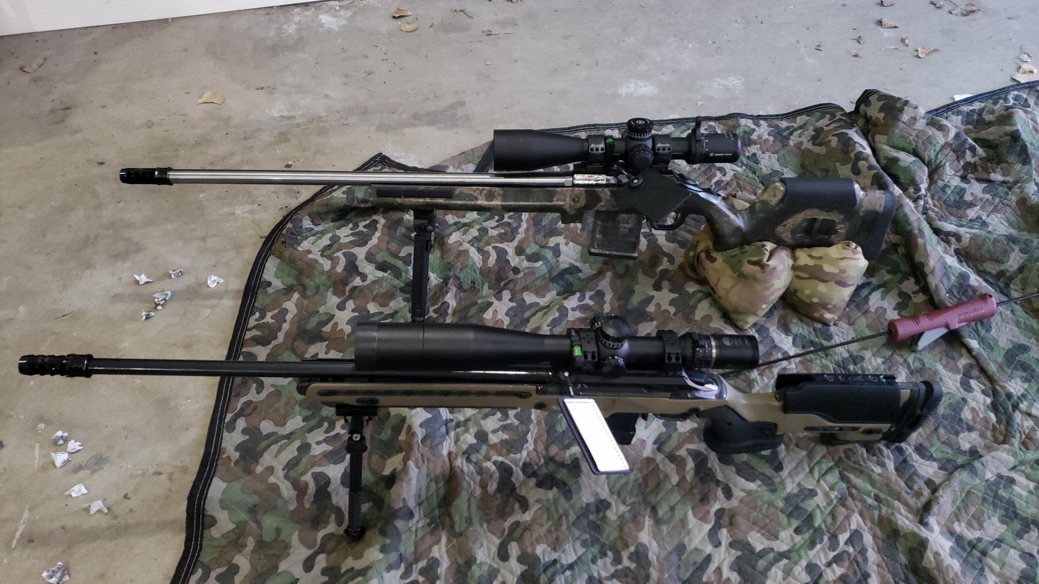

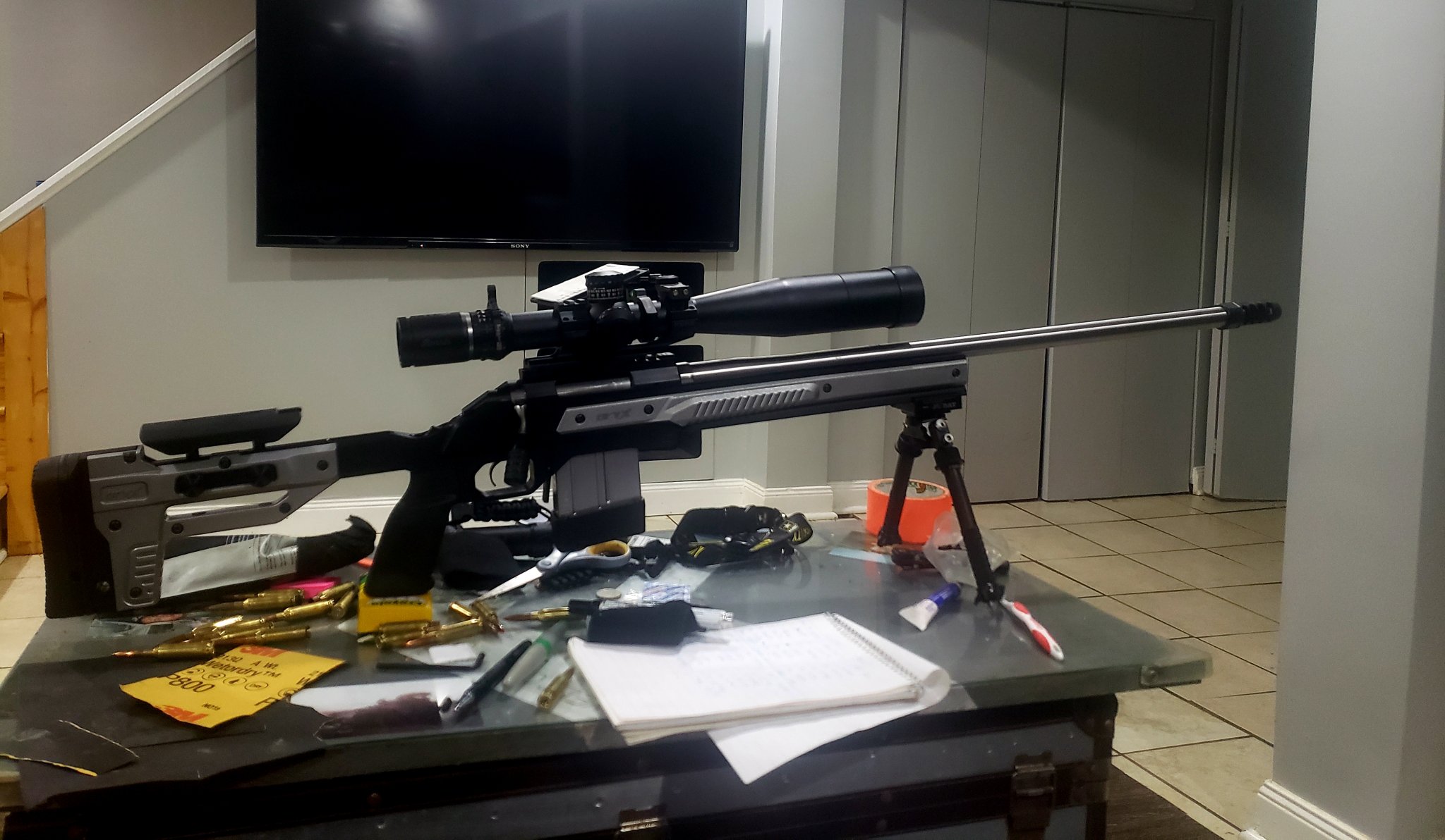

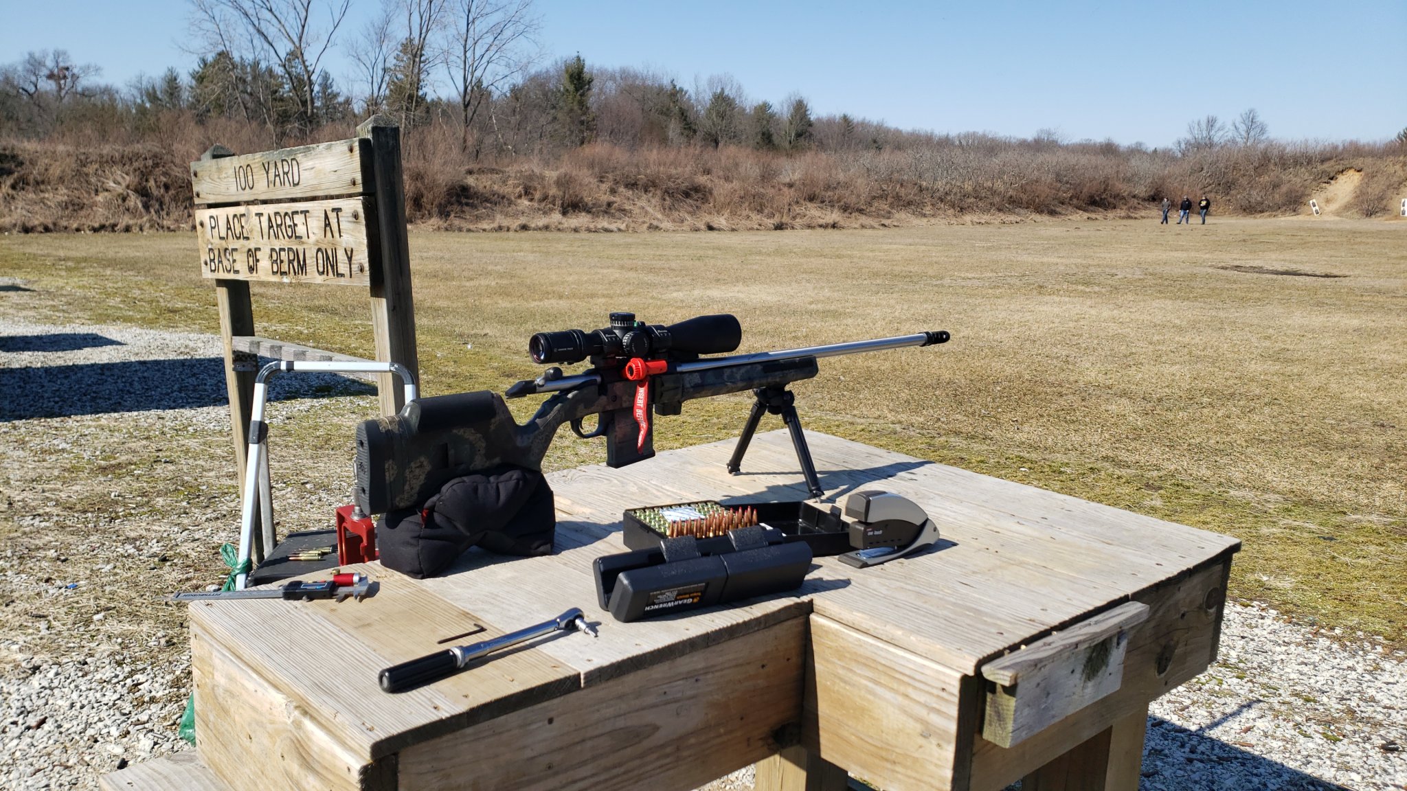

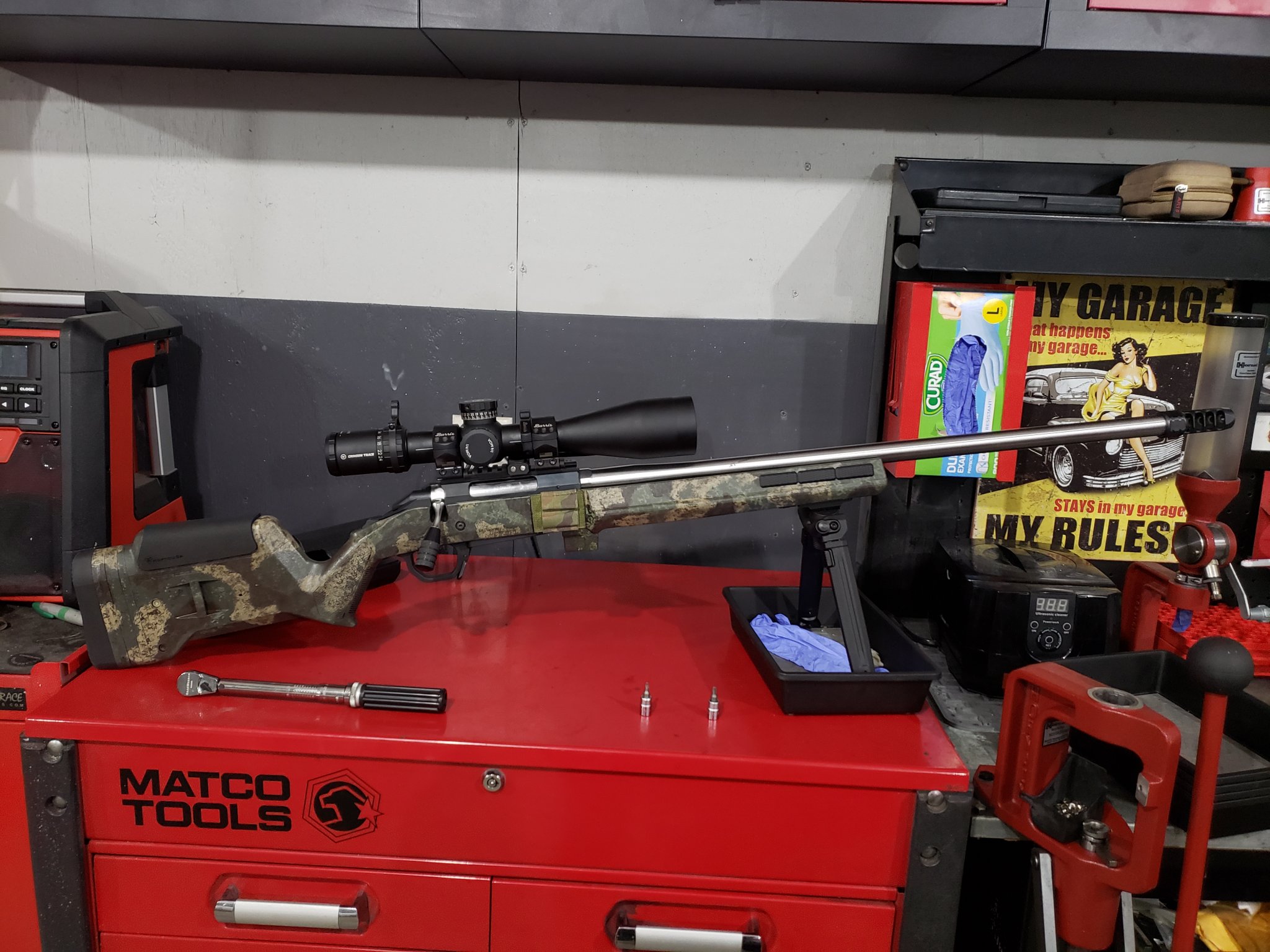

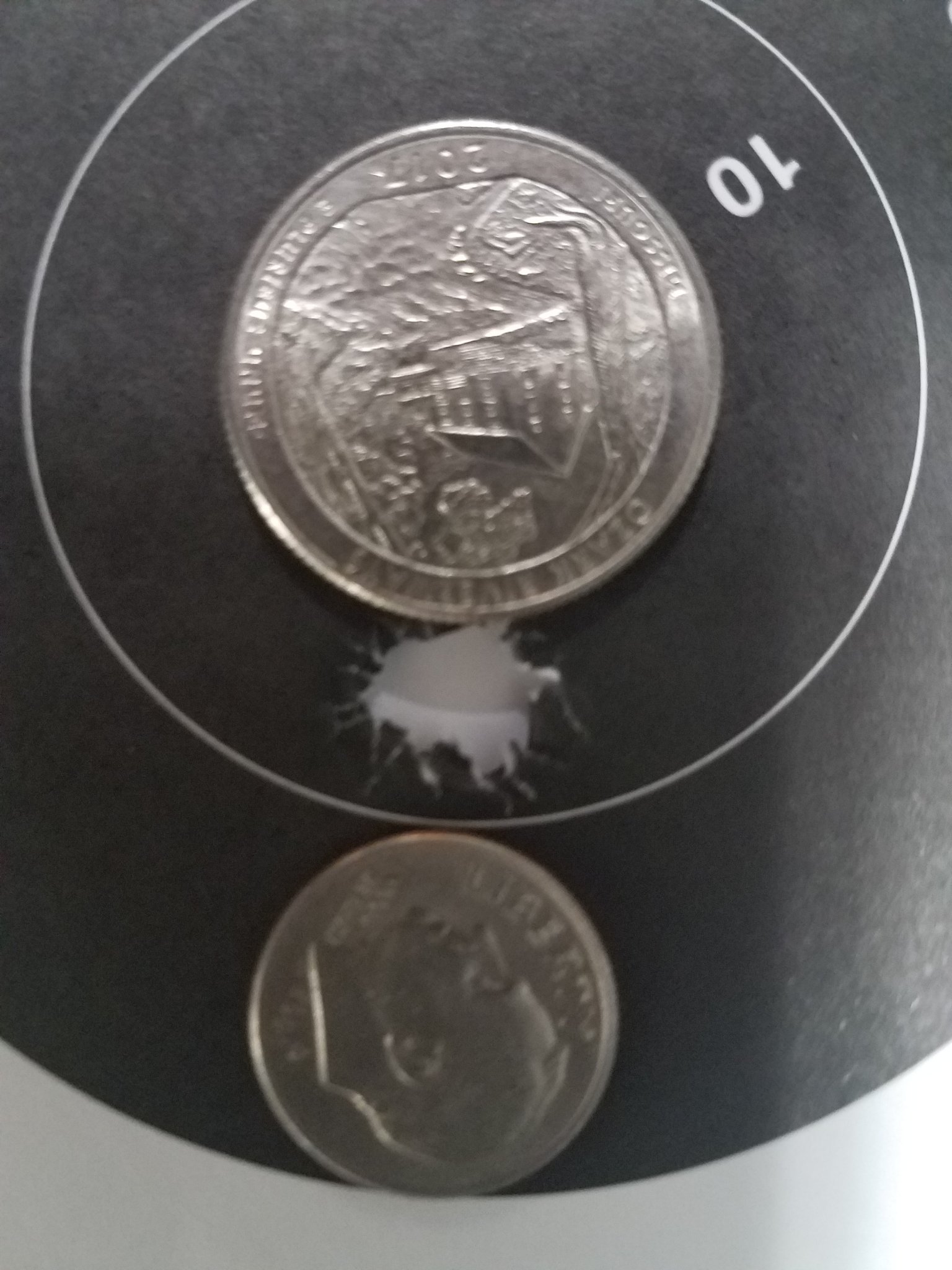

I actually started prs with a ruger American predator, 6.5 creedmoor. Very accurate rifle, with hornady 147 eld match the rifle shoots 1/2 moa. Replaced the stock with magpul hunter American and timney trigger. The rifle will hold 1 moa with 12 rounds down the factory barrel. The back end of the bolt is a little sharp, so I smooth it out to prevent the bolt from catching on the next round. I also modified the magpul magazine so there is no issues with loading one round. Was having problems with light strike first round, simple fix with polishing the firing pin. Pretty amazing rifle for the money. Just recently replaced the barrel with preferred barrel blanks. Very effective rifle for the money and it's a little easier to be a little rough on it during competition. Have another rifle that cost 3 times more and shoots just as good. Image is with the factory barrel, hornady 147 eld m five round group, bipod and rear bag. Hope this helps

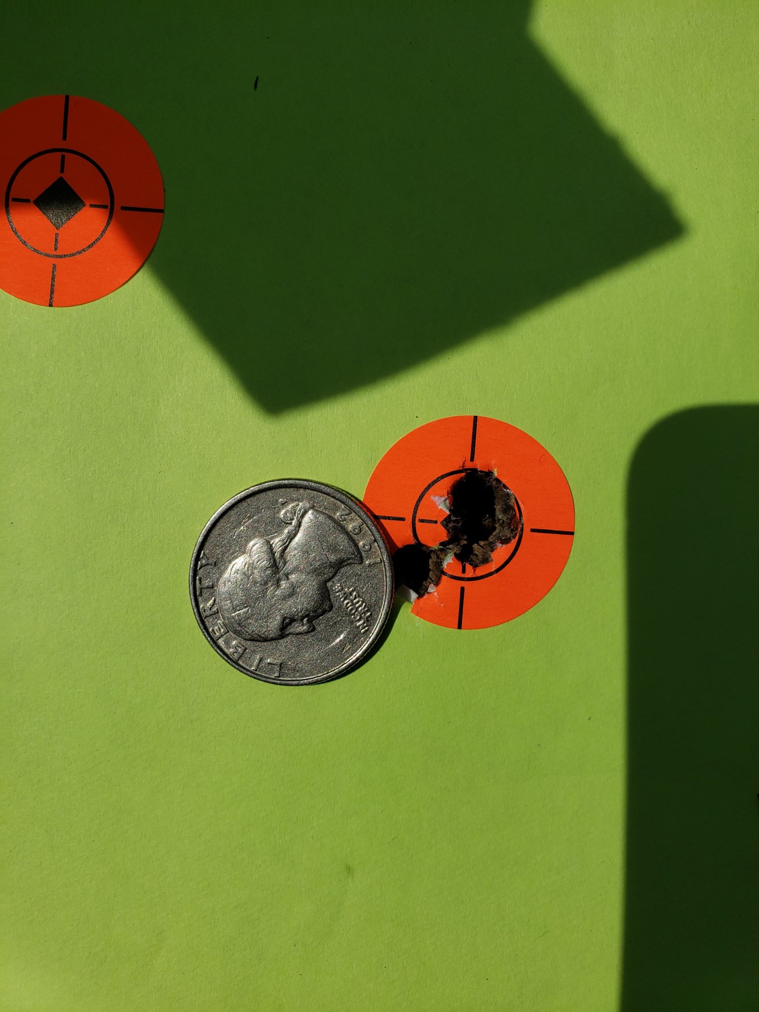

When I started with hand load for it with the factory barrel, it likes a massive jump to the lance .016 of the lance. It's a crazy jump, but works for 1/2 moa, hornady 147 eld also have a really large jump. I've had really good experience with the rifle with a little work and I still compete with it primarily just cause I don't want to beat on my other rifle. It's also nice to be competitive with a price people can actually afford.
Sorry that's at 100 yards factory barrel, this is with the new barrel and hand load. I think I pulled one, 5 round group. Lol, almost seems like it shot better with the factory barrel and bullet. The rifle feels more balanced with a heavier barrel on baracade, but still very effective with factory barrel.

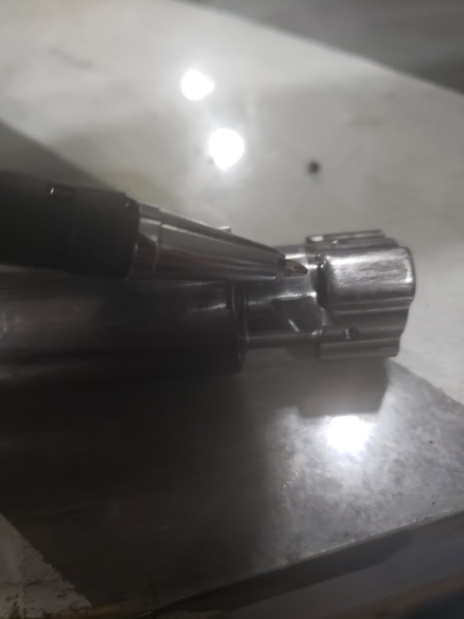

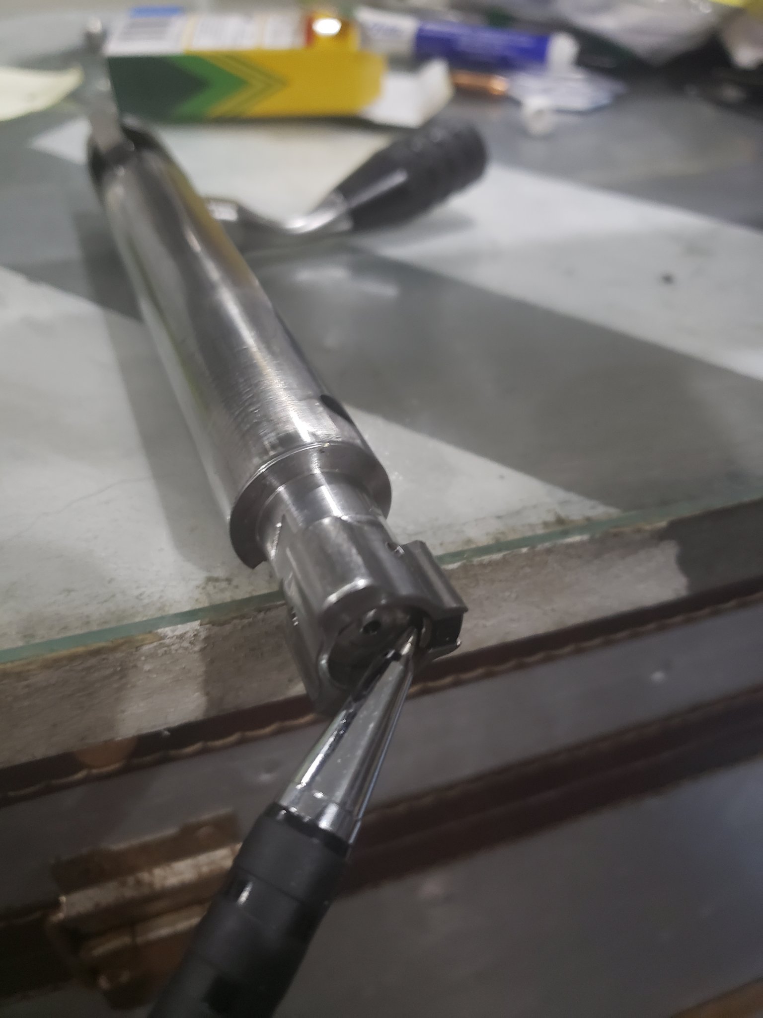

Yes the bolt is factory, just replaced the knob and light polish with a dremel on the firing pin. Was having issues with light strikes first round and the issue was the drag when the bolt is hold open for too long and might be a little dry on lube
There is 3 prongs on the bolt to lock. The bottom prong will catch the next round and prevent you from opening the bolt some times. Very simple fix, just round off the sharp edge on the bottom, don't need to touch anything else on it, just the sharp edge and it will glide over smoothly. I think it's to keep the cost down, so polishing the bolt was another way to save production costs. Very very minor issues and very simple fixes and the rifle is very competitive

The scope is a crimson trace, very good scope for the price. 5x24x56 ffp, you can buy them now for $550, no zero stop but a simple fix. I used a Burris signature rings and a 20 moa base. You can cant the scope down with the burris inserts and move the distance to change how much moa to angle. I have 2 moa pass zero and a total of 80 moa of elevation. I have strap my game changer on top of the scope and never lost zero. The main theme of this rifle was to be affordable and very competitive with an actual affordable build. Paint is just a sponge paint and just do pattern that you like.
Glass is extremely clear, clearer than than the other scope I used for about 3 times price. Tracks extremely well and return to zero with no issues. Turret is tactile, I'm not sure if there is a better scope for the price point, but could be wrong cause I've only compared it to vortex diamondback.

I had the same issues with the bolt being sharp. Other than that the action and bolt were true from the factory. I rebarreled mine to 6mm Creedmoor and haven’t looked back. Still in the Magpul hunter stock too!

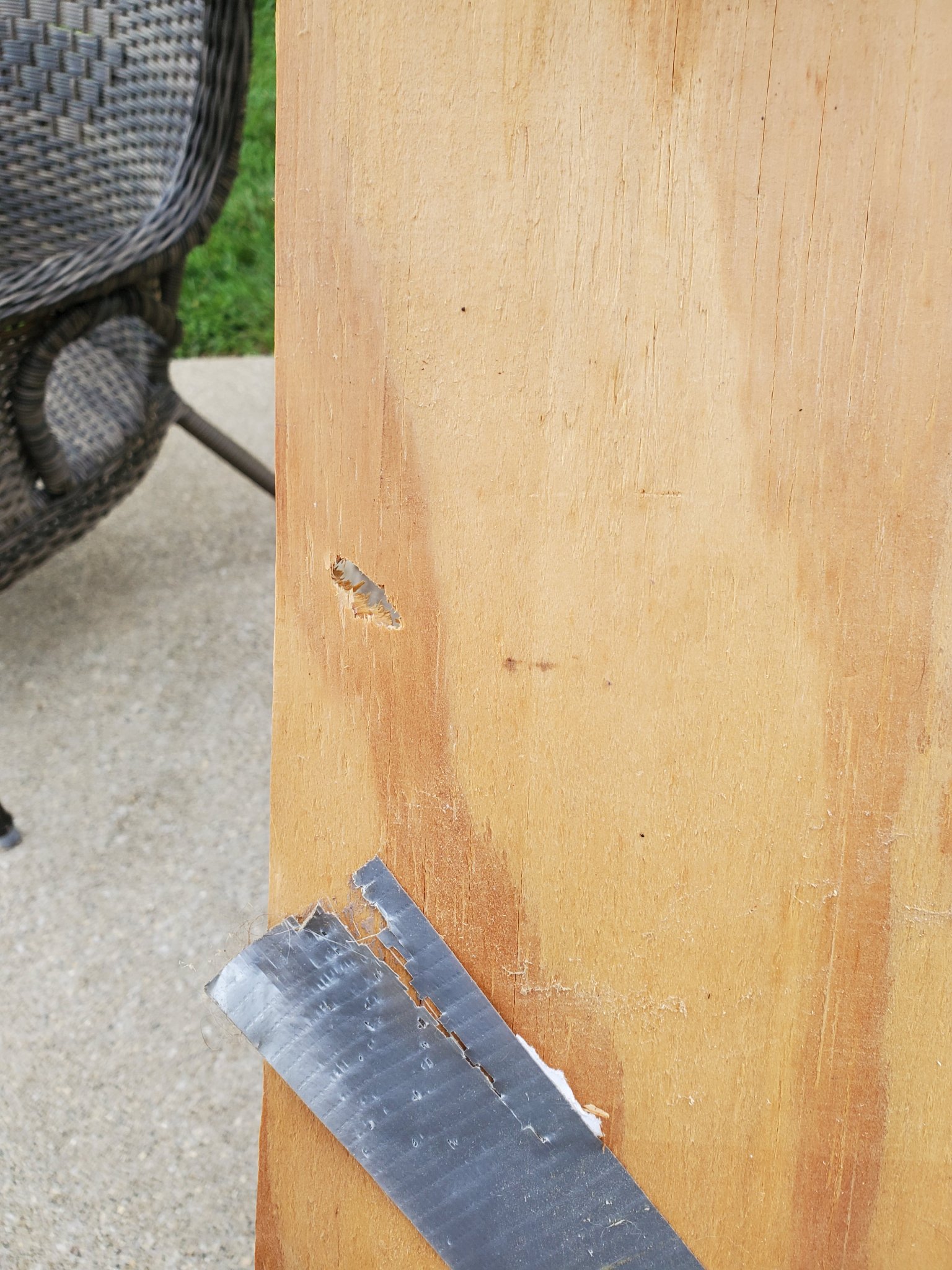

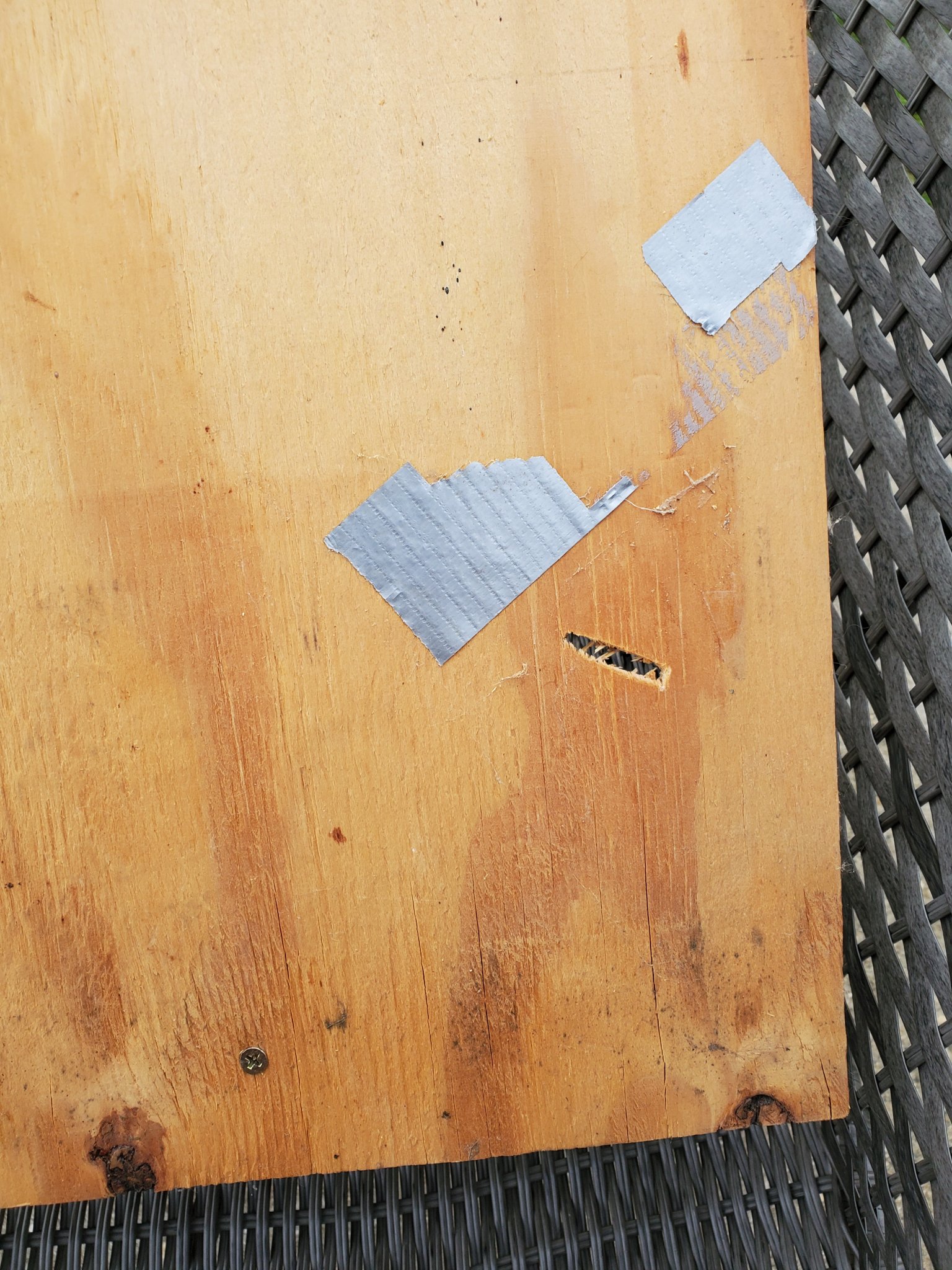

Just purchased the exact rifle. Jury is out, at this time trying to rectify an issue that I feel is the gun and not the ammo. The following photos are of 1 shot at 100 yards and another at 65. Yes close range but was sighting scope before 225 yard to finish. Brand new right out of the box, these are the only 2 rounds put through the gun
