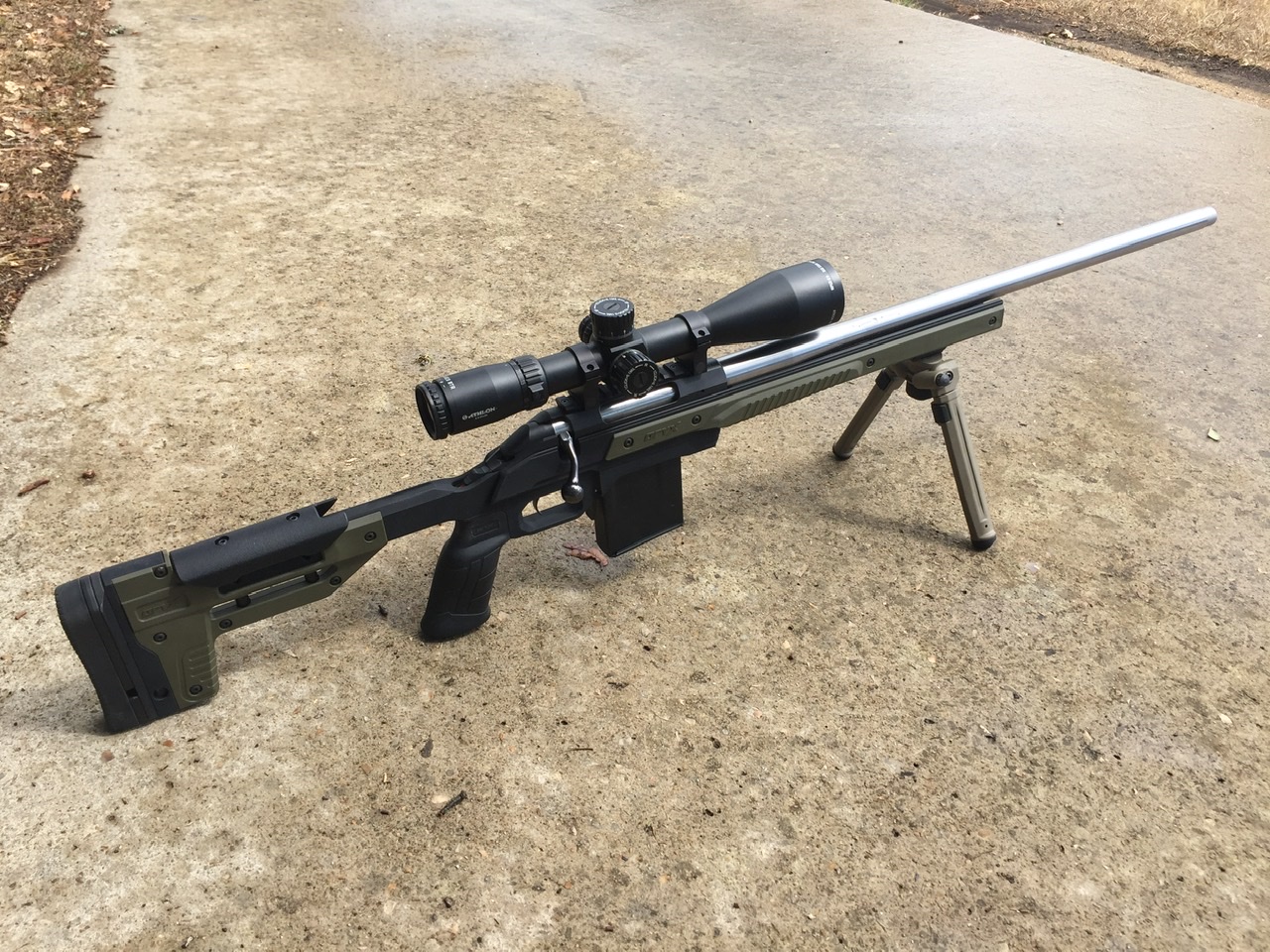

Your other option is the Oryx. The Oryx should be a decent upgrade.

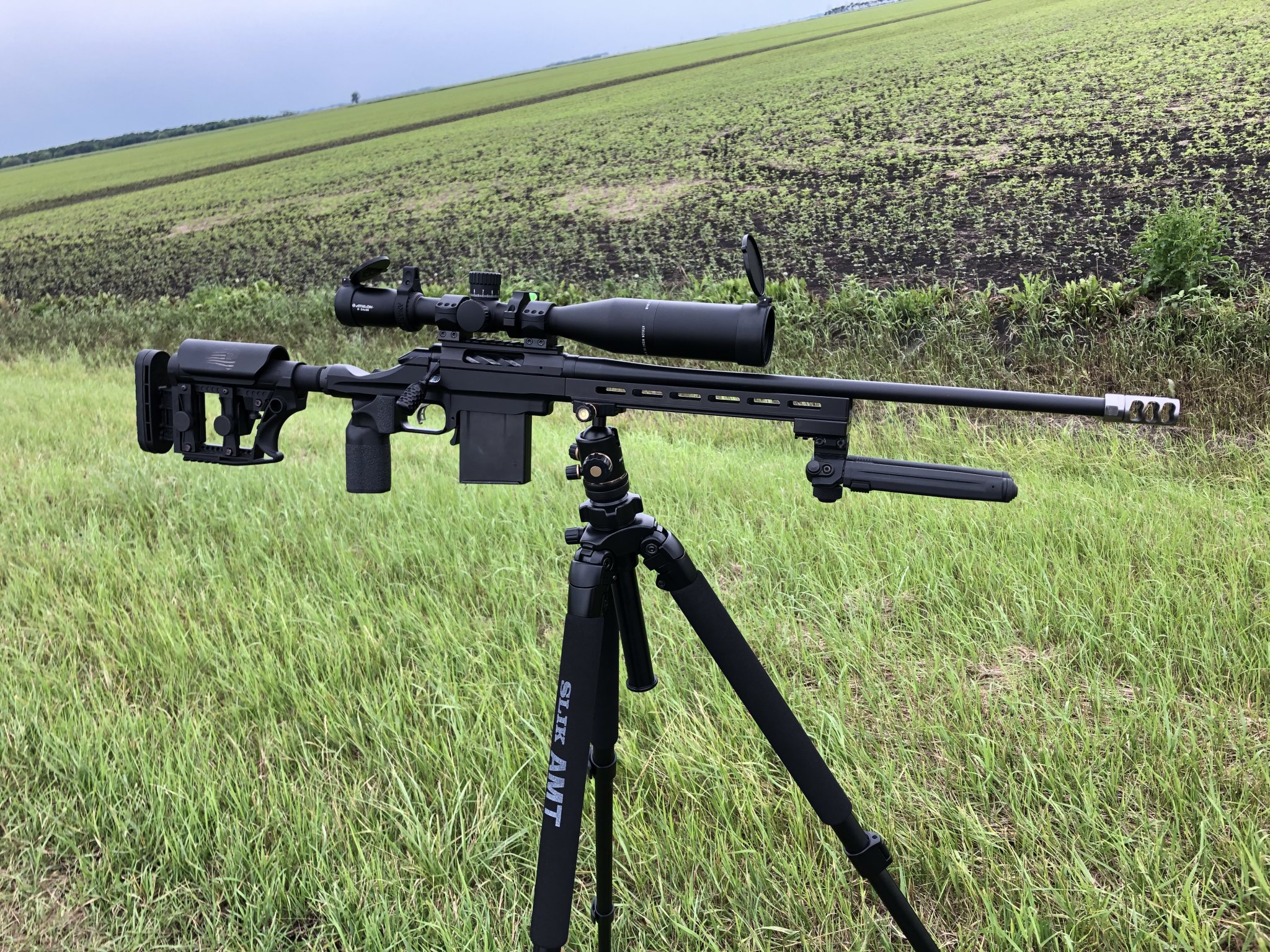

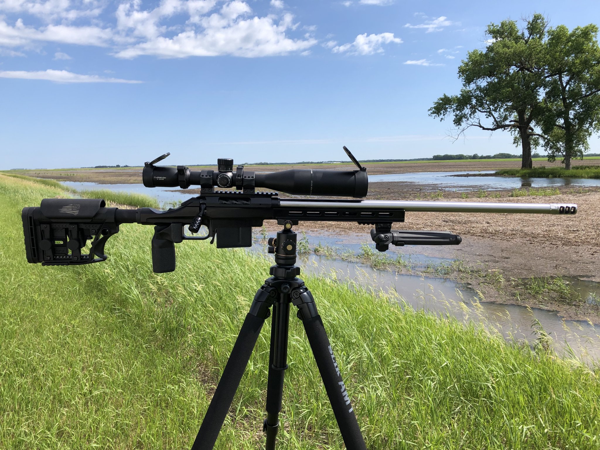

I personally like the Indian Creek Design MoFo chassis. You get more modularity for your money, the customer service is unbeatable, and it’s made by a small American business. It’s compatible with virtually any AR15 buttstock and hand grip, and there are currently 4 differ interchangeable fore ends offered, one of which is an adapter to utilize AR15 Handguards. Only ONE foreend comes with your purchase, you can purchase other Handguards separately if you like. I personally run the Johnny fore end on both of mine. Full length integrated ARCA rail on the bottom, and well as m-lok slots running the full length of the fore end on all sides
There are a few companies offering aftermarket barrels. After I burned out my factory barrel I put on a 26” Heavy Palma contour from Patriot Valley Arms and when I can do my part of the work it’s 1/4” at 100 yards, stressing when I do my part. A rifle system can only be as good as the nut pulling the trigger

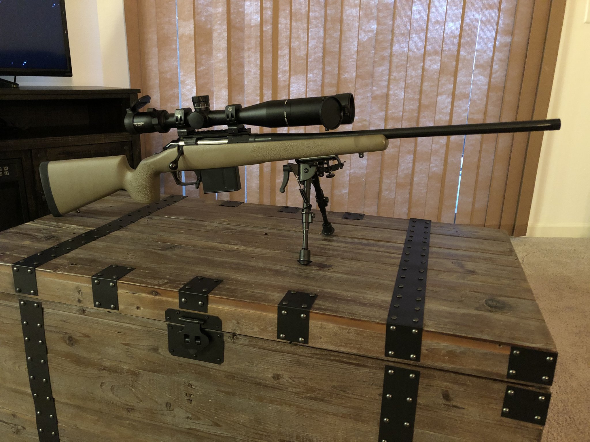

Not a Stockys but here’s my RAP I’m turning into a custom 22 Creedmoor for coyote hunting in the McMillan Game Warden stock, it comes with a SOL M5 DBM already installed.
