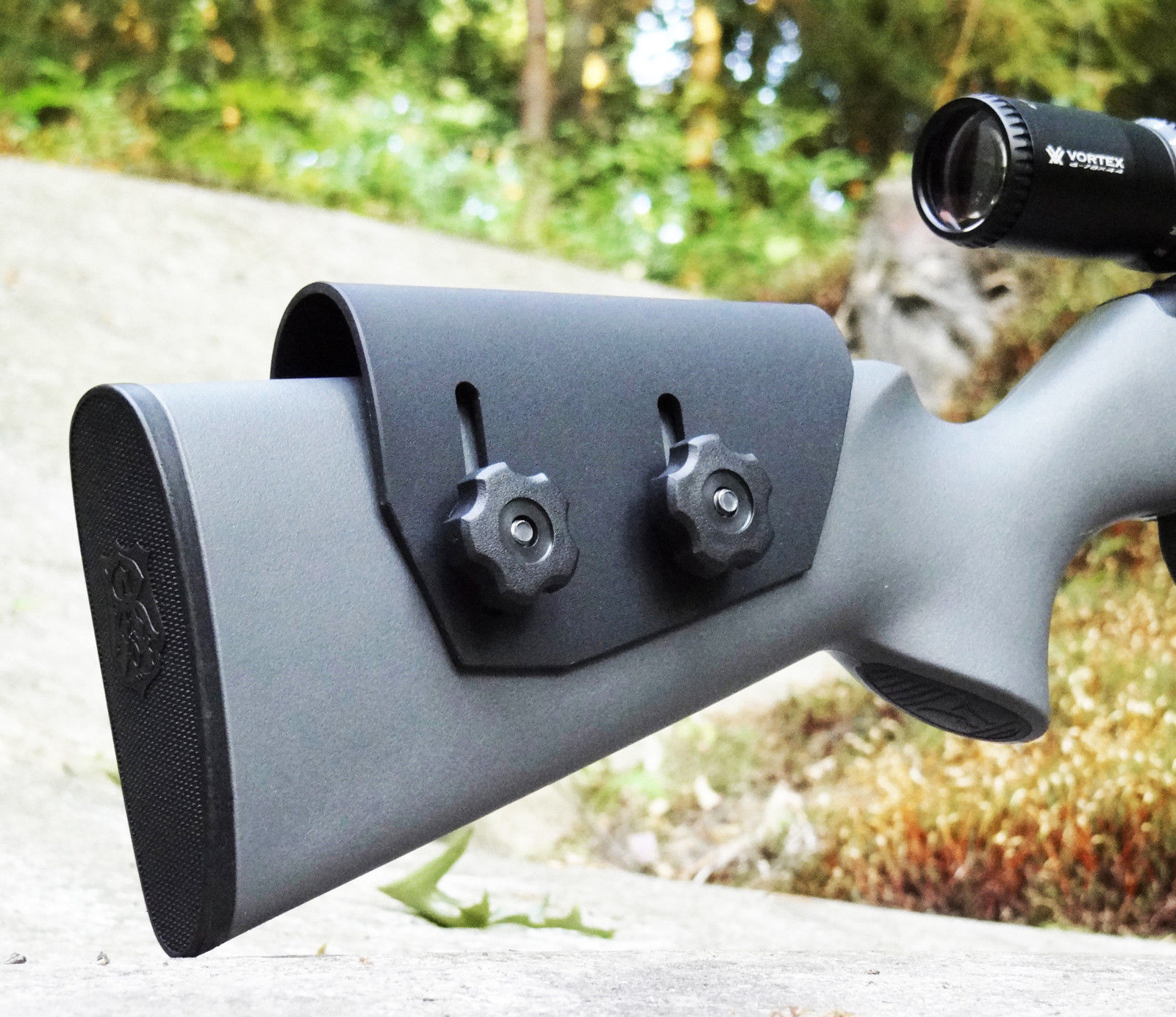

You could always get a boyds stock for it, chassis will all push you to aics mags which sounds like a downgrade for you.
It also sounds like your main problem is that your scope needs to be moved forward. Either it needs more eye relief than the scope on your CZ or its mounted further back. You probably also need a cheek riser but if the LOP works on your CZ then start looking at adjusting your scope forward.
+1 on the Boyd’s. I have the Ruger in .300 BO and the Boyd’s stock for AR mags was a huge improvement over the OEM stock and not nearly as expensive as a chassis

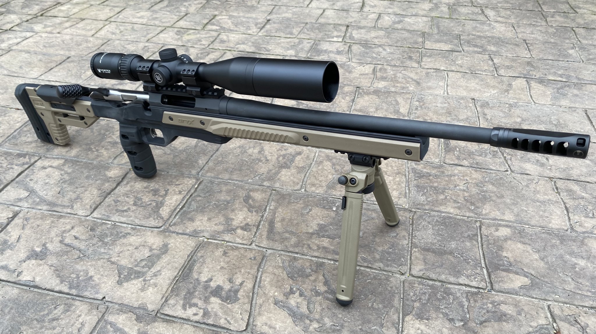

I just finished up my Ruger American Ranch 223/5.56 build last week. I am currently waiting on a magazine from Accurate-mag with the extended feed lips. I have done a lot of research before i decided to put the time and money into the build. Weather permitting and my work schedule, i am hoping to take it out to the range, and shoot it in this weekend.
Build List for the rifle:
~ MDT Oryx chassis
~ MDT Vertical Grip
~ Vortex Diamondback 4-16x42mm
~ Timney 1-3 lb. Trigger
~ Magpul Bipod
~ Ultradyne muzzle compensator
~ Anarchy Outdoors Threaded Bolt Handle
~ Anarchy Outdoors Dragon Scale Oversized Bolt Handle
~ 223 Accurate Mag (with extended feed lips)

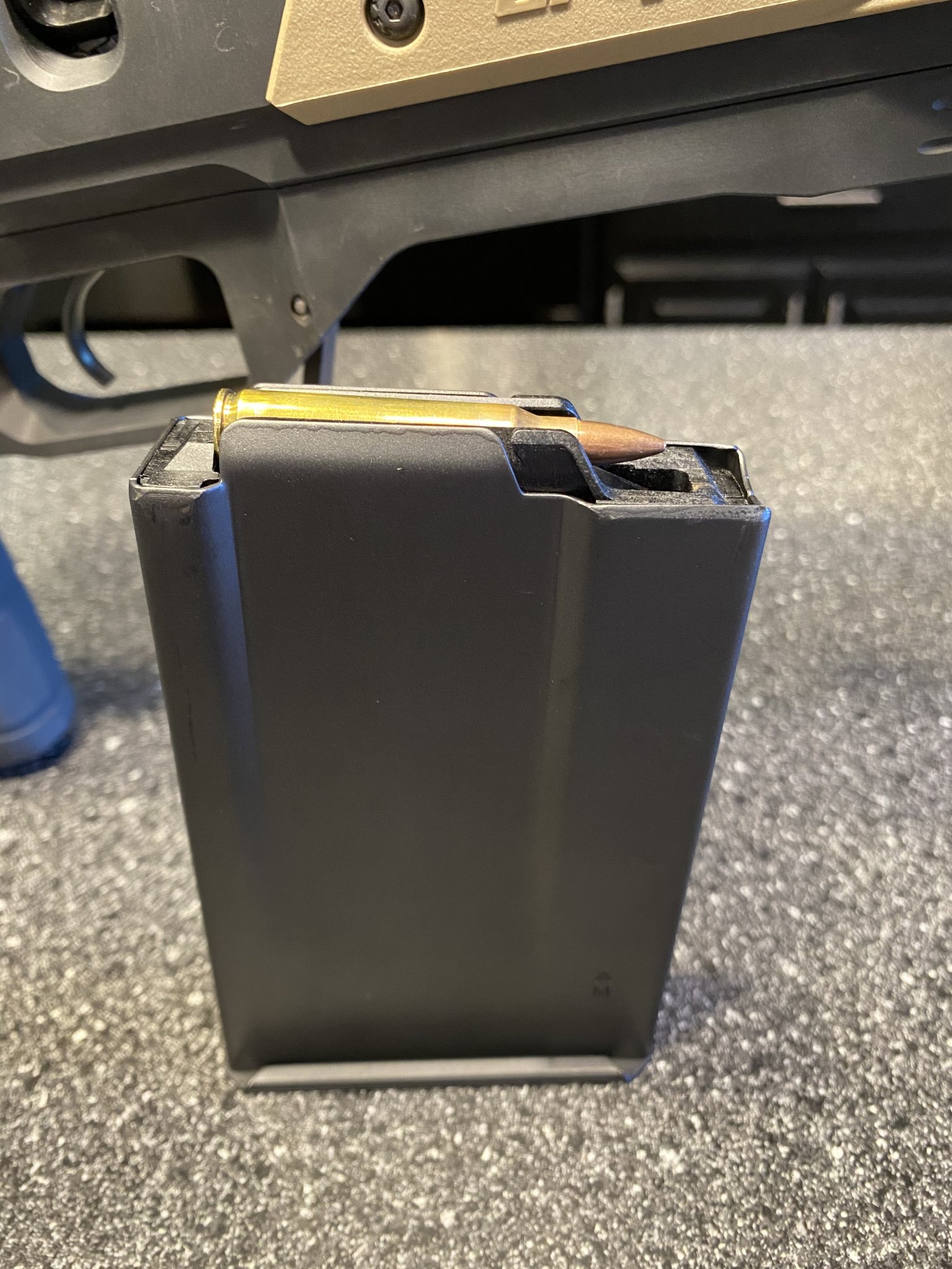

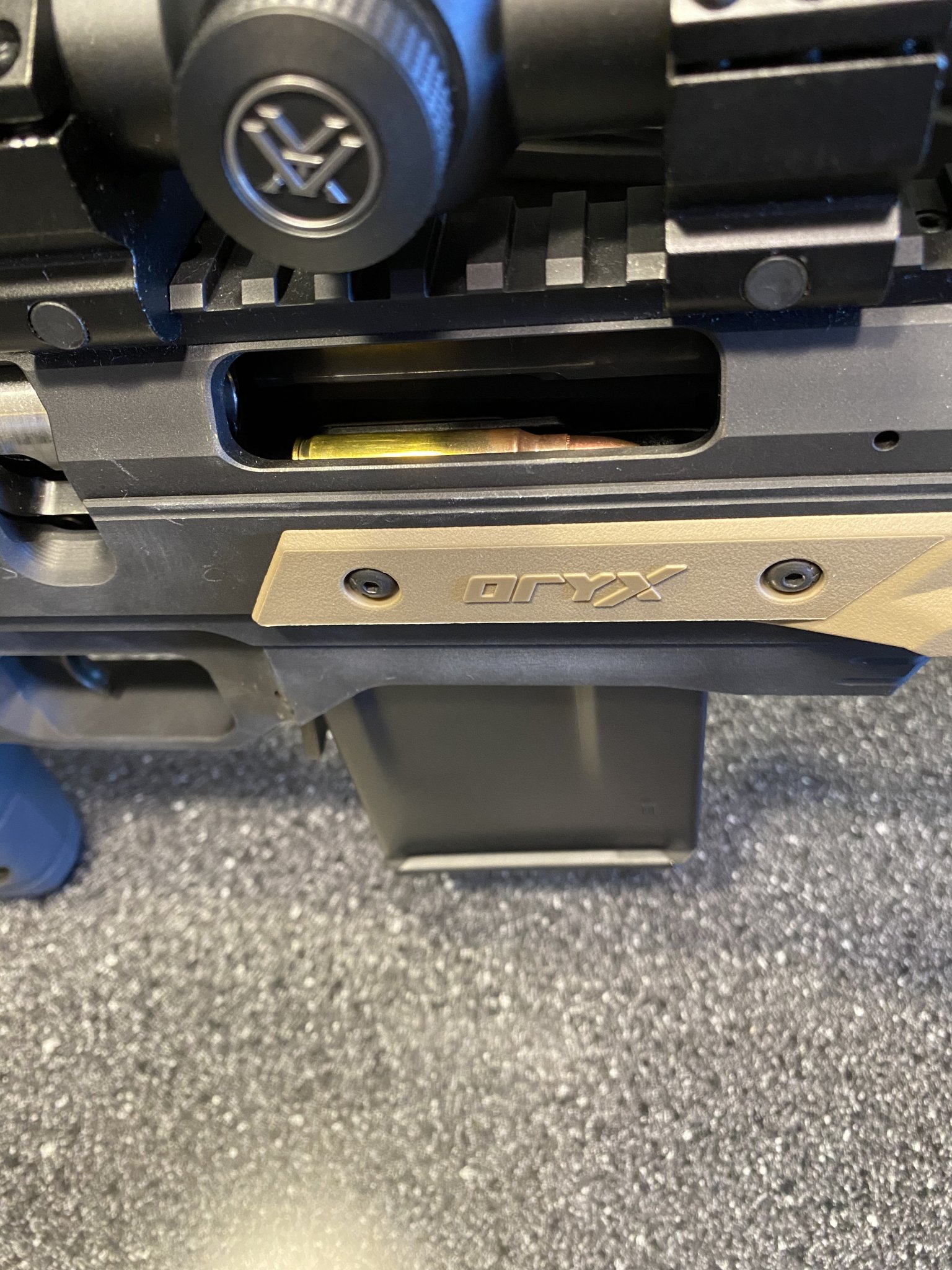

Well i was able to get to the range this morning. I am throughly impressed with this setup including the magazine with extended feed lips from accurate mag. I had no issue with feeding from the magazine. I shot about 50 rounds with the rifle. I am so glad i dumped the factory stock and went with the oryx chassis now. Thank you to everyone on the forum regarding the magazine issue with the RAR, and solutions to look into when searching for a magazine for it!!!!!

So do you have the part numbers on the mags? I would like to ask accurate if they think it would work with my setup.
I spoke with Mark at Accurate Mag, and I explained the issue with the RAR magazine issue. He was aware of the issue, and said that i would need the “lengthy 223 magazine.” There was no part number listed on the invoice that I received from them other than “lengthy 223 magazine.” He said he would personally pull the magazine, and ship it. The quality of the magazine was exceptional.
