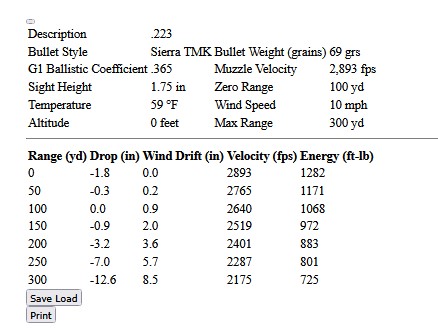

I was just curious , I have used the Barnes 62 grain and the 77 TMKs on deer . The swamp bucks I get are often over 200 pounds and shots can be 300 yards , just trying to convince myself I won't be handicapped with the .223 at that distance .
You just need to run the numbers.
This is a 69 TMK I loaded. I think 300 yards is pushing it on energy. I would keep it at 200 yards.
