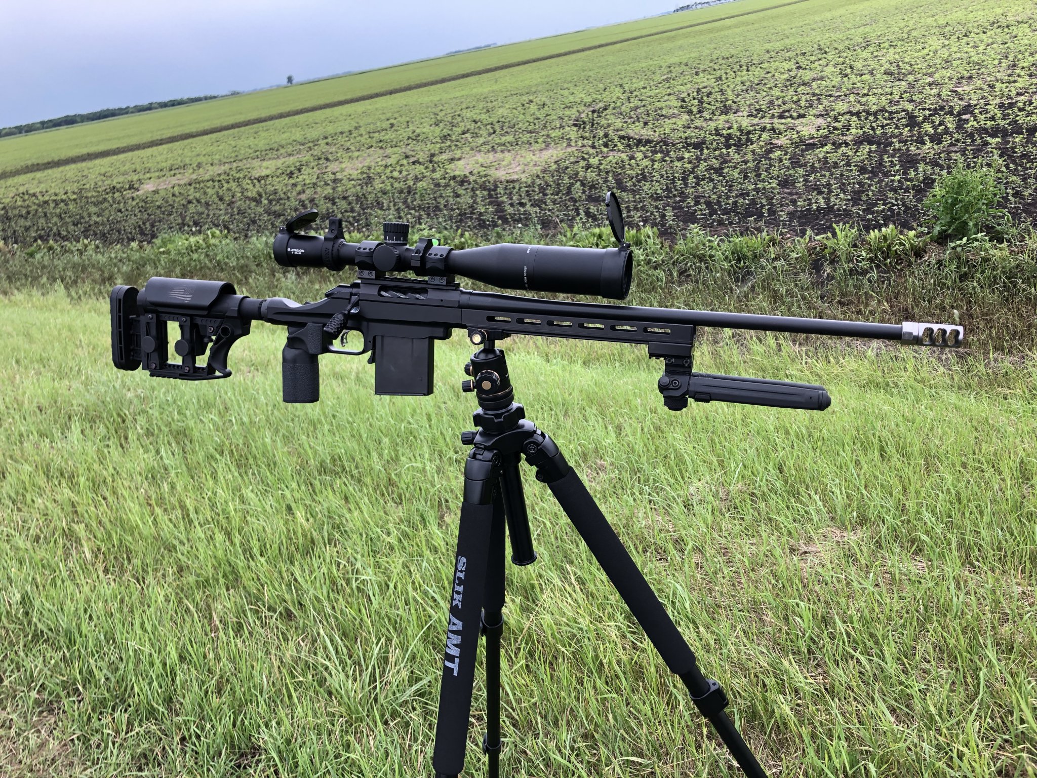

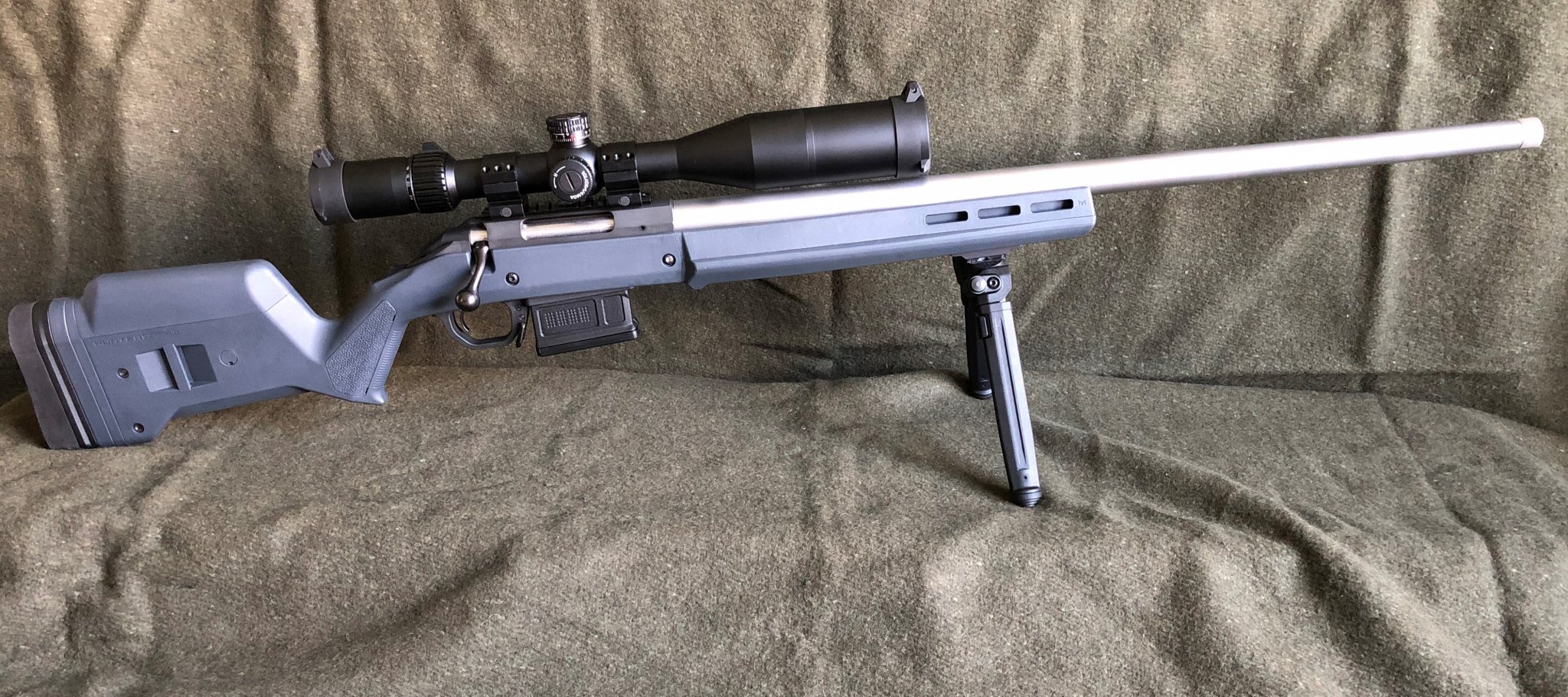

Trued the receiver and bolt due to a burr on one of the bolt lugs from the factory, I never thought to inspect the bolt before installing it for the first time. This left a gouge in the bolt lug and created a ramp of material on the receiver lugs of .004". If it wasn't for the burr the action and the bolt ran true in the lathe within .0002". To say the least I was impressed with the quality and tolerances from Ruger.
I went with a Bartlein M24/M40 contour, 1-7.5 rh twist and finished length of 26", and chambered it for 6mm Creedmoor. The Magpul stock says it will accommodate up to a medium palma contour, so I ended up milling about .125" from the last 8" of the barrel channel to fit the heavy contour.
Currently shooting factory Hornady 108 ELD match.
- Factory rail
-Vortex Tactical rings.
-Swampfox Patriot 6-24x50
-Mapul Bipod
