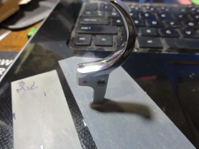

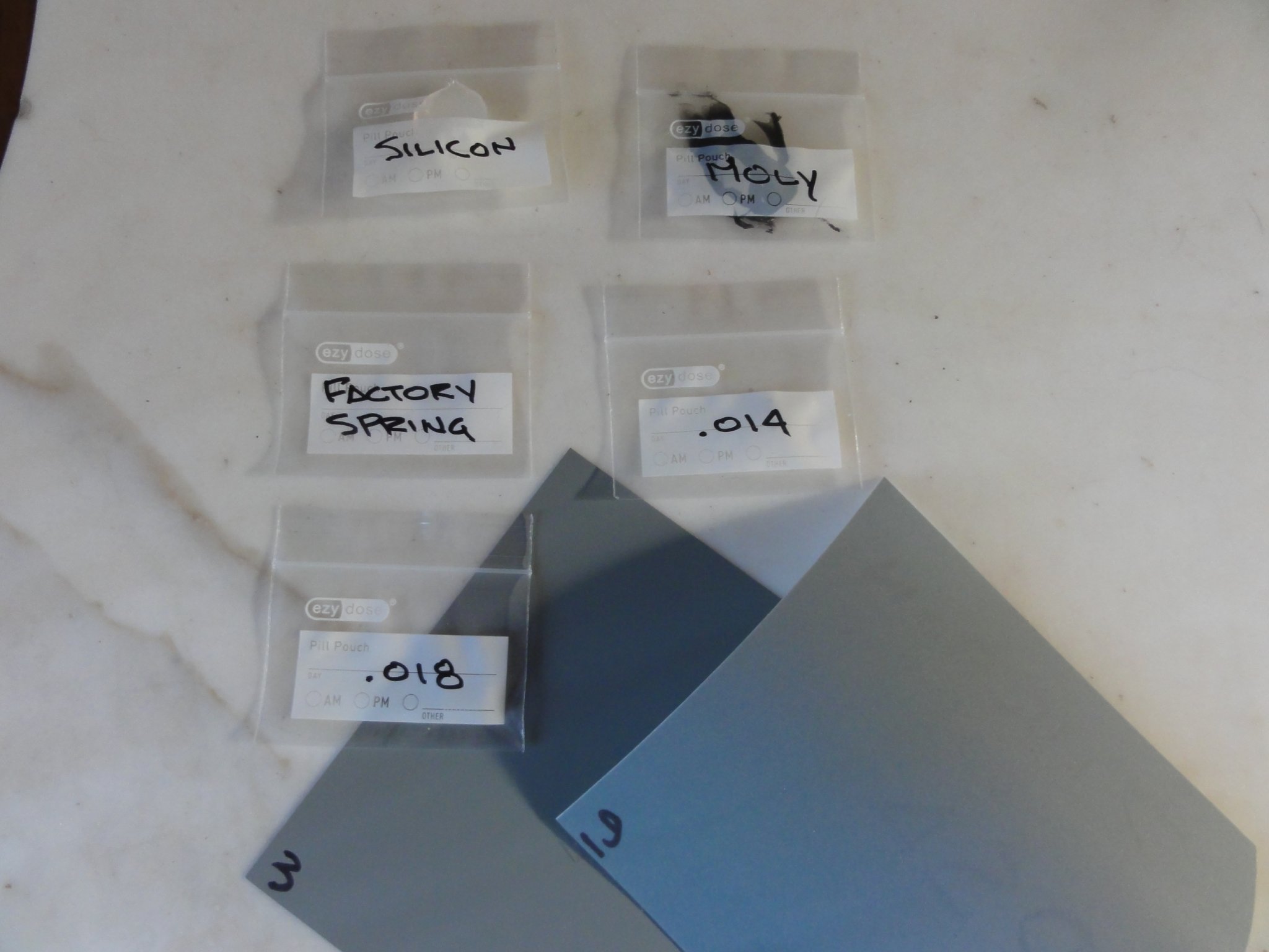

For this job I will also need my miniature blades as well. I can use a flat blade and stick some lapping film on it because it has a PSA backing. I will use the same type of film that I use to polish my 457 trigger sears. I suppose I had better start thinking of using my Dremel type tool as well just in case.

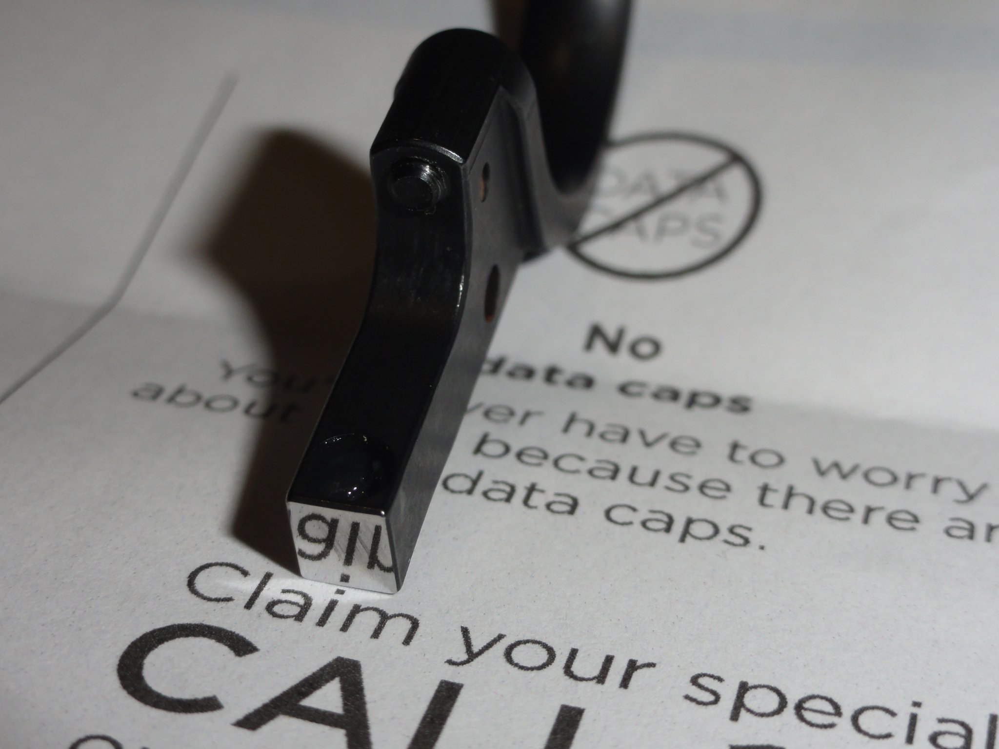

The trigger shown below has been lapped with 9 micron and then 3 micron Aluminum Oxide film with a pressure sensitive adhesive ( PSA ) backing.
