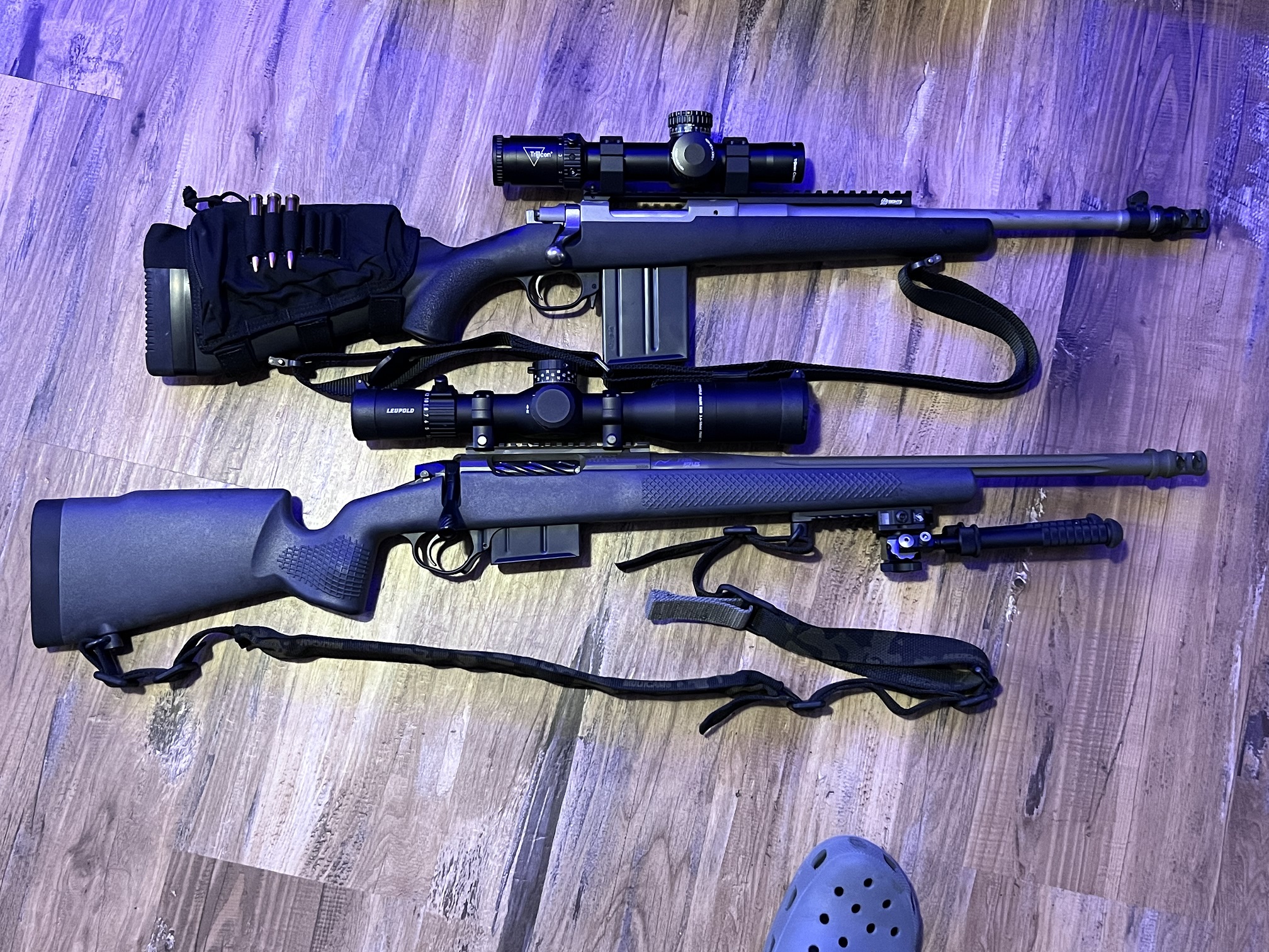

Man, I love my GSR. It's sub moa accurate with factory ammo, and pretty dang impressive with my 155TMK handloads. I ordered an Accurate Mag chassis for it today, and Im pretty dang excited to set that up. I have an XS rail on mine and a Trijicon Credo HX 1-8 scope on it. It's fast and accurate. Recol is pretty much non existent with that 155 load as well, and it stays supersonic past a grand. Those are my two favorite rifles to shoot and carry. They're two that I'll damn sure never get rid of.
