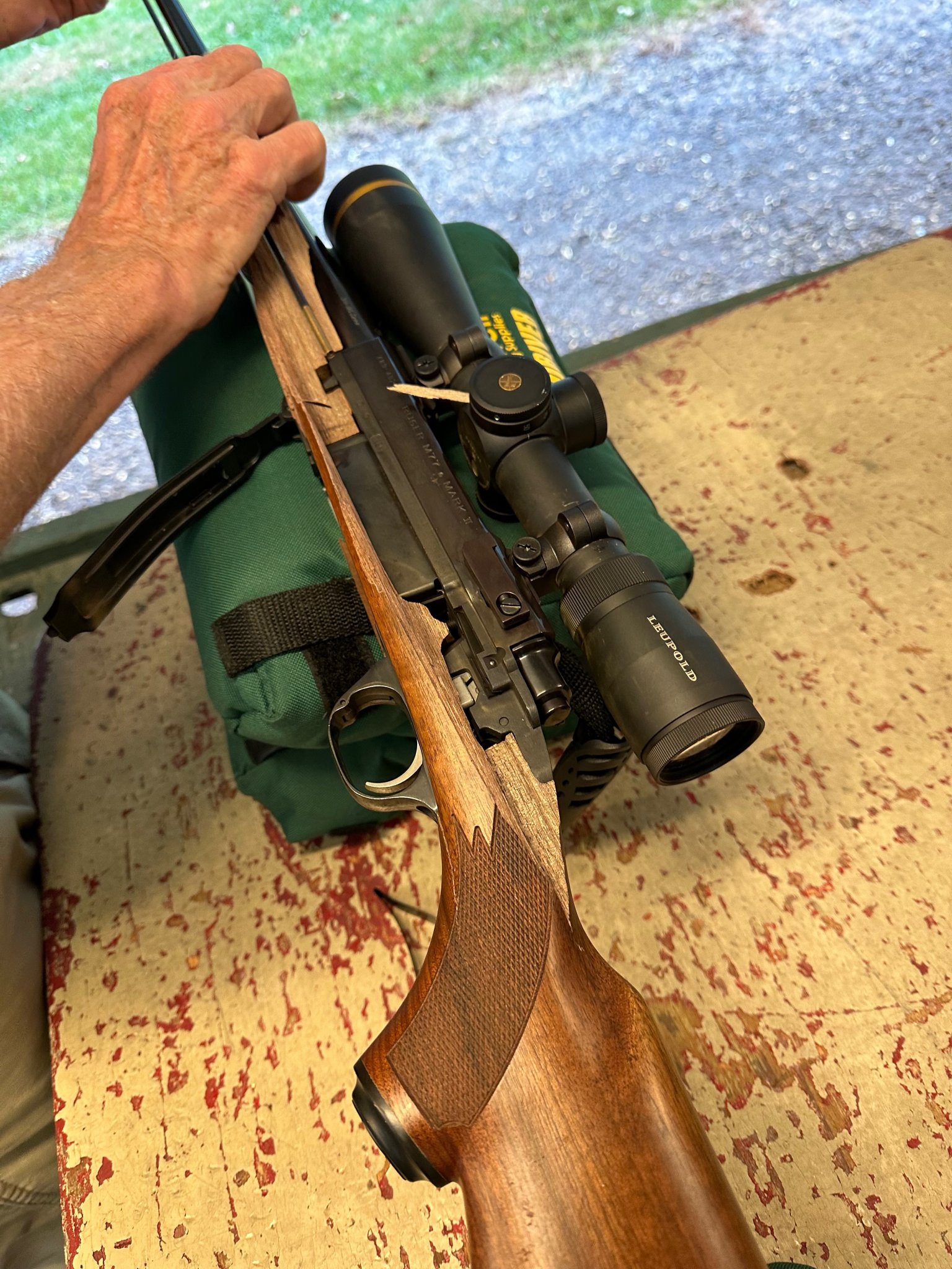

I saw a crazy red flash in my face and the rifle stock exploded all over the place. My worst nightmare as a reloader.
I escaped with some small cuts on my face and trigger hand, and of course some shock.
The RO and others at my club came over to help inspect and assess the situation. A gave up a couple of my loads for them to examine, captured it as a "range incident" and I was on my way.

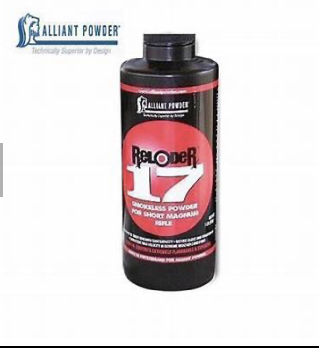

I went to my bench and pulled out the jug of RL17 I had used....to see that it was RL7, not 17. I've never intentionally ordered any 7, as I've not had any use for it. I did however order 3 jugs of 17 many years ago to stockpile for my 6.5cm that seemed to really like it. Apparently I received 2 of the 17 and one of the 7 and just never noticed it.
I had always remembered to keep the powder jug used for a given load, adjacent my chargemaster to ensure I knew what was being loaded at all times - standard best practice. Yet I stupidly assumed the only Reloader powder I owned was the 17 and didn't even notice the missing "1" from the front of the jug. Lesson learned. Now to see if the destruction is limited to the bottom metal and stock. Ruger will have to open the action for me as the bolt is jammed in place. I'm fearful the entire receiver could be damaged enough for this to be a total write-off attributed to sloppy reloading. I'm crossing my fingers Ruger has a decent proposal for to salvage it.

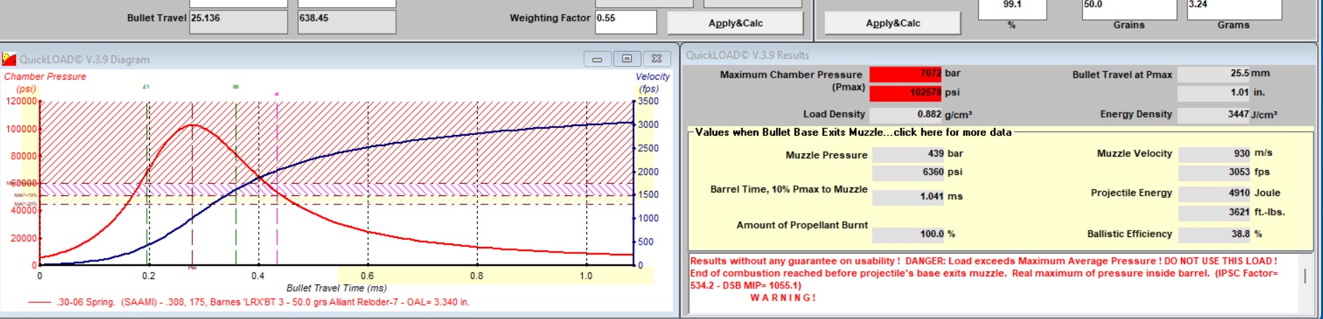

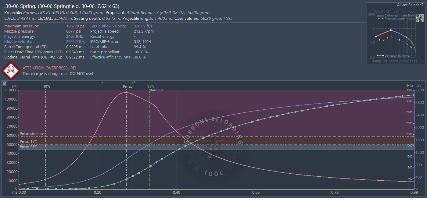

What was the load, I will dial it up on quick load and see just how close you came to meeting Jesus.
It was 50gr (of RL 7) w/ Barnes 175gr LRX (Lapua brass, federal 205)

This is a problem I have with most powder packaging. It all looks too similar and it's too easy to mix up. Not too difficult to put a color-coded label based on relative speed or intended use. I've never mixed up powder, but I can certainly see how it could happen. So many of the Alliant powders are the worst - they all have nice big numbers, but they're all red and look too similar.

106,000PSI...wowzers.
Send it back to ruger as you said, I bet they spin the barrel off relieving tension from the brass and it works again, probably they will do one of those crack tests on it but the metal bits still look good externally.

They used to have a better way of ID on them bottles. They had a different color circle backgound for each powder. RL-7 had yellow and RL-17 had Red
Yep! I got off the phone with Ruger today and their customer service (first time I've ever had to call them) lives up to the positive experiences my friends have described. They sent me a Fedex label and I'll send it to their factory today where a guy who's been inspecting rifles for 30 years will do an evaluation and they'll repair it or provide an alternative solution - possibly a discounted Hawkeye (which is basically a "Mark 3"). I'd love to be able to rebuild the same rifle though, at least there'd be a story to it!

I know Ruger has touted themselves being the leader in the investment casting technology sector for many decades. Your loading mistake has proven their investment castings can take the pressures. Your Rifle is an older Rifle.
I'd bet that 50 grains of Re-7 would have blown up other receivers.
I hope Ruger can get your Rifle back up & running. We need photos & range report if they do.
Well give Ruger a Pat On The Back. From what I could see in the picture; 106,000 PSI and the receiver / bolt / barrel appeared to hold. Says a lot for Ruger’s metallurgy, construction and Peter Mauser’s design.

Ok....update: Ruger got back to me the other day, the rifle is toast and unrepairable. They offered me a discounted Hawkeye (which as many of you probably know, is essentially a M77 "Mark 3," so I'm out the original but I'll be stepping into a newer rifle for what I assume is roughly wholesale (800) and it'll have a better trigger and a few other nice upgrades. I didn't really "need" to replace it, as I have many rifles, but I was really set on having a modern controlled round feed, which I lacked before I added the now blown up M77 to the safe.
Also worth noting, and an accidental omission from the original story. I realized after the fact that I had shot the same 106k psi pressure load through my Heym SR30 a few weeks before and the gun didn't blow up, but just had a very sticky bolt, which is why I had the rounds still lingering in my ammo box. I've since shot many normal pressure rounds through it and it works great. So if anyone wonders about the strength of that really interesting ball bearing lockup-straight pull bolt design.....now you know!
When a firearm is subjected to a pressure beyond the proof load pressure they are not going to do anything in terms of repair or approval for use. I doubt that once in their possession they will return it. The liability is just too great.
I agree. Its one thing I like about the Hodgdon, Win, and IMR labels; they still use a unique color for a particular powder. Accurate and Alliant powder used to have different colors also, but they have both gone to a single color style that isnt as good in my opinion. I was hoping Hodgdon would change the Accurate and Western labels to have individual colors again.
