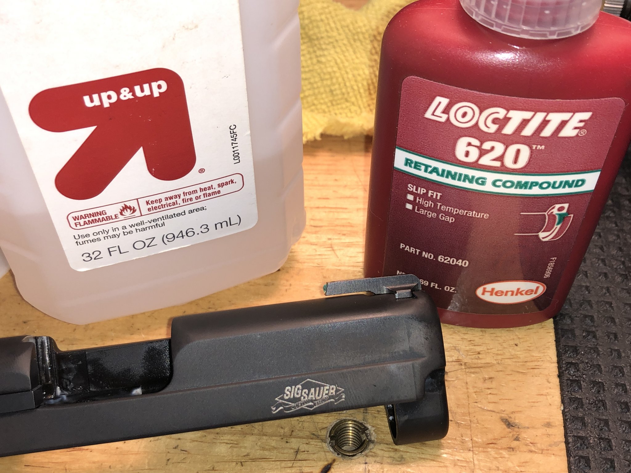

620 Loctite. Done.
This what Ruger should have done. Nylok strip that's installed in a machined groove in the fastener. Many torque cycles before it wears out. Unfortunately, the minimum order is quite a lot for an aftermarket venture.
