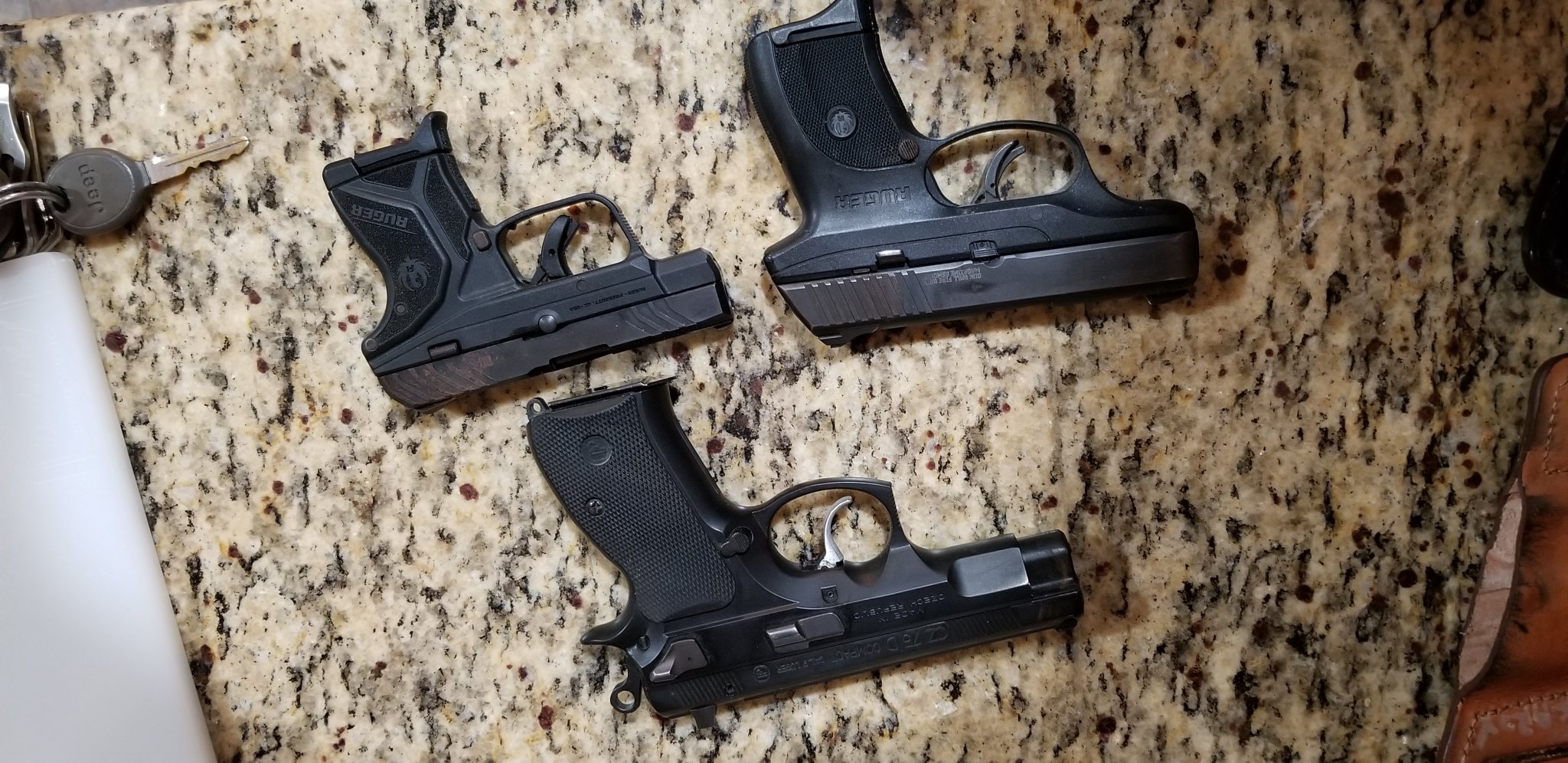

I carried my LCP for 1 week on vacation and oiled it before the trip. The slide is heavily rusted and pitted. My LC9s which I carry infrequently is also rusted after about a month. My CZ75 which I have carried for the last few years is not rusted, even the rivets on my jeans only left brass marks on the finish. Emailed Ruger and let's see what they say. Just trying to let people know how easily they rust so you cab prevent the rust on yours.

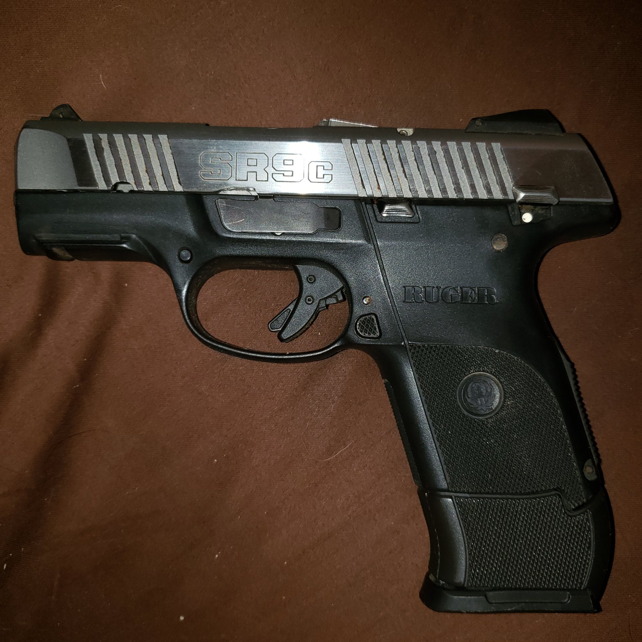

Here are pics of my 6 year old SR9C that is an everyday, all day carry. Not a speck of rust anywhere and doesn't see much oil on the outside.

Before people start asduming stuff... I am a coatings chemist with 30 years experience inventing corrosion resistant coatings. I have multiple platents and have published dozens of articles on coatings. I fully understand coatings and corrosion. I also have been carrying (same holsters, same body) for 20 plus years. I have carried blued, nitrited, stainless, coated...pistols. I maintain my guns well when carrying that was driven into me from 15 years Canadian Infantry. I can show you a blued Browning HP I carried for my first 5 years with my concealed permit. In 30+ years of owning and carrying pistols, I have never seen any rust do quickly. This tells me there are flaws in their coatings process.

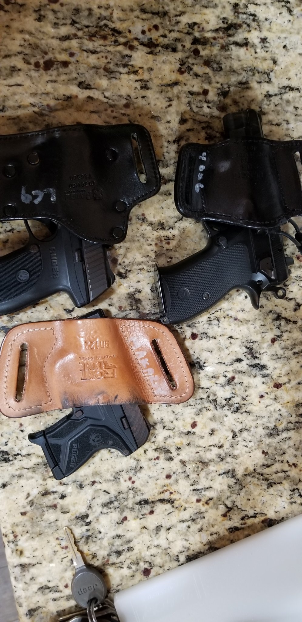

The leather holster is not the issue, I oil the body side of the holster, and from the pictures you can see the rust stop where the holster starts. The rusted areas are where it touched skin. For it to have rusted this quickly, it means the barrier coating had flaws that let moisture through. These small holes called holidays show the coating was either applied too thin, or not evenly.

If the leather of the holster is not vegitable tanned, it has the potential to rust steel, regardless of whether you oil the inside of if or not. This is one reason why antique knives are stored separately from (not in) their leather sheaths in museum collections (even when not on display).
Always look for veg tanned leather if it is to be carrying around steel...
