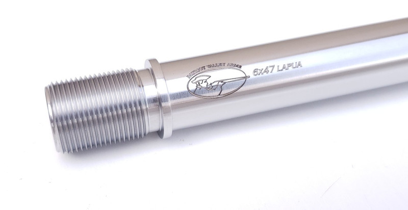

    Patriot Valley Arms can do it, just find out how long will it be?
