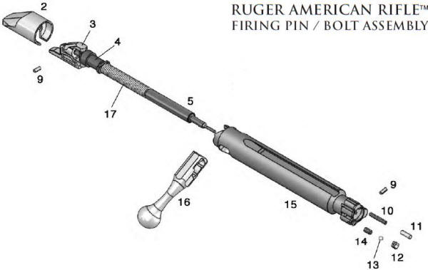

RPR and Ruger American are similar, maybe this will help.View attachment 7018417
I didn't try applying heat,I gave up on it for the night.
This diagram was helpful it's basically the same bolt.
Unfortunately I lost the detent ball for the extractor [#13]
Part #11 the ejection plunger is stuck inside the bolt.
