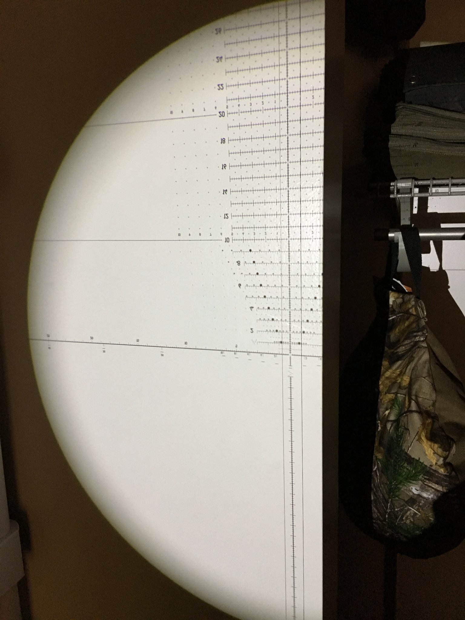

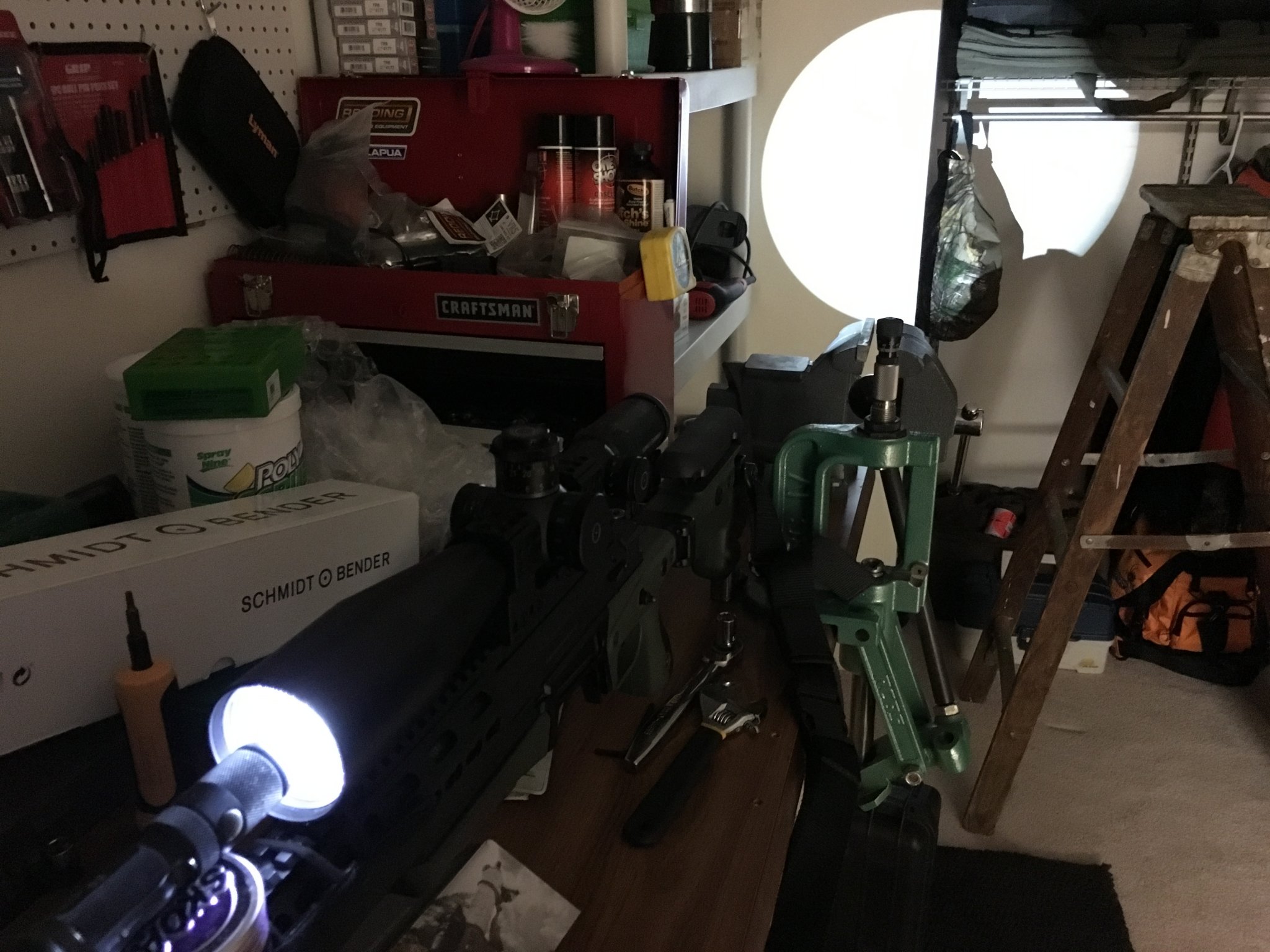

My preference is a plumb line, a flashlight, and a fixed, rigid level permanently on the tube. That way you know, no matter the errors between the gun and scope, that your reticle and adjustments are level to the world.
