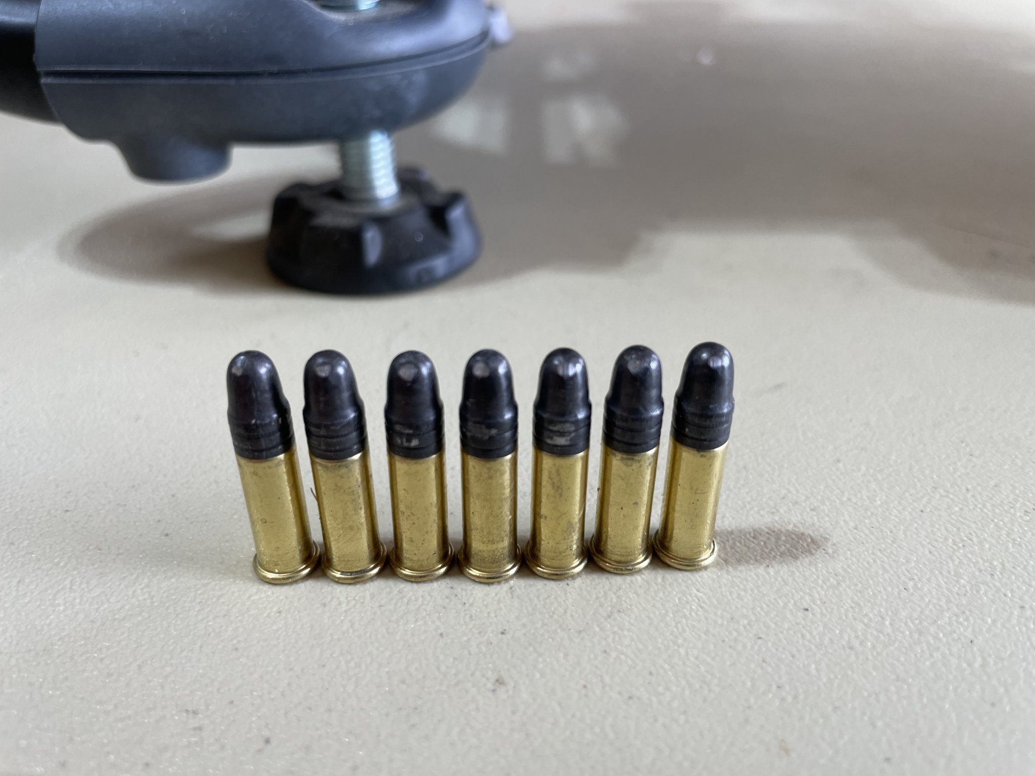

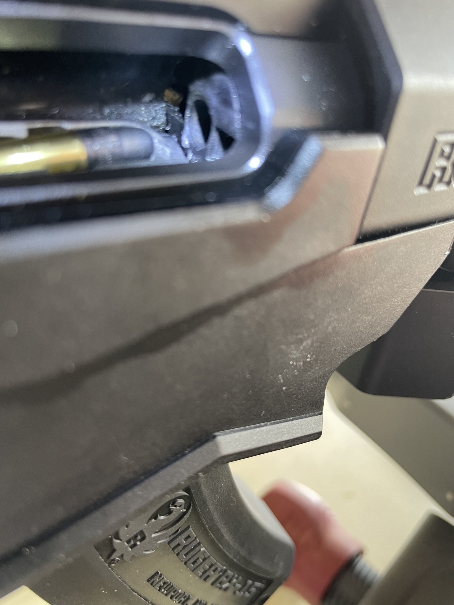

Hi all,
Has anyone had this happen? Does anyone know how to fix this or does it need to be fixed? When feeding a round I noticed that the bullet tip is scraping the lower left edge of the chamber. Not by much as you can see by the pictures. The rifle seems to shoot pretty well at least out to 100 yards but I wonder how much better it would be without this happening.

On your bullet scraping, does it do this with all your magazines, or just this one? I doubt there is anything wrong on the rifles end, it is a magazine fitment issue. All Ruger mags are not created equal, you see this in 10rdr's, and the 15 & 25rdr's are not quite the same dimensions as the 10rd.
Try a couple 10rd mags, if possible, I've never been around the RPR version to know if possible.
Not a fair comparison, but with any 10/22 or variant, if you sort through mags, life at the range gets easier, in terms of feeding, accuracy, etc.... I used to sand on one side of mags to get them to feed correctly, works until that mag gets mixed in with another batch of mags, with the wife and kids, going to happen.
Today I just leave crappy mags on a bench at the range.

So I checked things out again last night. It is with all the mags. If I put a slight amount of forward pressure to the lower portion of the magazine it fixes the issue (changes the mag angle by a fraction). Going to try the Kidd magazine plunger with heavy spring to see if this will fix it. If not I will try shimming the mags and report back!
Thanks for the responses!
I received and installed the Kidd magazine plunger with heavier spring. It appears to have fixed the problem! I will still polish the magazine feed ramps and the bolt to clean things up. Thanks for the responses!

Definitely a common issue with the ruger magazines in a number of different guns, including many of the 10/22 clones. From my experience the ruger precision has a lot of variability in quality control. I know one guy that has one that is a fully reliable hammer right out of the box. On the other hand several fellow shooters had issues, with trips back to the factory ( in one case more than once) without satisfactory resolution.
