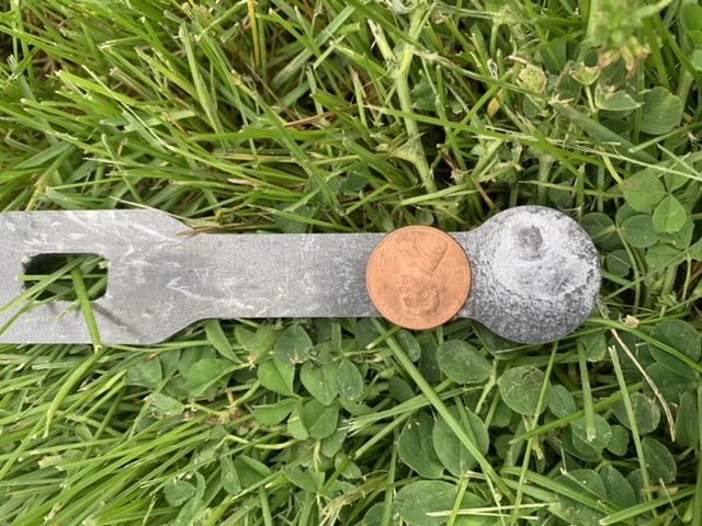

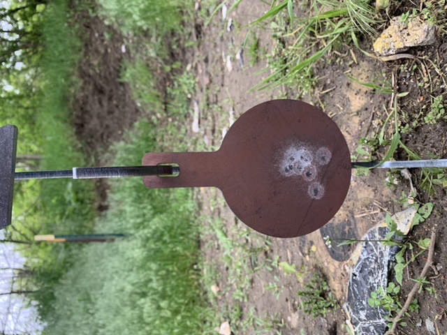

    I had my Ruger with its 20” Shaw barrel out today. I just had a medical procedure last week, so had to shoot off a bench with bipod and rear bag. Using CCI standard I shot the following 10 shot groups at 50yds and 100yds. The two low hits at 100 were all me. This is just to provide additional data on the Shaw barrel, if you would like it removed just let me know.
