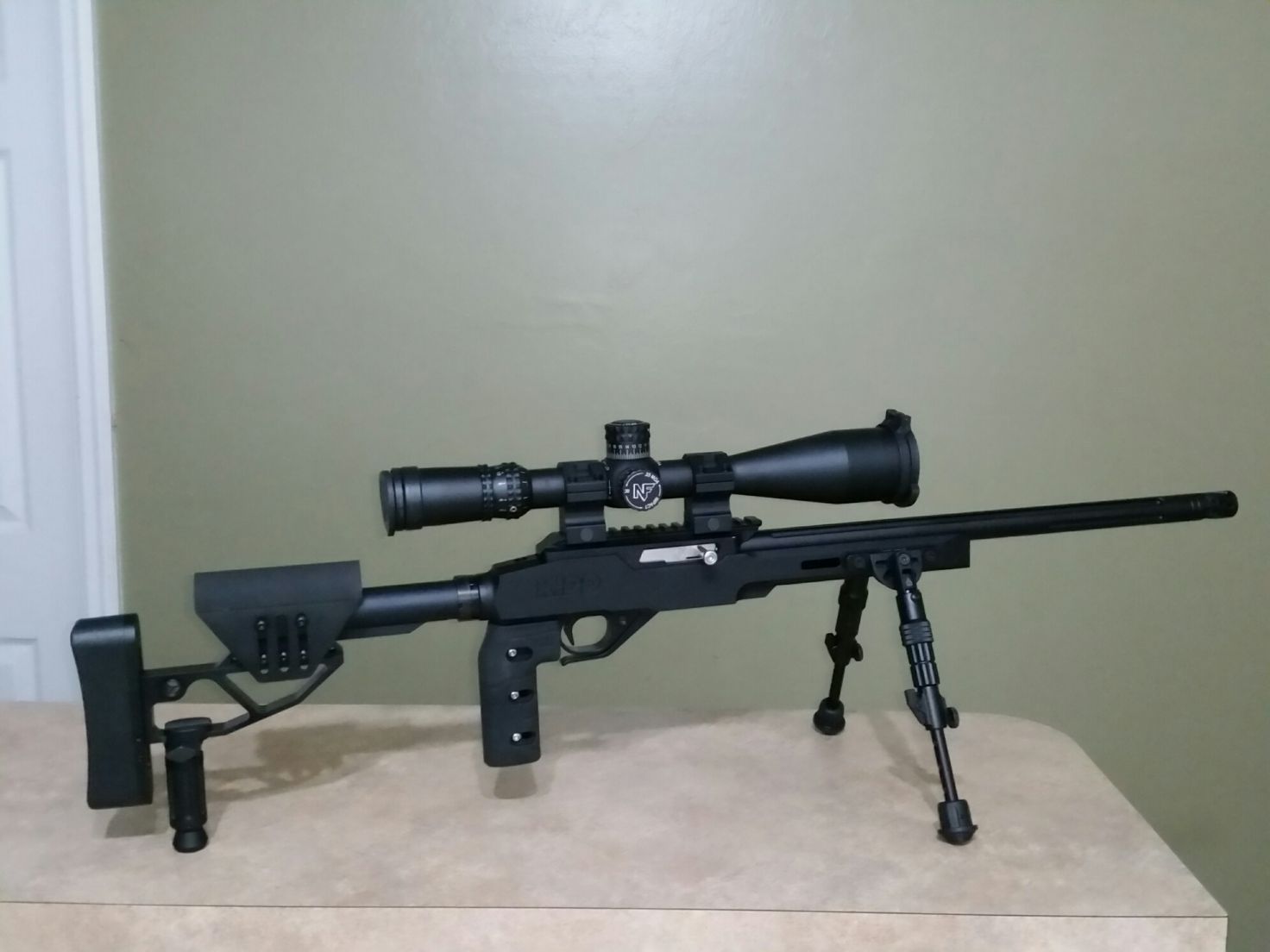

Go with the Kidd. I have three Kidd receivers. Two of the rifles also have Kidd barrels. The one I shoot the most has a Kidd tapered barrel. It’s my CMP Rimfire Sporter rifle. Love the Kidd builds and worth the money.

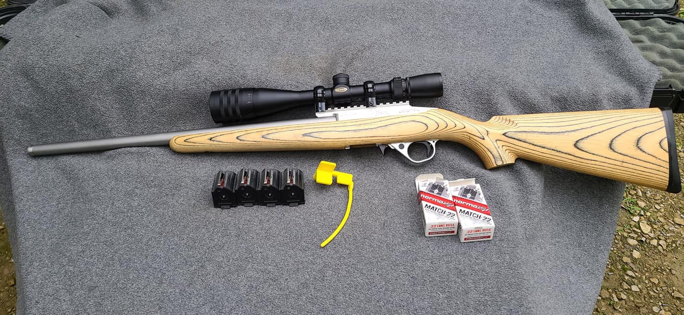

I have an older Ruger carbine. The receiver cant is so bad I leave it as is- factory stock, barrel, barrel band, etc. If I use the receiver in any other stock- like Hogue, Magpul, or Victor- I have to deal with the barrel contacting the stock. With Kidd, there is no cant and no issues.
