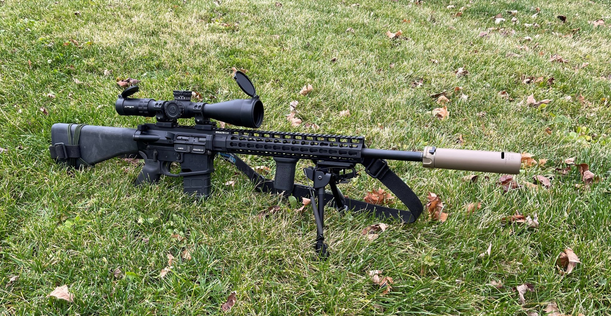

    I use the Primary Arms GLx 4-16x50. It has the ACSSHUD DMR .308 reticule, and is visible at the lower end of the power spectrum.
    The aiming point, a horseshoe shaped "donut of death" illuminates, so that helps.
    Being a PA makes it affordable ($800) and I've not been disappointed by the quality of the glass.
    I must ask, how do you shoot that rig with the scope mounted so far back? Typically the ocular is in line, or a hair forward of the charging handle. I remember touching my nose to charging handle shooting irons on M16A2.
    Reactions: simonp
    Just seems to work for me. I will say that I have adjusted my shooting style over the years. When I first went in (M16-A1) we shot more of a Weaver stance style with the rifle across the body. (nose almost touching as you said) I shoot this SPR more like a bolt gun, where I'm squared off behind it. My face ends up a lot closer to the ass end of the stock, so the scope needs to come back, especially with the A2 stock.
    Old photo by the way. the forward grip not there now, but a tripod rail.
    Reactions: FredHammer
