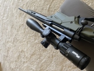

Howdy everyone. I recently purchased a new Savage Axis II Precision and a Sig Sauer Tango4 6-24 x 50 scope. I have two 30mm high scope rings from Warne. I tried a different ring assembly before this, and I when I went to zero the rifle I had to adjust my windage so much that I only had 1 mil L left. With my new rings I have the same problem. I’m assuming I either have a bad scope or something is wrong with the 20MOA rails on my savage. Any input is appreciated!!

Folks, thanks for all the replies! I took off the pic rail and found a ton of oil and some debris (from the factory). I re-torqued everything and the optic seems to be square now. I ended up buying some new Warne Maxima fixed scope rings and they work like a charm.
