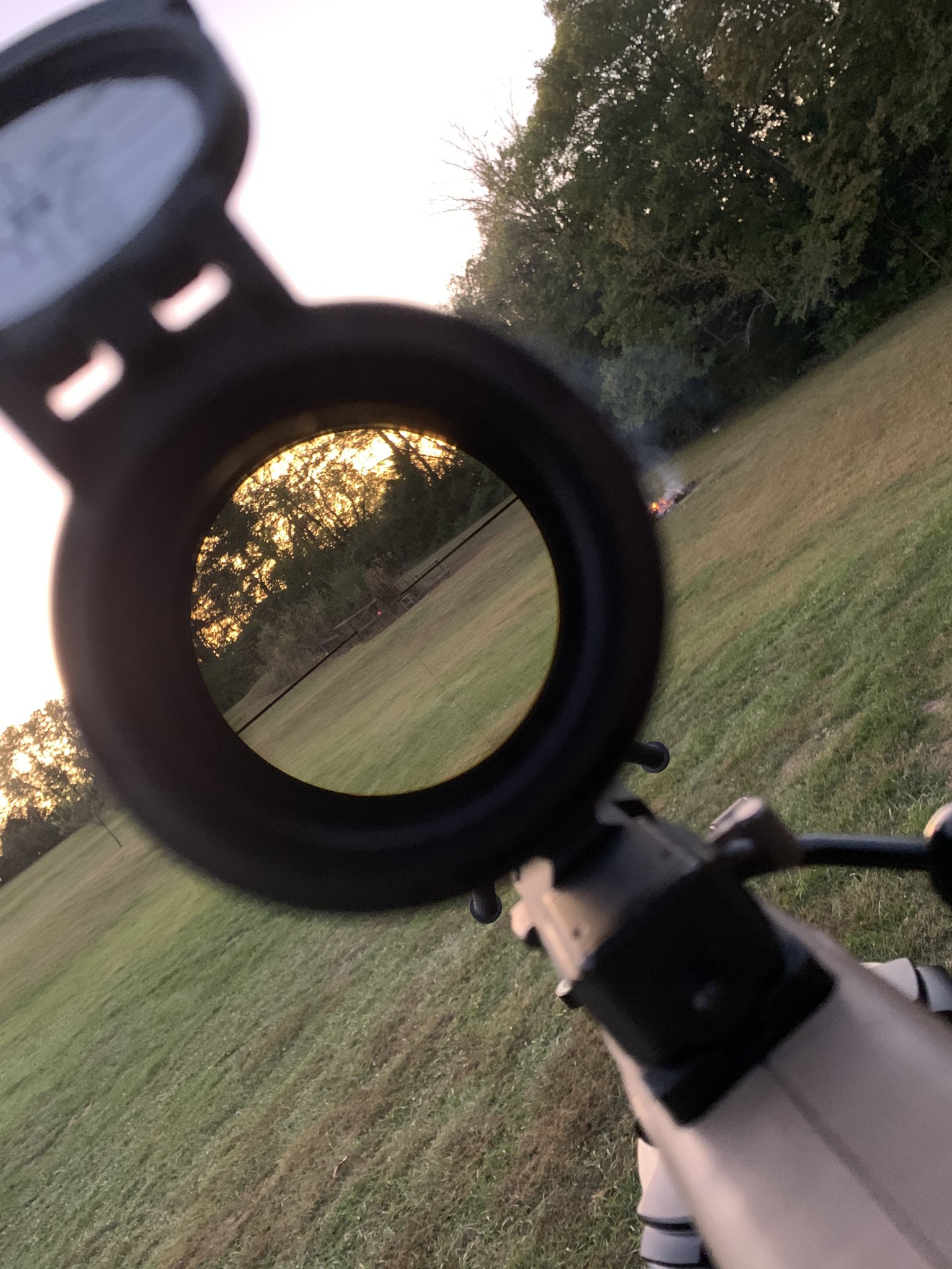

I’m not a sniper nor did I stay at a holiday inn express.....well ever. I do run a S&B 3-20 with MSR2. Its on the thin side but still usable at 3X
Pic is at dusk on 3X with illumination the berm is about 120yds. I wouldn’t have a problem taking a shot at game.
