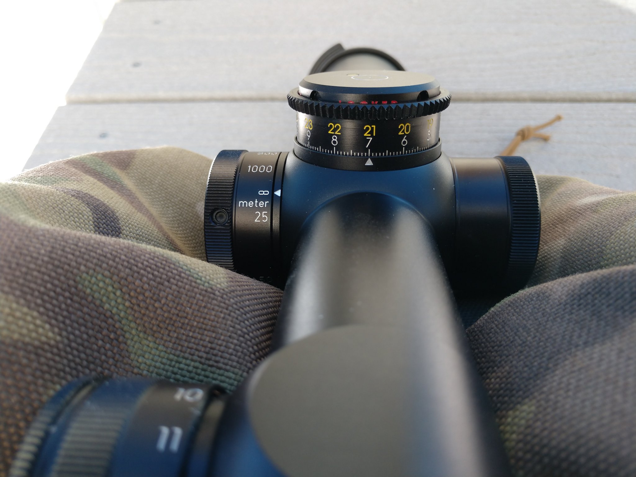

Here's a picture of my 3-20 Ultra Short with the 14-mil per turn turrets. For me it's hard to see the turret markings on the Ultra Shorts. Will be even worse with the 17-mil turret with my aging eyes.

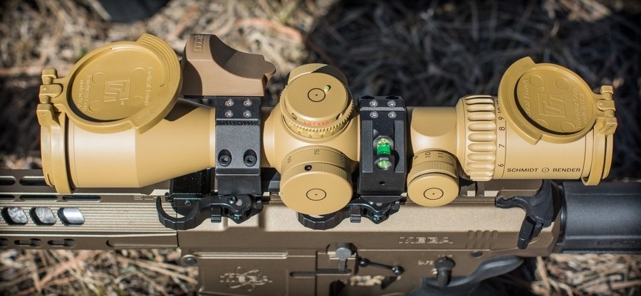

Here was mine with the ERA-TAC Ultra Short mount with Doctor optic adapter plate
