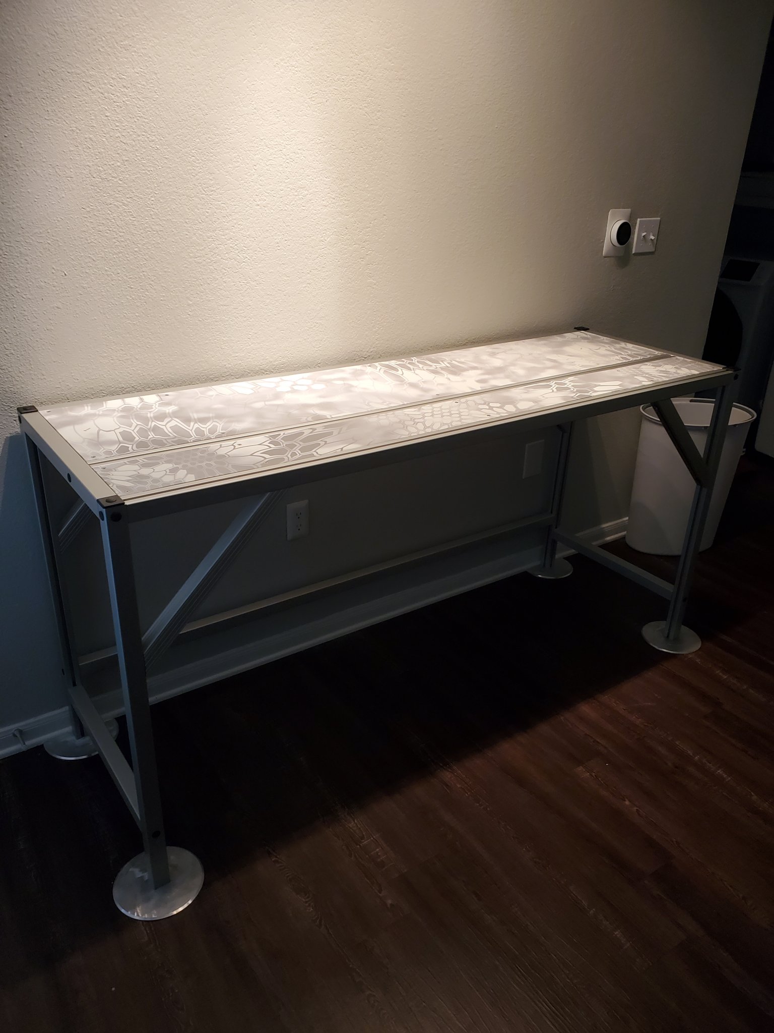

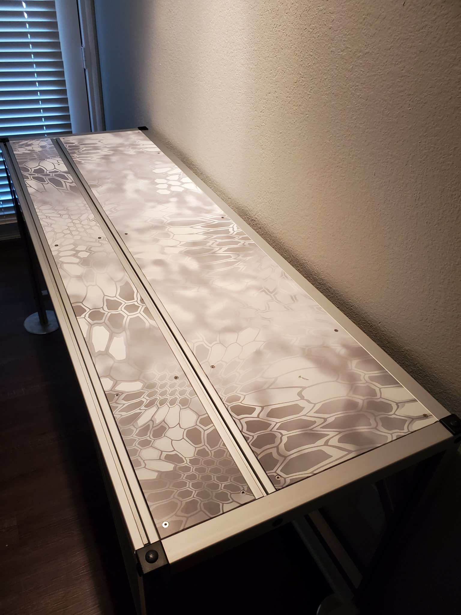

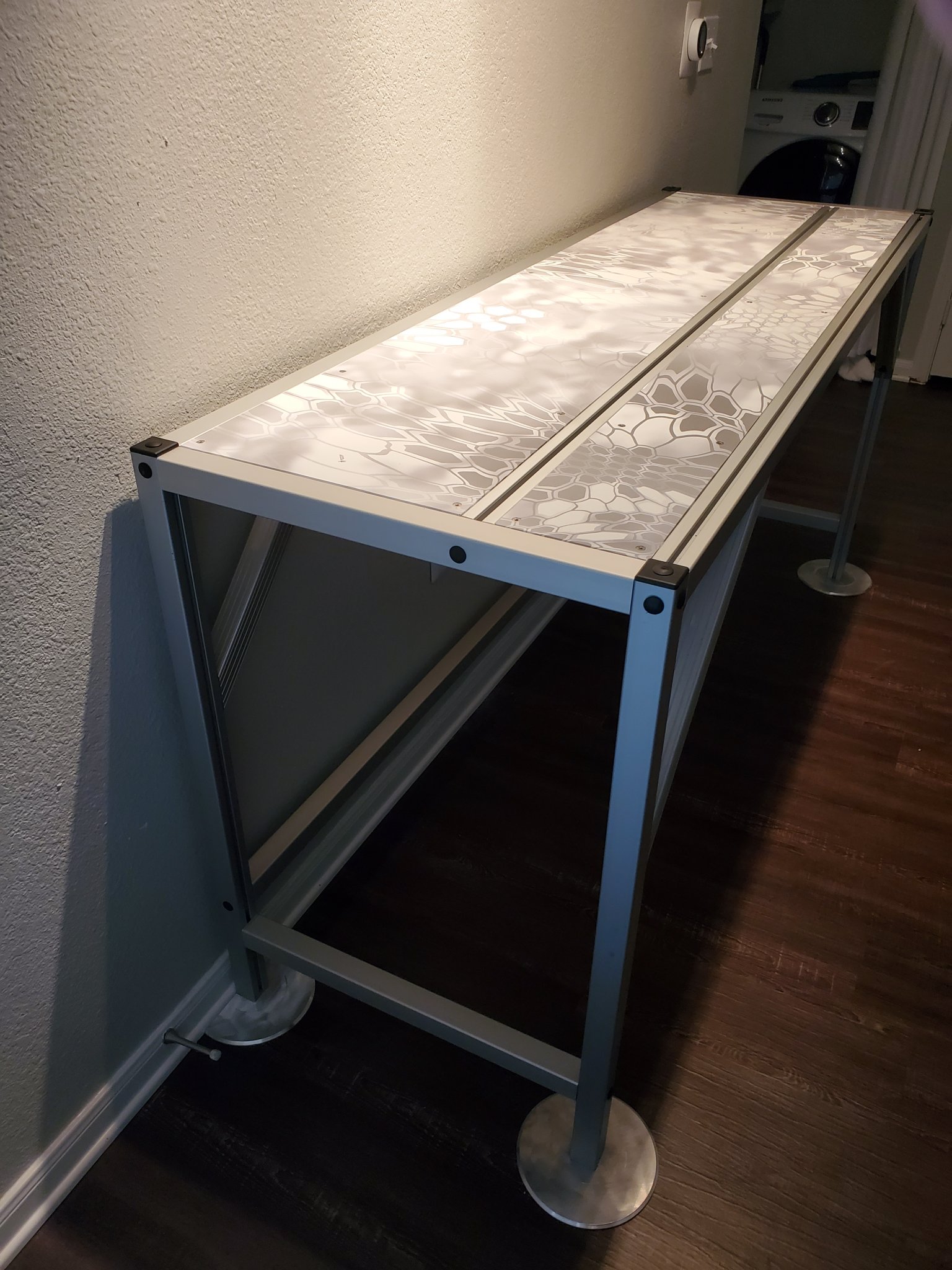

Shoot, I never even got around to buying anything. I'm trying to remember why... I think because powder got so expensive, and I couldn't find the type of bullets I wanted, so I just put everything on the back burner. I have all my components now though, so I'm starting to accumulate some equipment again. With that being said, I think I'm still going to go with a full length sizing die. I haven't really educated myself anymore on the subject, but the fact that multiple people have told me that they've never needed a s/b die, that's enough for me to decide against it. Plus, and I'm just going by my intuition, it just seems trying to get neck thickness consistency while sizing with a s/b die, then removing the ball and expanding with a madrel would be a hassle. It seems you would have to interrupt everything your doing on your press after you expand it, to then go trim the neck, and then back to the press to finish it off... Idk, not saying that as a matter of fact, but I don't want to do that. Maybe you have to do that anyways, because you should size your brass before trimming, and turning. I kinda want to go in a progressive motion on my bench from left to right, starting with trimming, neck turning, press operation, and then Concentricity guaging. I don't have that exatly figured out yet. I'm still trying to learn what all tools I need, and getting them first, but here's a pic of my reloading bench I made...
