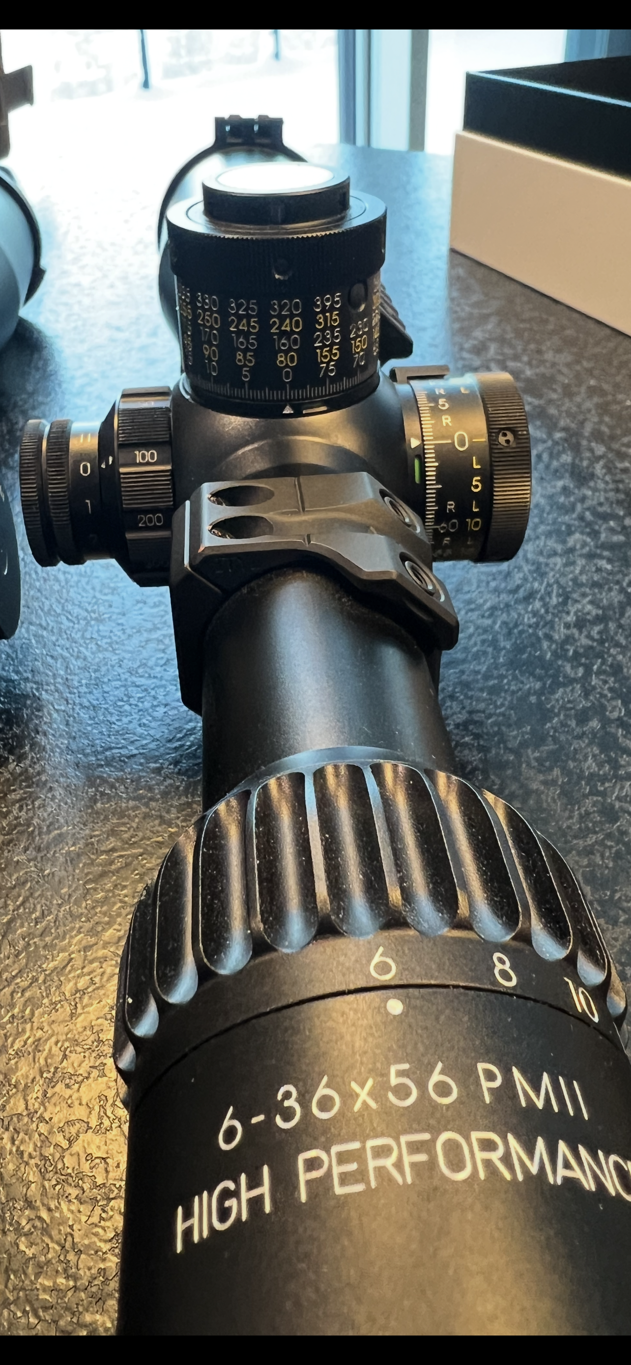

I have a PMII 6-36 with the DT35 elevation turret and ST capped windage. Before I bought it, I knew I would want to get the windage turret changed for sure, I want an exposed locking windage. I also wasn't sure if I would like the DT35 elevation and at the time assumed I would want it swapped for the DTII+.
Now that I have in in hand, I don't hate the DT35 elevation and also don't want to further limit the available elevation travel with the DTII+ (30.5mil), which means, if I am going to swap the elevation turret, I would be going with the MTII.
My question is for those that have used the MTII turret; how do you guys like it? Do you like the .05mil clicks or do you feel it is too fine an adjustment that just slows down dialing?
I have all the above mentioned turrets on 6-36 scopes.
