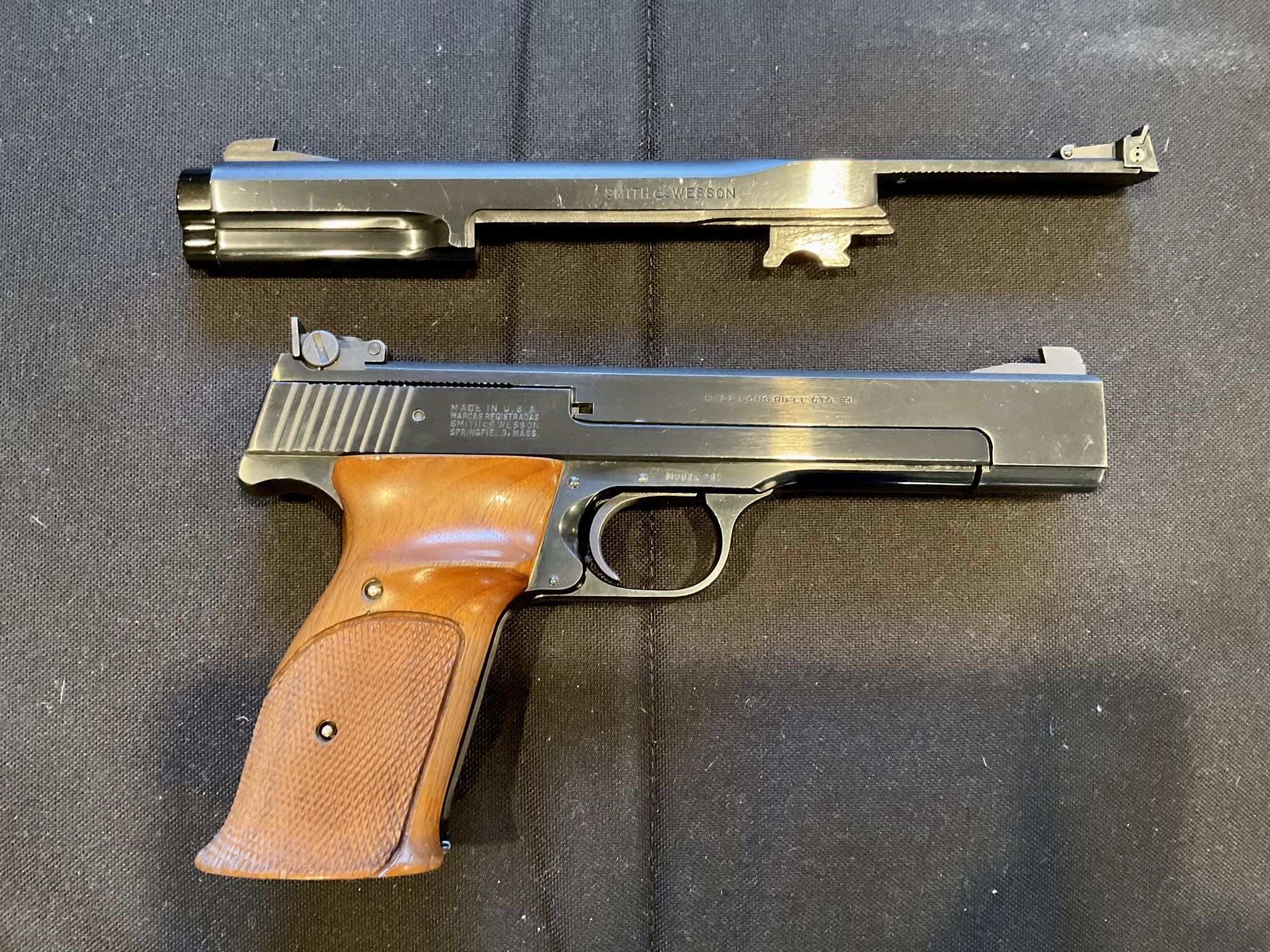

I wanted the 7" in addition to the 5" for open sights and because I didn't have one. 😁
I did the same thing, found a ‘50’s era 7” with weights, to go on my ‘68 with the 5”, went less expensive route lol, barrels
