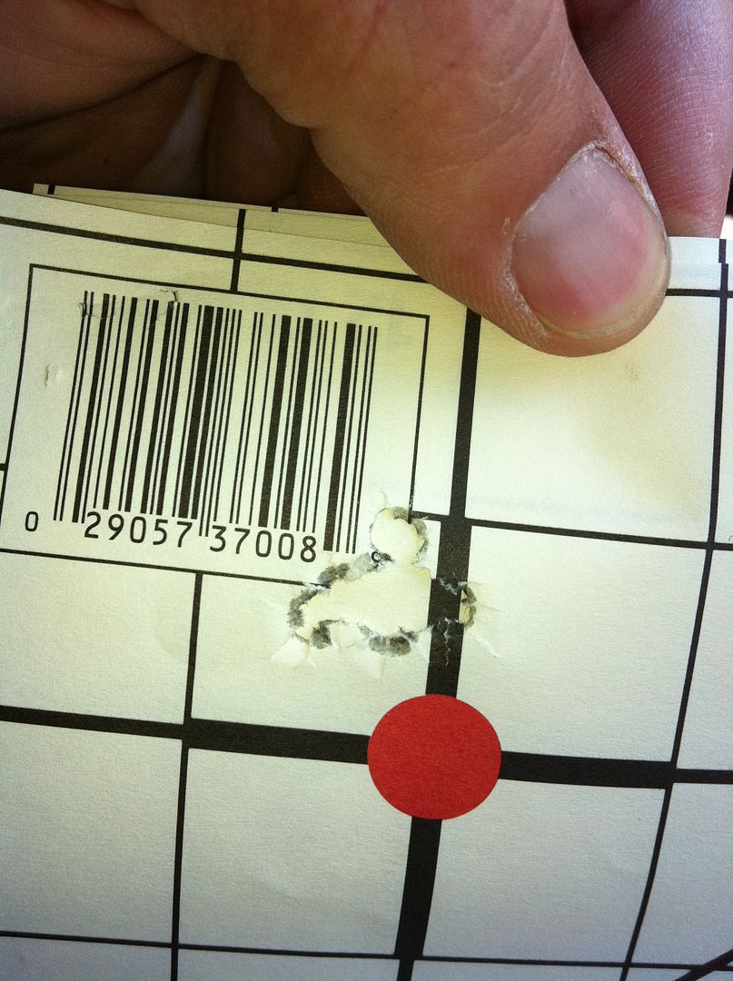

Shooters, the owner sent me a quick picture of a 10 shot test target with Hornady 6.5 Creedmoor ammo. 10 shots are right around .5 MOA.
Mark
Re: SAC: Badger M2008 6.5 CM, Melnoite/Ion Bond
Not the least surprised!
