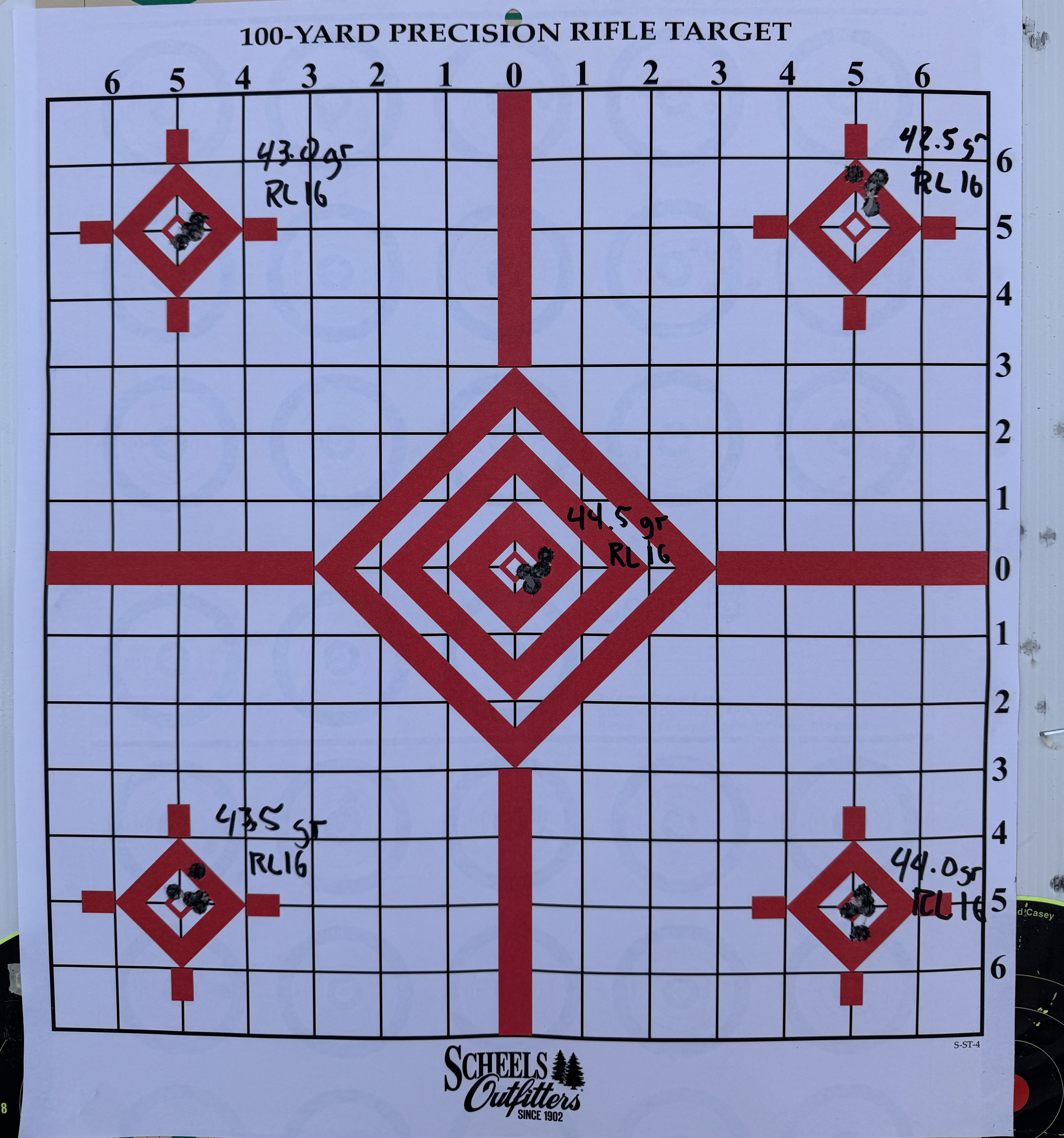

Can’t argue with the results so far:
130gr Hornady ELD-M, and once fired Lapua brass (large rifle primer), CCI-BR primer, Reloder 16 powder. Only one load gave an SD over 10 FPS (43.5gr), everything else was single digits. The top load clocked 3009 FPS out of the 24” Bartlein on my AT-X.
The groups could probably be better but I’m not holding up my end of the bargain. Smallest group was .400” largest was .585”. I’m just not currently capable of higher consistency in technique on my end of things.
