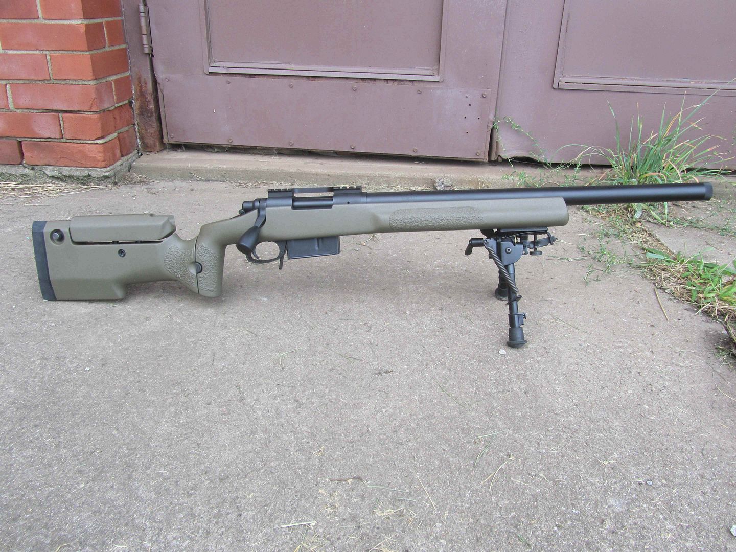

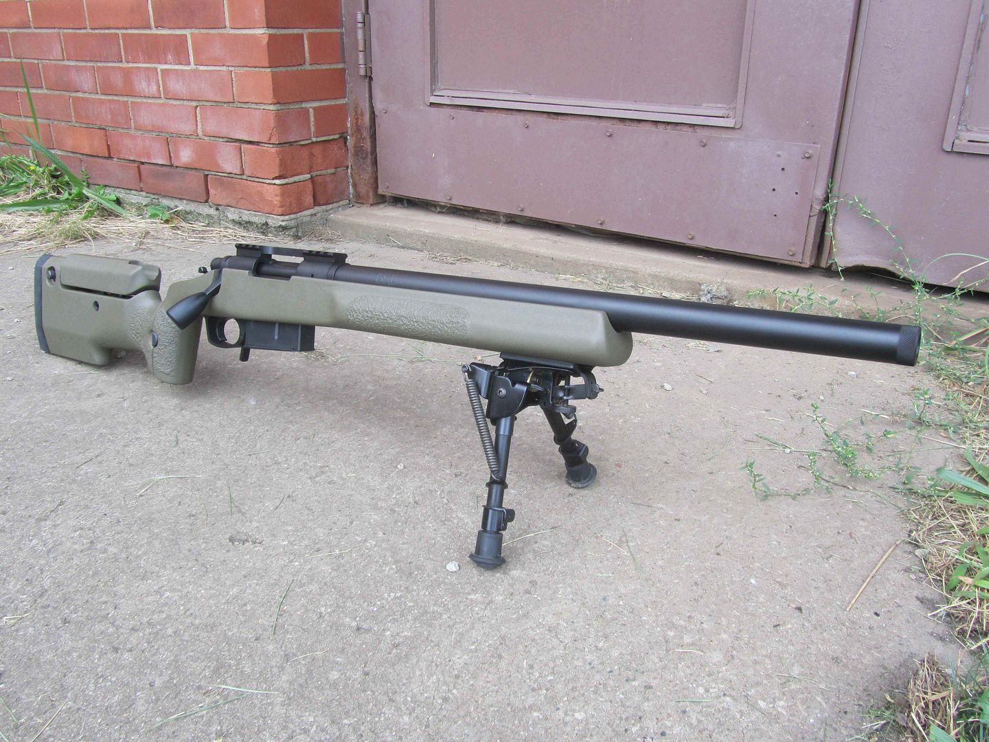

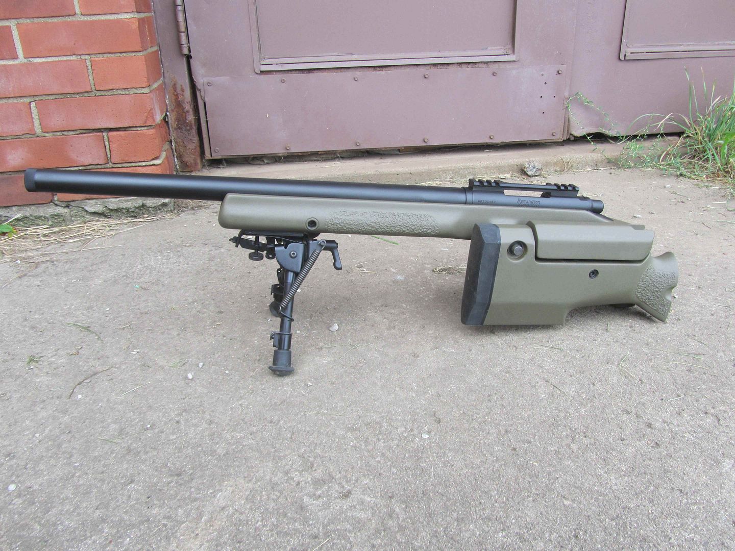

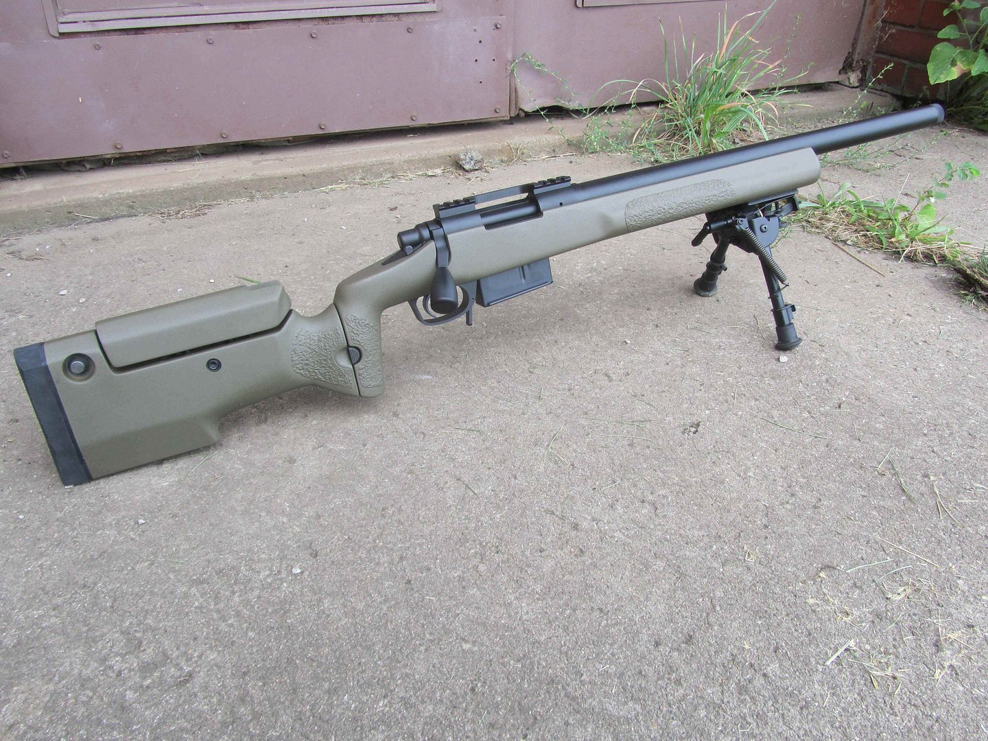

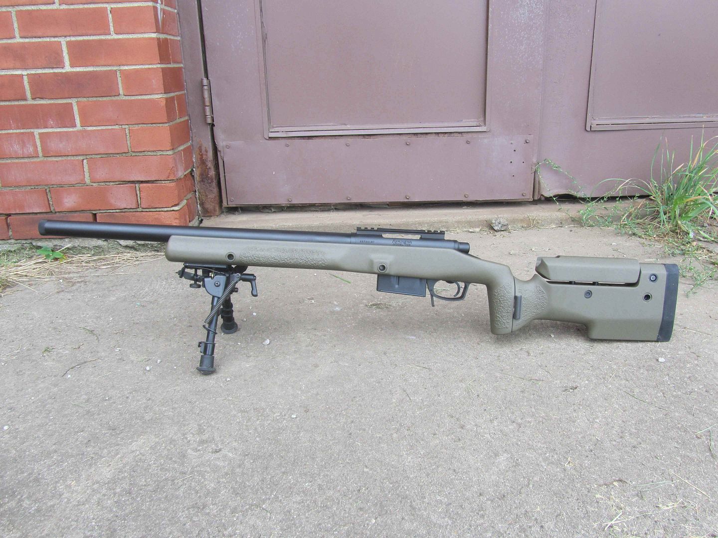

Just posting some pictures of some recent builds that we completed. This rifle turned out great and will be a blast to shoot. We started with a Rem 700 short action that was trued, the bolt handle was broken off and reinstalled in the correct location to increase extraction and ensure correct timing. Bolt knob install was also performed.

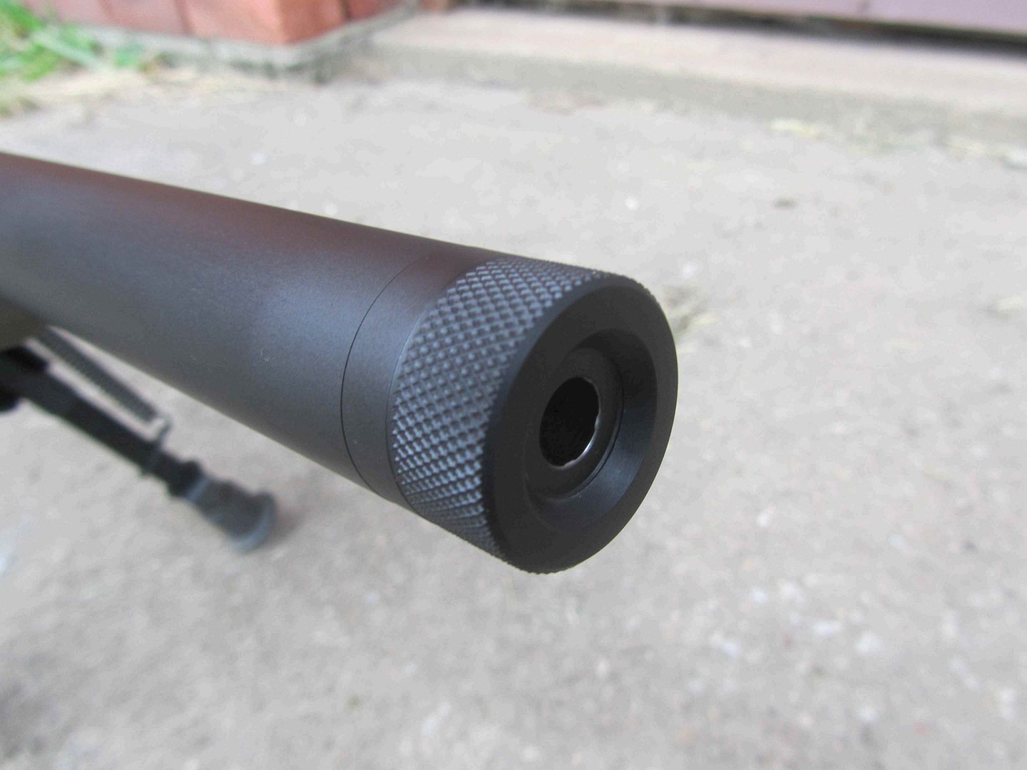

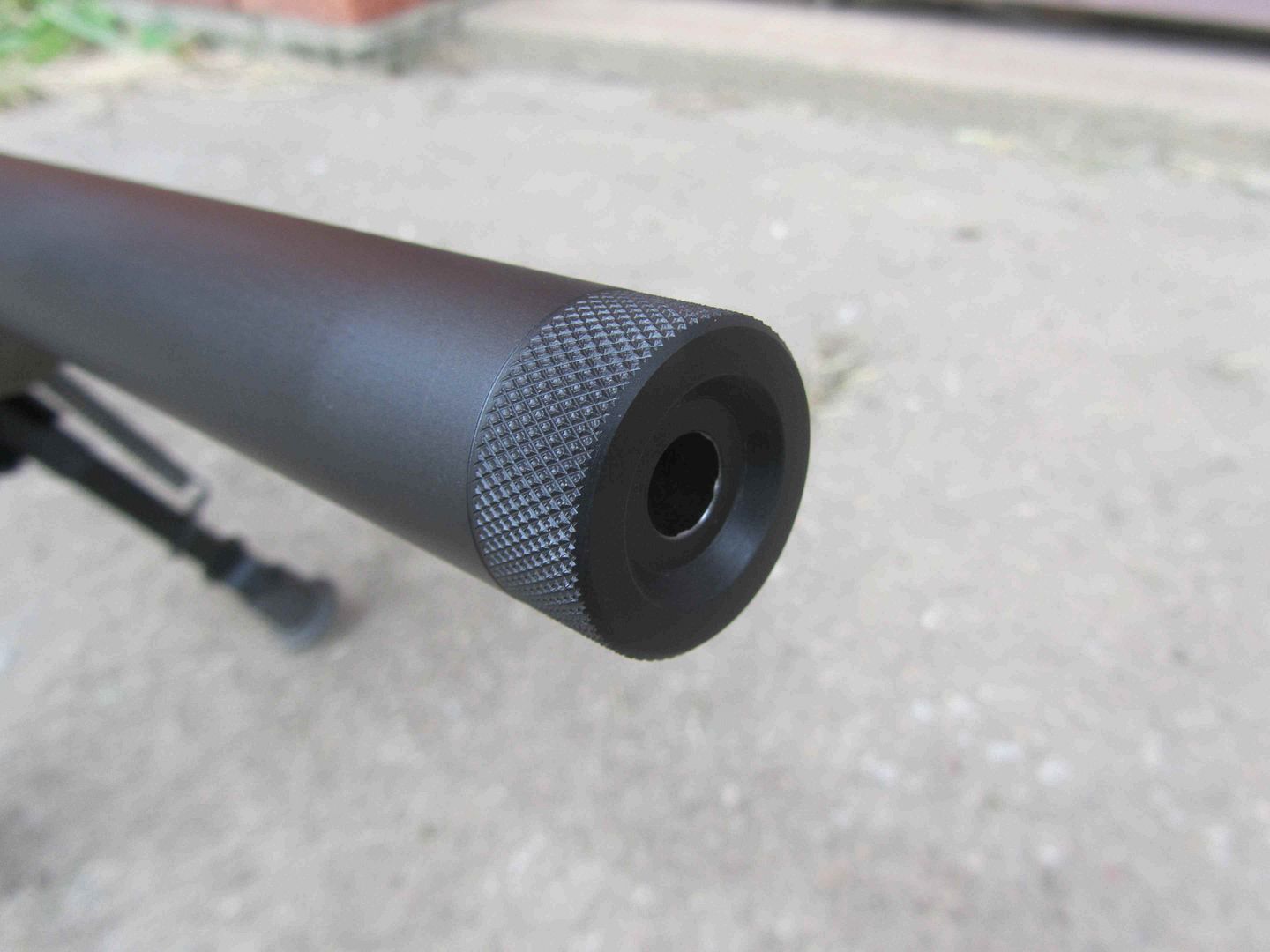

Bartlein M40 barrel was installed, chambered with our 308 Match reamer and finished at 20" with 5/8 x 24 threads and a custom thread protector. Barreled action was epoxy pillar bedded into the Manners MCS-TF4 with Badger M5 DMB installed. Barreled action was Cerakoted Graphite Black. Everything turned out really clean!
