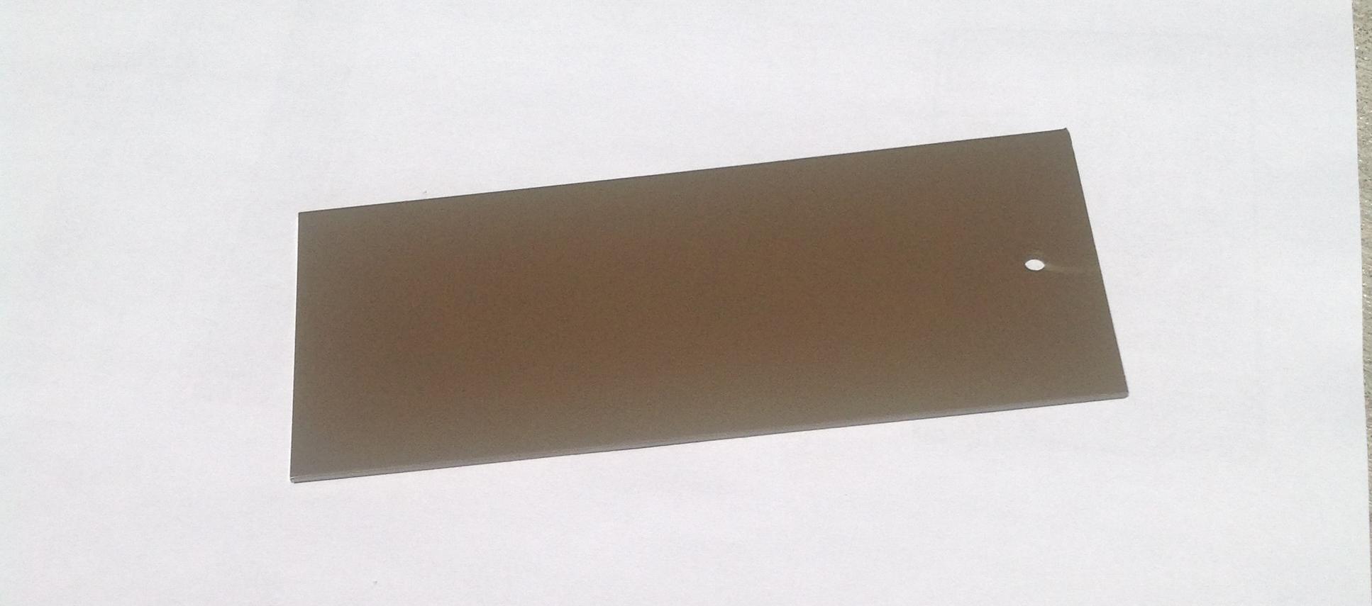

Magpul FDE for the metal.
Mark
That looks so much different than the sample of Magpul FDE that my smith sprayed for me. I went with Patriot Brown and hope to be happy with it.
