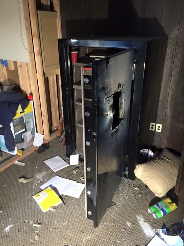

    A buddy of mine is in the security system business they sell safes also. He sent me this picture the other day of a local break in, looks to be a browning safe. You get what you pay for, I got an American Security Safe from my buddy, there more expensive but well worth it. Couple things, as mentioned get a bigger safe then you think you'll need, I like the dial better then the key pad, batteries and electronics can go bad not good if you need in quick. Make sure you bolt it to the floor, a thief with a handful of golf balls can roll one right out the door. Good luck.
    My comment on this as someone that has worked as a locksmith, installed alarm systems, and has drilled open safes:
    1) It is imperative that the safe door be a true 1/2" plate steel today. 1/4" plate steel walls as wall if you can swing it. If you can't afford a 1/2" plate steel door safe, get one with 1/4" plate steel as a minimum. Do not go any thinner. This safe is an example of a product that has a door that looks thick, but just wrapped thin sheet metal around drywall. IMO, the best value in a true burglary safe is the Amsec BF series. If you have a very expensive collection, consider getting their higher rated models. The lower models are more affordable and will at least have 1/4" plate steel doors. But the BF series I consider entry level for solid protection.
    2) If you have a monitored alarm system, put a monitored smoke alarm above your safe. When burglars attack the safe it can make a lot of smoke and it will set off the alarm. Most panels will call for a fire department dispatch if the alarm goes off even if the burglar alarm side is disarmed.
    3) If you can place the safe in a closet so the walls and back are protected by the walls being present, that is good. If you can also place the safe so that the opening side goes away from the wall that is good as well. This last point means someone trying to get a crowbar into the opening edge would be hitting the wall and can't get any leverage vs. having the opening edge away from the wall if that makes sense.
    4) You may want to consider buying some "Explosives" magnetic placards to put on your safe. They are cheap and may discourage someone from attacking your safe with cutting tools that are throwing around a bunch of sparks. Even the densest moron would think twice before throwing a bunch of sparks into a safe with that kind of labeling on the door, and the placards are cheap so it can't hurt.

    that browning safe is one of the main reasons 10 guage steel is important to me. Anyone with $50 can buy a cut off wheel from home depot and go to town.
