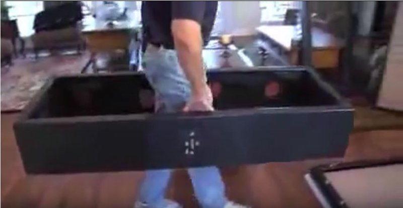

Don't go cheap, and don't go small. Check out Zanotti Armor. Modular and highly transportable. http://www.zanottiarmor.com/ You won't, however, get away for $1K and get anywhere close to that capacity level. Don't forget that scoped rifles cut down your capacity very, very quickly.

Let's go back to the OP's original premise, as these threads tend to lose focus the less we actually read what the OP had to say. He wants:
  1. 30-40 guns
  2. Easily transportable
  3. Under $1,000
Like most things, you can't get everything you want, but if you're really lucky, you can get two out of three. Alas, with these, such is usually not the case.
Zanotti's 2014 pricing:
Model ZA-1 (16 gun - 60"Hx25"Wx20"D - 400 LBS) is listed at $1,353
Model ZA-II (30 gun - 60"Hx31"Wx25"D - 600 LBS) is listed at $1,562
Model ZA-II 6 ft (30 gun - 72"Hx31"Wx25"D - 700 LBS) is listed at $2,019
Model ZA-III (52 gun - 60"Hx40"Wx30"D - 825 LBS) is listed at $2,138
Model ZA-III 6 ft (52 gun - 72"Hx40"Wx30"D - 925 LBS) is listed at $2,654
http://www.northeastshooters.com/vbulletin/threads/258189-My-new-Zanotti-52-gun-safe-review
I can find you a "gun safe" that meets that criteria for that price, but it's just an RSC like all the others. Even Graffunder safes, which are WAY overpriced IMO/E but do look nice in nice homes, aren't worth it. Cannon makes one that has double doors, thin plated composite doors and of course like all the other gunsafes, it's just made of heavy sheet metal filled with dense drywall. I used to have a top of the line Heritage, best they made, and it had a solid tempered steel door plate, heavy enough to pull the safe over easy if the door was open. Had that safe been bolted down and installed in between three concrete block walls with rebar, then it may have been "okay".
