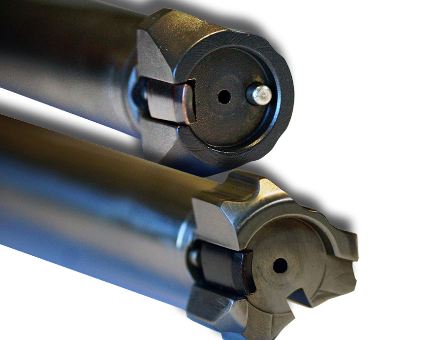

    Theres 2 types of salo bolt faces. Control round feed and push feed.
    You can convert either, ive done the CRF a few times. You need to open the face in a lathe and also open the side a bit to allow it to feed in easily, or! Do the whole job in a mill, which i found easier in the long run.
    Sako trg top, 85 bottom.
