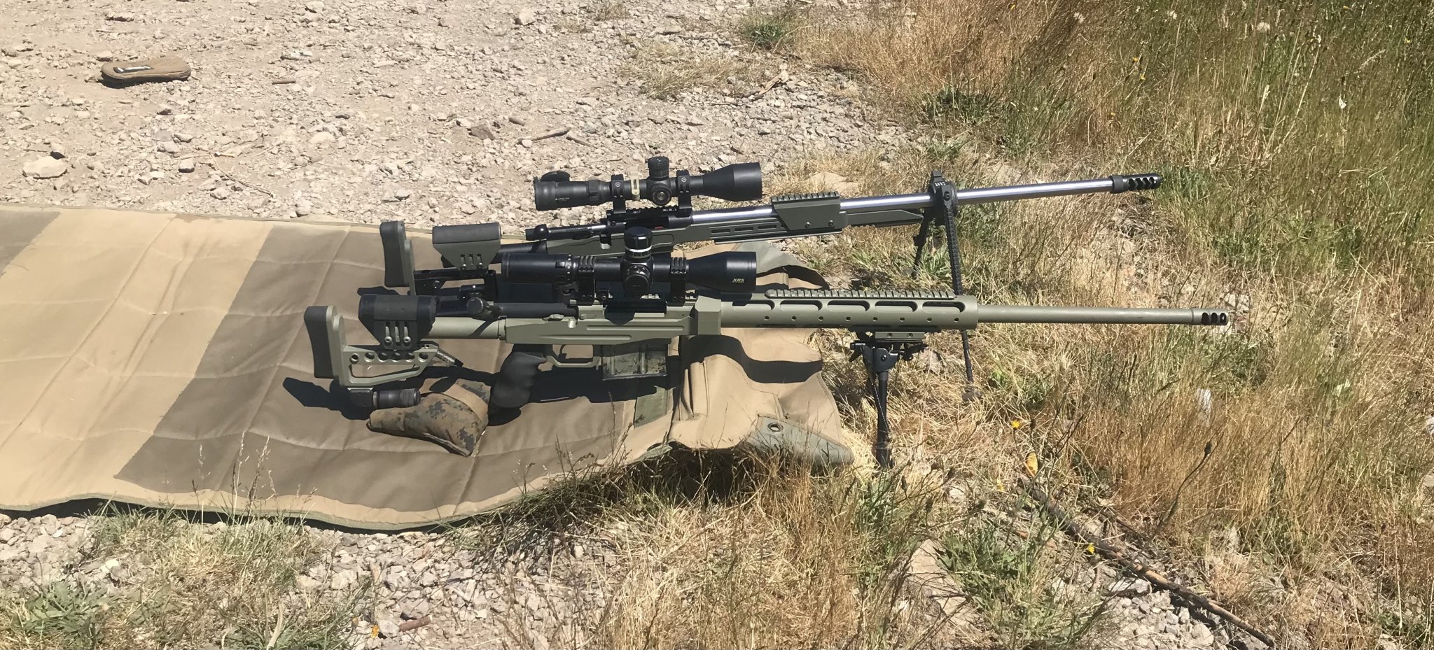

This is a shooting buddy’s 995 in 338 lapua.
30” krieger I believe
Reactions: buggz and M77

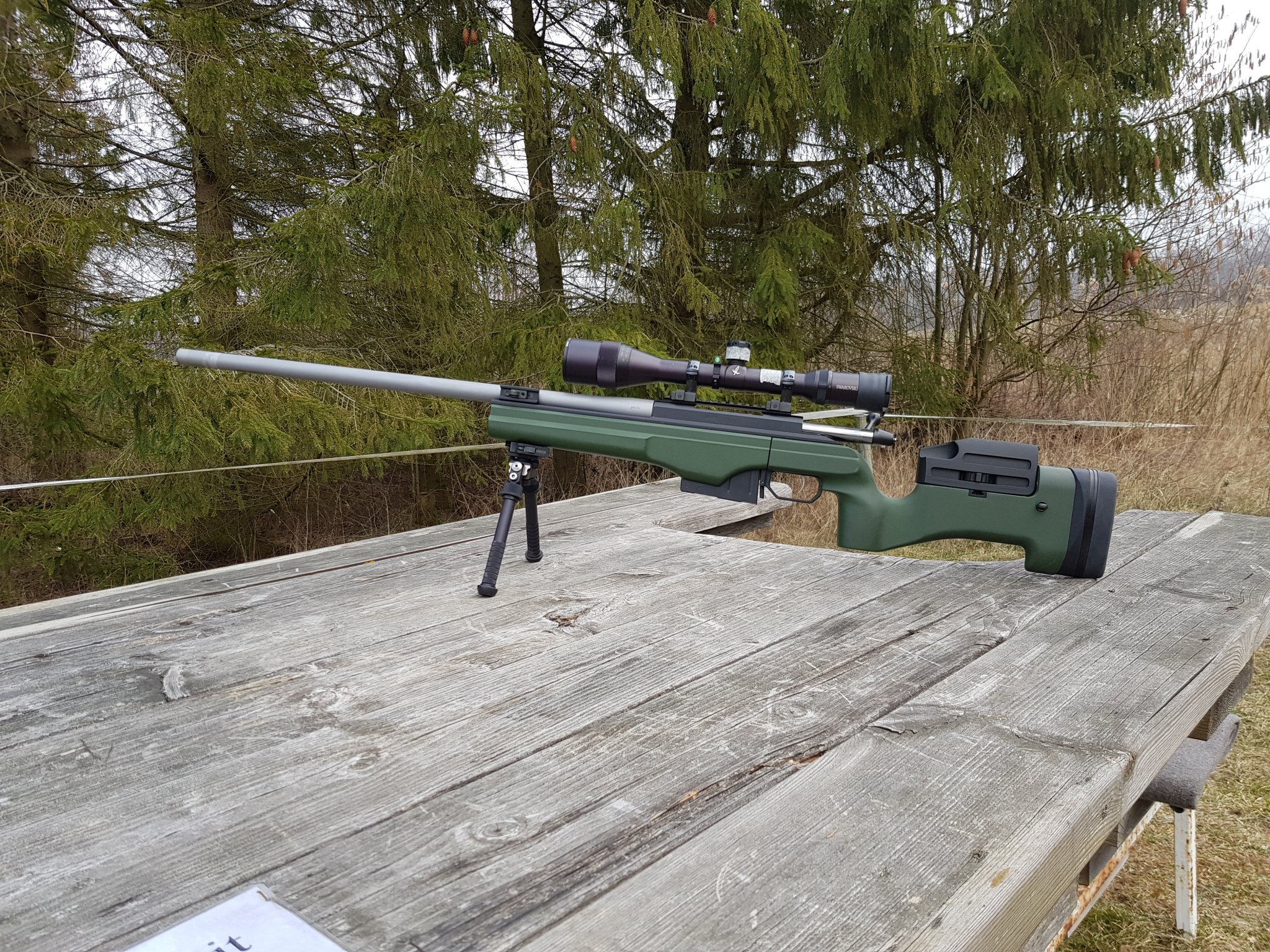

Has anyone done a rebarrel on a Sako M995 TRG-S?
Now with my chassis kit, I am wanting a heavier barrel, instead of this skinny hunting barrel.
And possibly a new twist is required to shoot the heavier 300 grainers, instead of the 250s?
Yes. Krieger 1:8 280AI Rem Heavy Varmint.

Those rebarrels are super cool.
Thanks for sharing.
What ‘smith was used for the swap?
Or, is it possible to perform this on your own?

Any decent Smith can do it.
I have a lathe at work so now I’m doing my own barrels.
I’d have to get an accessory gear set to do metric threads like what’s on an AI or Tikka.
Thanks, I’m hoping to find a local ‘smith in Georgia.
I am actually now excited for this rifle outcome.
