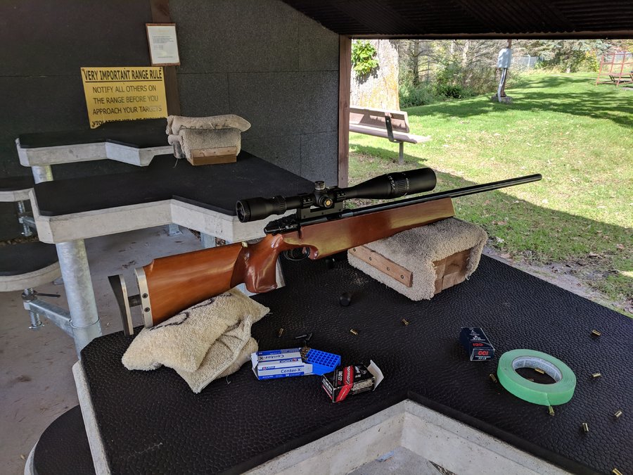

540X and 540XR are a different rifle than the 540/580 sport rifles. The 540X and 540 XR are purpose built single shot target rifles. They have adjustable triggers and heavy barrels. They are said to have a very fast ignition which is similar to a 788 trigger which is not adjustable. I do agree that bedding may help. Some say not. In any case, mine is very accurate and comparable to other similar Target rifles. Typically, a ragged hole at 50 yards with match ammo. However, I have been soundly out shot by a well-tuned 40X. The 540 XR will outshoot a sporter rifle in my experience. I do not have any problems like first round flyers. That is usually caused by a carbon ring or improper cleaning and seasoning. I do not know how it would compare to a Sako. I have never shot one or shot against one. The top .22 LR bench rifles are either 40X or a custom clone of a 40X like a Vudoo etc.
