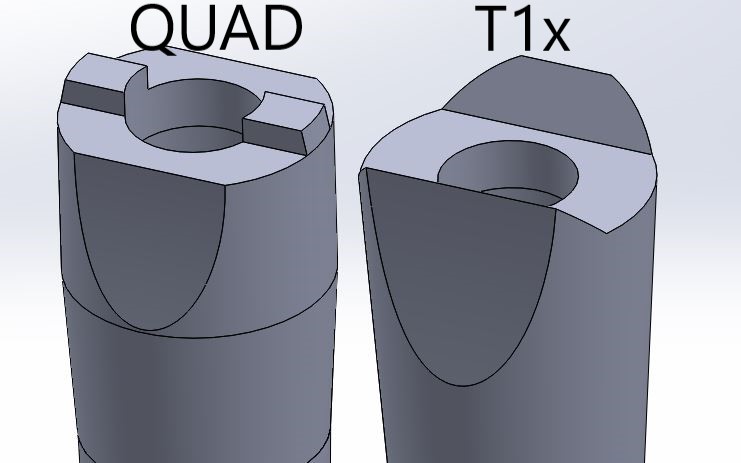

Now, speaking of my problem. Can anybody tell me, is the attachment of bolt handle on my Sako identical to Tikka´s T1X ? I have found many sellers that offer bolt handles compatible with both rifles, but those handles ends just with a thread, that screws into bolt directly (just like the DIP handle). The original bolt handle is secured to bolt with an allen screw that passes through the handle and into the bolt. This handle seems to be held in place just like the original. But as far as I know, the Tikka T1X has a straight bolt handle, Quad has angled one.
Will it fit?
The DIP handle is a plain threaded end - it'll screw into the Quad OR the T1x (Both use an M5 thread).
If a T1x handle is made PROPERLY, it'll actually use angles to interface with the bolt body to stop it from rotating, and will look nicer too.
So unfortunately you won't be able to use a T1x handle that has those angles on your Sako Quad. Unless you file/machine/grind the angles off.
The Sako Quad is meant to use a Flat Slot to stop the handle from rotating - but again, some options on the market don't have the anti-rotation slot because it's easier to just turn a thread on the end of a handle (cheaper/easier to produce).
The Quad bolt thread has been put on an angle, but for a straight handle like you're showing - it's not going to really matter.
(Rifle shown is a Quad - you can see the handle angles back at the bolt body - The T1x is straight / 90deg from the bolt body)

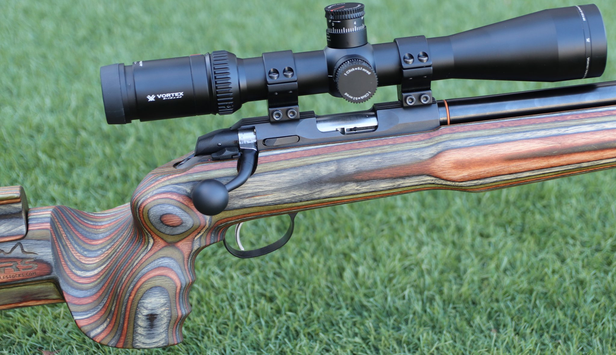

Thanks for answering my question :) So, now when T1X Handle is out of the list, i found something interesting. As I see, T1X has a bolt handle mounted straight face to bolt, whereas on the Quad, it is mounted under a few degrees angle. After some research, SAKO A7 seems to have identical bolt angle to Quad:
http://lumleyarms.us/index.php?route...&product_id=78
http://lumleyarms.us/index.php?route...&product_id=56
It seems to me like this could be compatible. That Aussie shop also has one:
https://highvelocityhuntingaustralia...handle-rifled/
The only thing i find missing on A7 is the flat slot that Quad has. So...might be worth a try? (I must confess, i just really like the shape of that rifled knob)

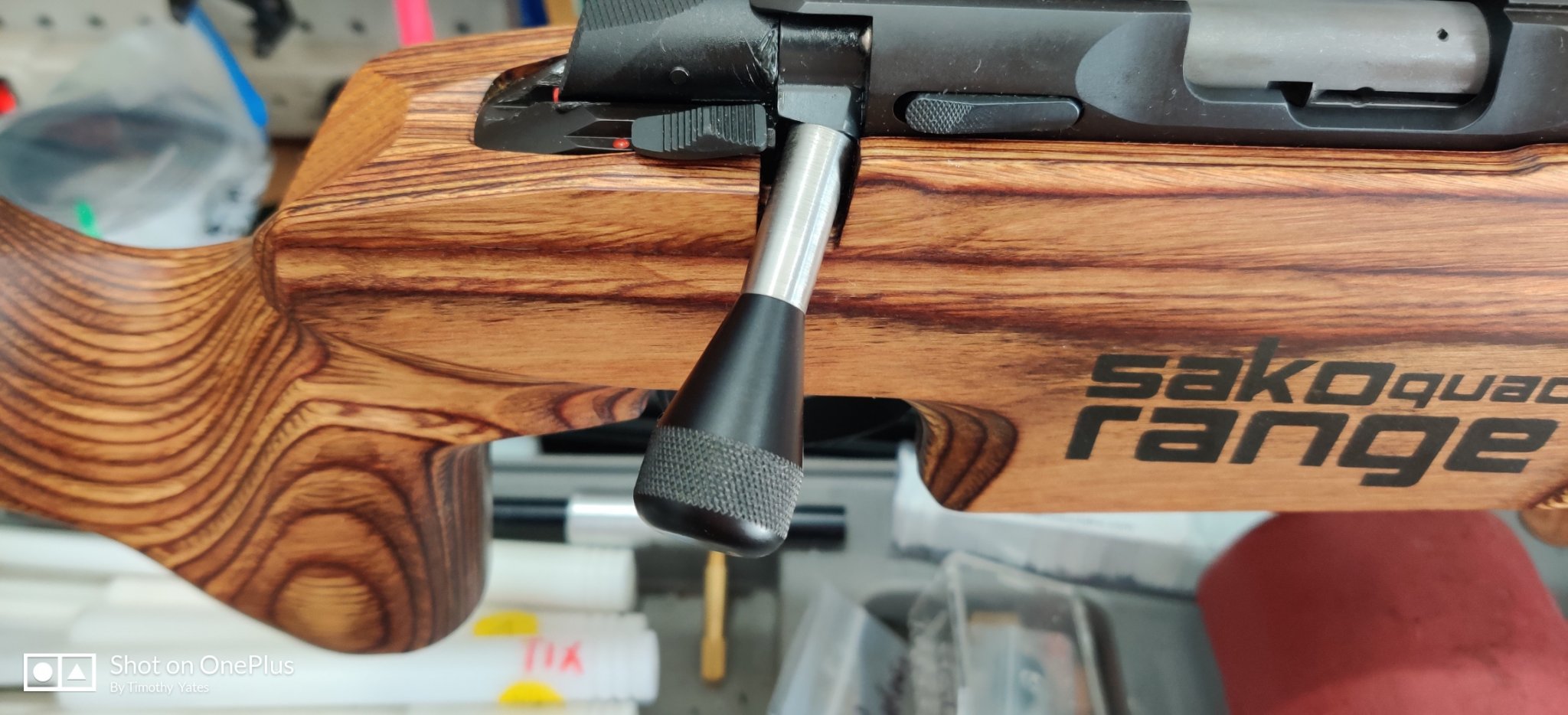

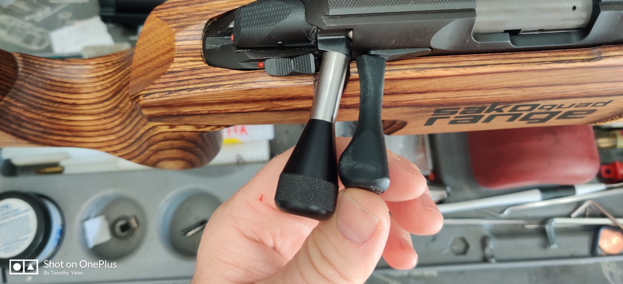

Is that bolt handle on the Quad made for it or did you modify a T1x to work?
I made a sako quad version because I couldn't use the T1x version on the quad. It uses the slot in the bolt to stop it from rotating which is important when the handle isn't just a straight design. The quad doesnt seem as popular these days with a lot of other new options around
I wish I had known that a few days ago and I would have gotten one from you.
Reactions: cannoncrossfire
Was the angle of handle mouting that is present on Quad Bolt a problem for you?
The angle isn't a huge deal to be honest, it's that a straight threaded handle will not care at what position it's tightened on, but a bent handle needs to be orientated in the correct position which is almost like threading and timing a muzzlebrake so its horizontal. So for the bent handle other attachment methods/ideas were employed.
Easa,
You'd probably be better off getting a design like mine. Like Cannon mentioned, doesn't matter where mine tightens down at, it's always going to be the same, look the same. The bolt handle is really the only thing that needs upgrading from a ergonomical standpoint. I think it looks better too.
