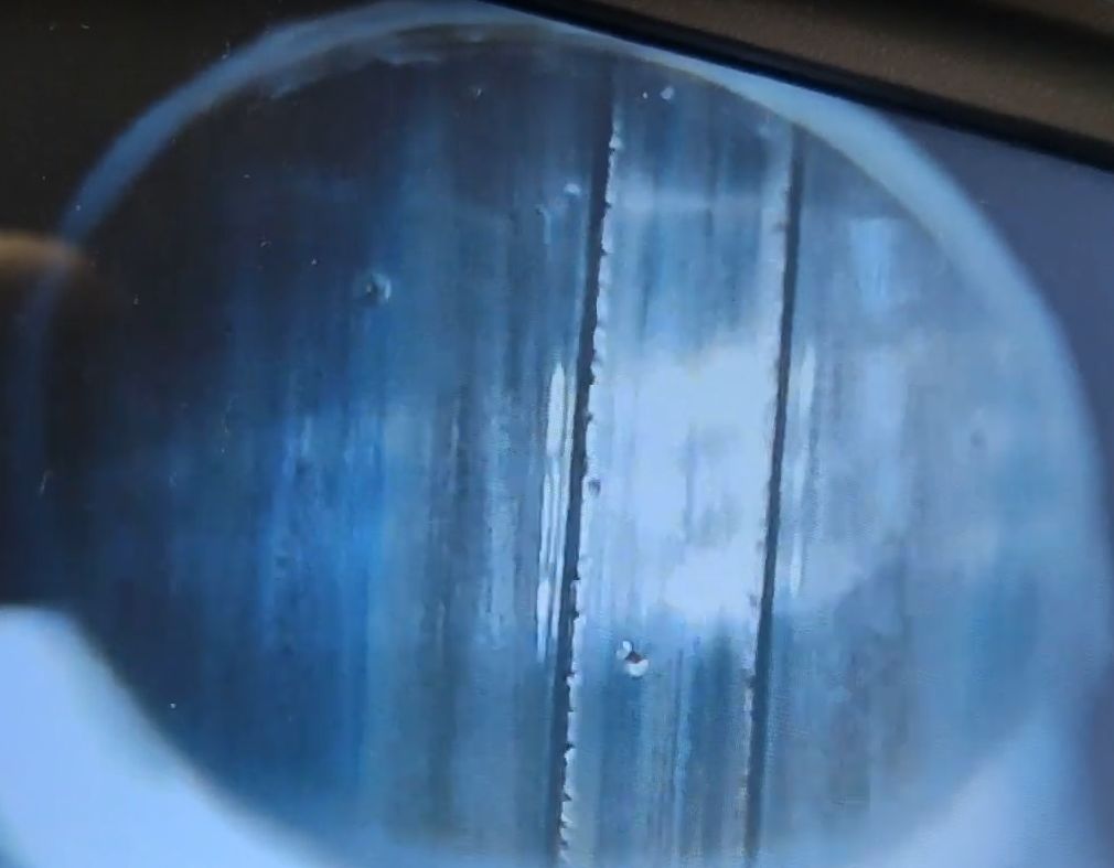

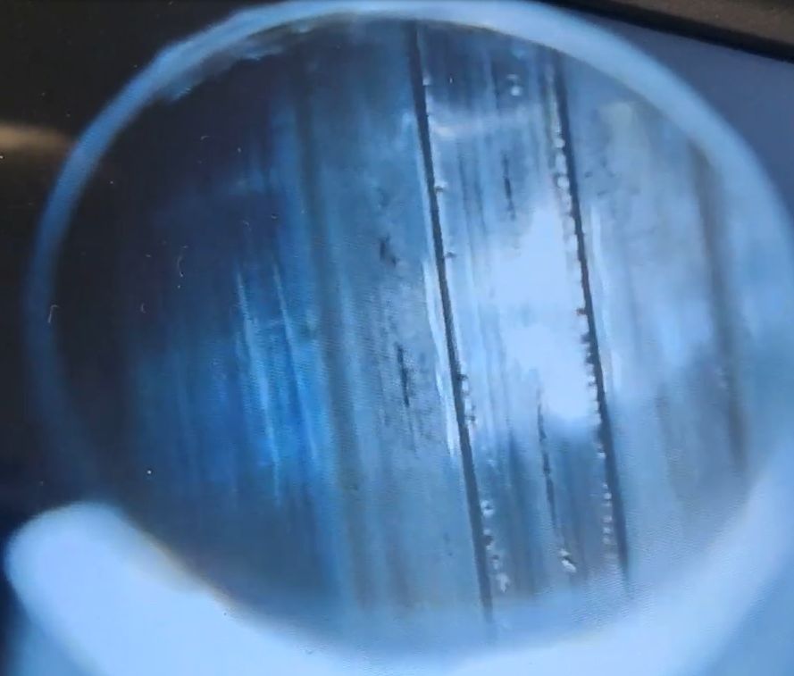

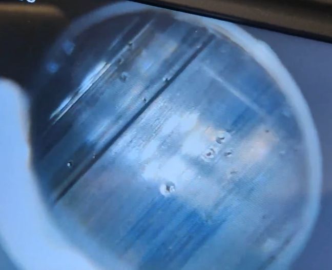

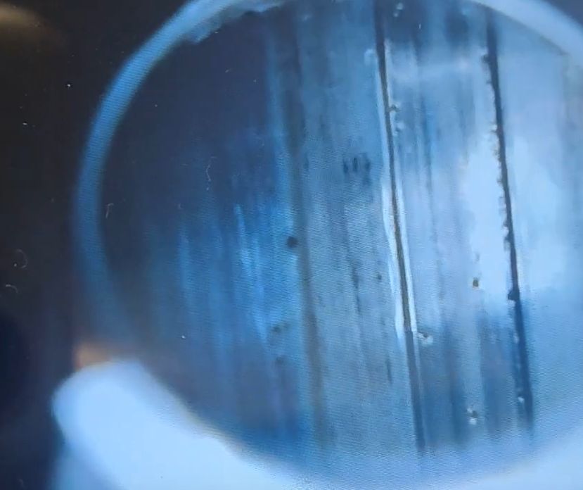

Hi,
I became the new owner of a TRG 22 rifle in .308 win caliber.
I was curious and who is curious sometimes learns a lot...
I was a little concerned about the image of what I saw in the bore using my friend's borescope.
A professional in the field looked at the gun with me and more or less confirmed that the rifle appears to have been fired to about 500 rounds, as the seller claimed...
Anyway, eventhough me being a novice, I didn't really like how the bore looked much, the other rifles that I had the opportunity to compare mostly looked better and had fewer of these "defects".
In my gun, it is almost all over the surface of the barrel. I expected that there would be some signs of wear, something like so-called "fire cracking" within a few inches of the chamber, which should be normal, but I haven't seen much of this anywhere. :D
What is it? A friend who looked into the bore said that it was simply a normal manufacturing defect and that it could not have been caused by anything during shooting, cleaning, etc. So it must have been like that since the factory!

It looks like a used barrel to me. Beyond that, unless i see some really obvious problems like burrs or other things that would lead me to believe the gun isn’t safe to fire, I’d move on to shooting it. Don’t worry about how it looks once it had rounds on it beyond that…Sako TRGs are awesome rifles and this one should be no different.
That rifle is obviously defective. There is absolutely nothing you can do to get it to shoot well, ever. You can send that clearly worthless rifle to me for proper disposal - I'll even pay the shipping costs.
I kid, I kid. I have no idea what those marks inside your barrel are or how they got there, but I agree with @nn8734 - get some good match ammo and see how the rifle actually shoots before you worry about it.
Congratulations on the TRG - they are fantastic guns.
I know you don’t want to hear this but my money would be on it is pitting from rust. I purchased a used TRG years ago that the bore had rust in and after cleaning it there was similar pitting. It shot well enough, but not as good as the 5 or so other TRGs that I have owned. Saco uses chromoly barrels and they will rust much faster than a stainless barrel (which will also rust).
As said I would just shoot it and see how it does. If you do end up replacing it I have good luck with the PVA, if they still offer a “prefit” if not any gunsmith can chamber you one up.

My TRG in 260 has the same pattern of holes or pitting you are asking about. I think it´s caused by the hammer forging process. If you try to stuff blue tac into a bottle cap you are not likely to get a perfect print of the inside. There will likely be a similar pattern.
Well, that sounds really interesting then... Would like to hear anyone else's opinion about this theory then!
It’s from the hammer forging process. Bore scopes in untrained hands lead to more nonexistent issues being thought up. I’d bet your rifle shoots just fine and it’s nothing to worry about.

Really, just shoot it. That barrel doesn't look horrible. It's a 260 anyways, it will be done in soon enough.
The pitting can be caused by the hammer forging process but doubtful. It looks like corrosion or something, but I would give zero shits. I've never met a TRG that wasn't a .5 moa gun.

This is why I never recommend anyone use a goddamn borescope on a used barrel unless they’re trying to diagnose a problem (a problem observed after shooting the rifle). It’s a complete waste of time, otherwise.

Yeah, I’m with jbel, that’s probably from rusting / improper storage.

Nope on both your questions. That barrel will probably last as long as you can shoot it. So shoot it and quit worrying about things that don't really matter.
Reactions: GBMaryland
I’ve had 3 - TRG 42s in 300 win mag, and one TRG-22 in 308 (which I swapped the barrel out to a 6.5).
The 308 barrel was more or less what you have shown us here in the post. It shot 1 cm groups at 100 m…. And it was in less than pristine condition.
To answer your question… I am positive it will shoot well. The only issue you’re going to face is that you’re gonna have to clean it more often due to the pitting in the barrel.
What you want to remember is that barrel is a 1:11 barrel, so it will favor 10.8-11.3g bullets.
(Though, to be fair, those rifles tend shoot a lot of stuff really well. Not to mention you should be able to get a new barrel for that rifle fairly easy in Europe. One important thing to note is that in order to replace the barrel you typically have to cut a relief in the barrel right before the receiver, so that the barrel comes off easily without damaging the receiver. if you find yourself having a really difficult time getting a barrel I’m sure someone here can send you one.)

Speaking from experience having owned 4 or 5 TRG22s one that I traded for as a used rifle that just didn’t shoot quite as well as all my others. After close inspection I found the bore was allowed to rust (truly light surface rust resulting in micro pitting like yours), I am certain this was the cause of the accuracy loss. It wasn’t significant, just noticeable. It was still a sub MOA rifle at close range and MOA ish even out to 1104 yards (the furtherest I had to test it). Keep in mind the long range performance was probably limited by the conditions, shooting a 308 loaded with a D46 at 2675 fps in a density altitude a few thousand feet below sea level isn’t exactly prime testing conditions.
Like everyone is saying, once you have a scope on the rifle go shoot it. If you are new to the sport, which it sounds like you may be the accuracy should be more than adequate until you burn this barrel up. At very least use it to put a few thousand rounds down range and learn the rifle while you are saving up for a new barrel.
One thing to learn from this is what proper maintenance truly is. You will hear a lot of people saying that you never need to clean a barrel or can go long strings without cleaning before there is any accuracy loss. While this is somewhat true, know that there is nuance to the statement. If you are shooting a clean burning load or caliber and shooting regularly (at least every 10-15 days, just pulling an approximate timeframe out of my ass but it’s pretty close for my methodology) then yes you don’t need to clean after every session. However if you are going a month or more without shooting then you really should clean the bore and I prefer to lightly oil after and dry it before I shoot again, ESPECIALLY with a chromoly barrel like the factory TRG barrel.
One more thing I feel like I should mention about the TRG I traded for that had the rusted bore. I know it was stored without being shot for some time and I have no clue as to what ammo was shot through it, perhaps it was corrosive ammo. As long as you are careful and using the proper tools cleaning your bore will not degrade the life of it, where as allowing it to rust will. Powder residue / carbon will attract and hold moisture which will cause corrosion in all barrel steels even stainless barrels will rust over time.
This is just my opinion, but it is based on real world first hand experience.

The marks definitely look like pitting .
My mate bought a mint looking sako trg and his barrel was a lot more pitted than yours.
It still shot very well though.
I have one of the older sako trgs that came with a stainless barrel from the factory.
That barrel has over 4000 rounds through it and there is no pitting at all, in fact there is very little sign of any wear . I did clean It after every shooting session though.
I’ve had a TRG with putting in the barrel and had it shoot completely fine and still do quarter to half inch groups of 100 yards.
The actual issue was not accuracy, but cleaning the barrel, because pitting tends to cause it to foul quicker.
What I did in that case is, I would soak the barrel in bore tech eliminator by plugging one end of the barrel. (first you have to clean it with bore tech C4, thus removing any Siri is carbon buildup, and then you soak it.) keep in mind. This is not a we do this all the time as a matter of routine procedure… you’re only do it when you noticed a lot of copper build up.
So far I have purchased / used Boretech eliminator and Boretech Friction Guard XP gun oil. Will consider buying the C4 when Ive shot a little bit more. Btw did you get rid of the TRG? Do you have any pics or vids of the barrel? What about life expectancy of such barrel - normal? Thanks
