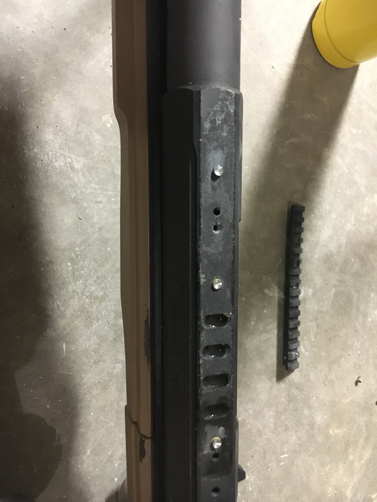

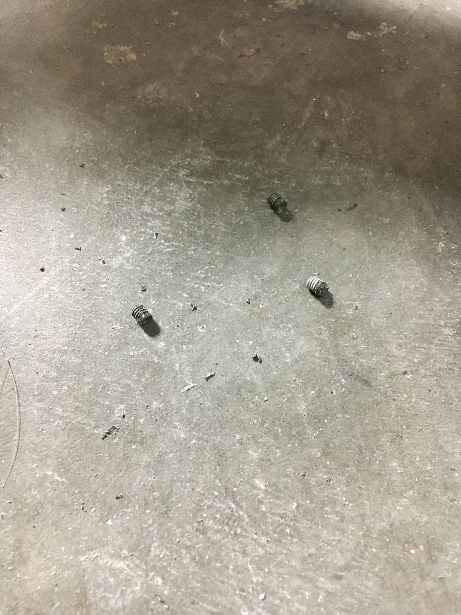

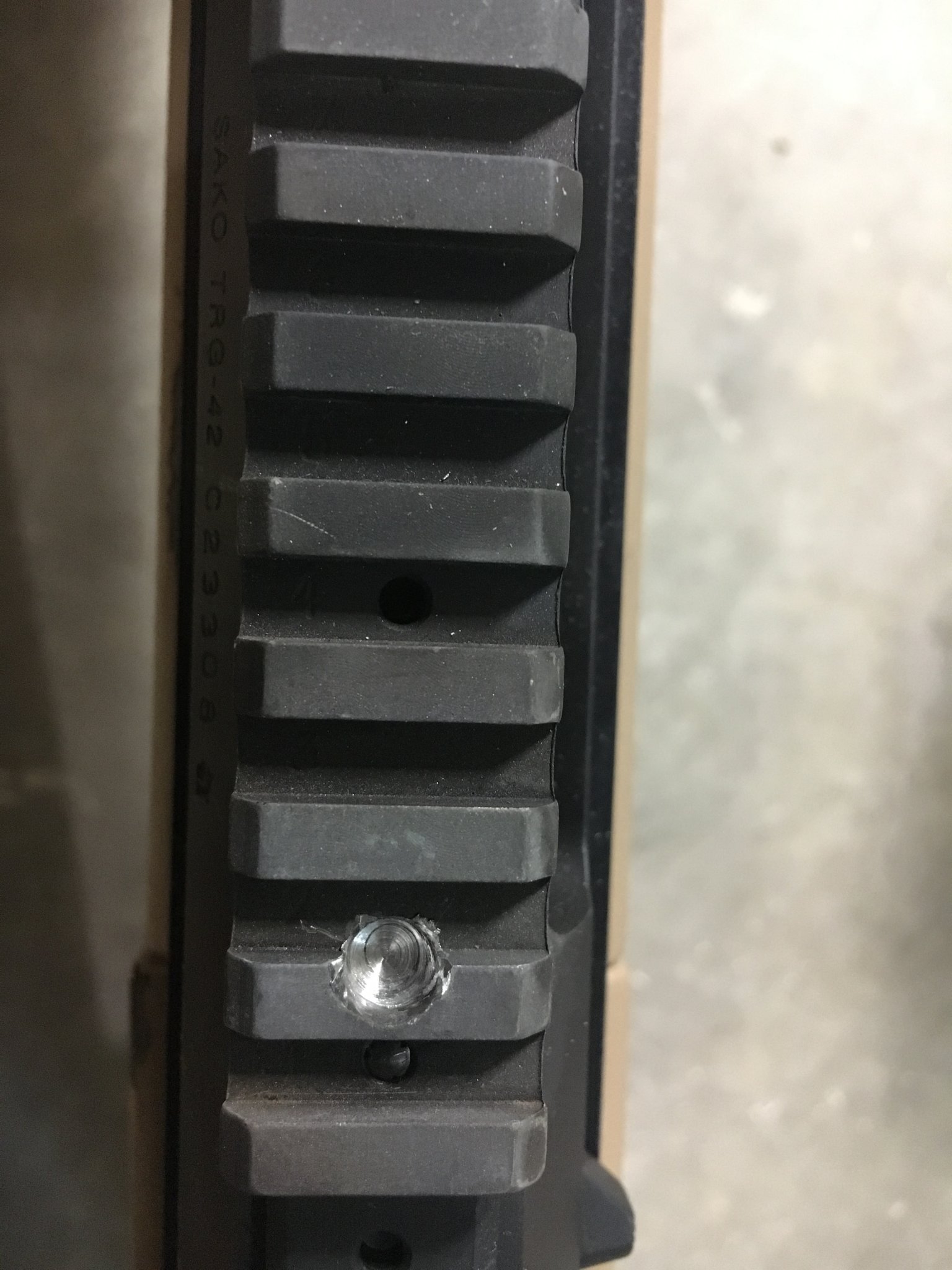

Well this was dumb. Tons of heat didn’t work, ended up drilling these things out with a shitty shit bit. These screws were super soft...
Got everything out and cleaned up the receiver...
Anyone know the screw size and if they make a torx for these things?

The screws are indeed made from the softest (and cheapest) steel out there. They're leaded steel and they get stripped all the time. I've lost track of how many TRG's I've fixed with this issue.
Typically my suggestion is to do exactly what was brought up above, go to the 8-40 with a high quality screw and don't look back.
There are lots of folks who can do that job, including the fix on the rail. I'm sure Adam from Mile High can handle it so if your department already has a relationship with them then it's not a bad idea to talk to them and see what they can do on your personal rifle.
If for some reason you strike out there then send me a PM and we will be able to fix it. I doubt you'll need to though, MHSA is a solid group of folks and this is an easy job.
