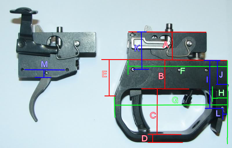

And now the request:
The 42 stock does not have a trigger housing/mag catch so I need to manufacture one. Could you please provide me with measurements for A-M in the picture below?
/C

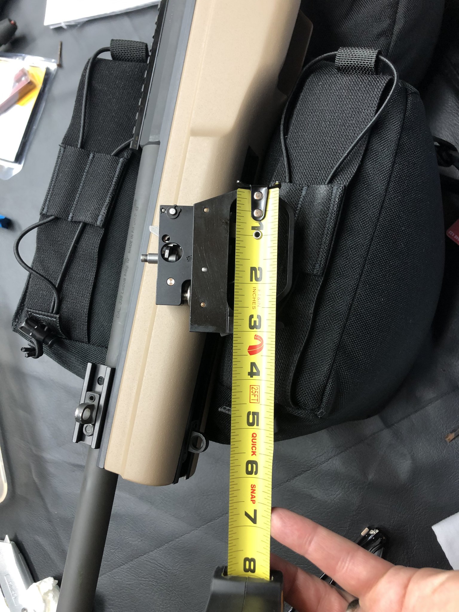

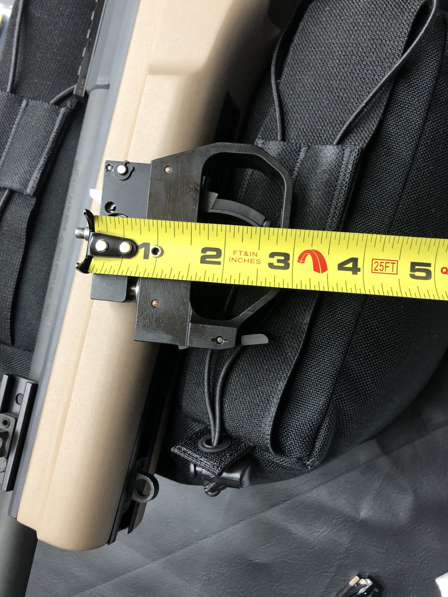

Looks like 2 & 15/16th x 3 & 1/16th
that’s from my TRG-42
It just now hit me everything on this is in metric. It’s 17.5mm x 7.3mm. The top box is 5.4mm long. It’s 20mm thick and flared to 25mm at the mag release area
