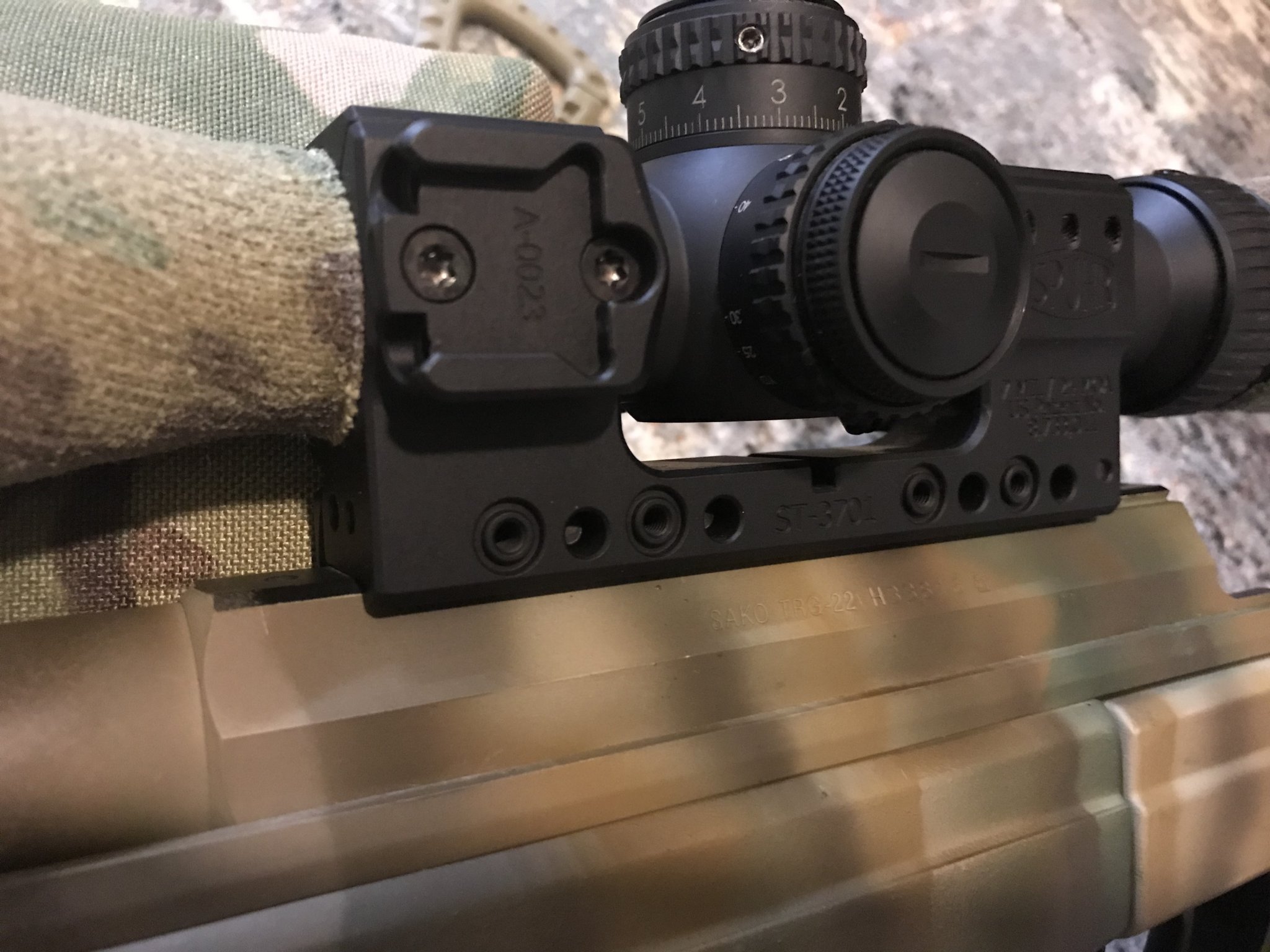

A factory picatinny rail was taken off (minus 7 oz), the spuhr st-3701 (8.5 oz) was mounted directly on a receiver, Vortex AMG Ebr-7b (29 oz), bartlein barrel in the TRG contour (similar with the medium Palma contour), Harris bipod.
Any carbon barrel will give more room for reduction. But again, nothing significant.
