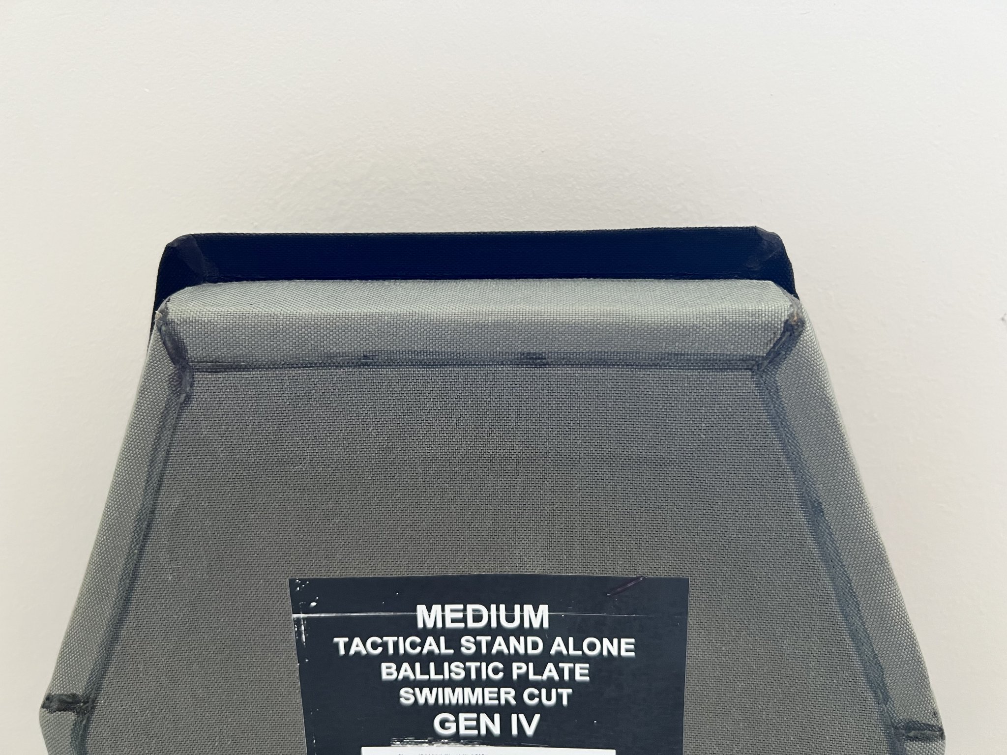

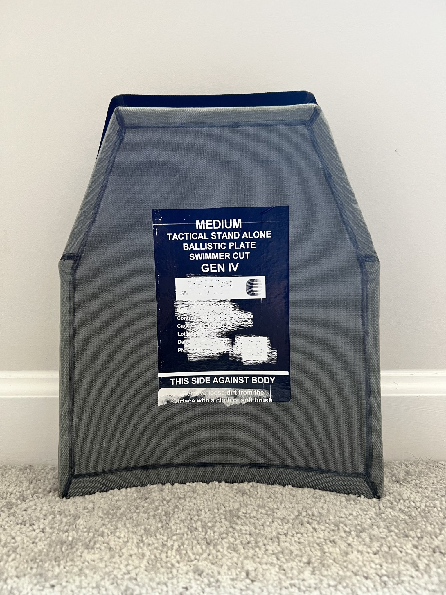

I’ve attached a pic of my 10x12 swimmers vs 11x14 to give you an idea of the difference in case you don’t have plates you can physically touch. Thats a L swimmer behind a M swimmer. The only really dimensional difference is the height. As you have noticed the corners are the only big difference between cuts but make a big difference if you have sizeable pecs and shoulders. Multicurve is a MUST if you’re wearing them more than an hour.
Edit: To add I agree with the above poster, a lot of the injuries I saw were bc of no side plates or where the side plate met the front plate. I always recommend you run side plates on a 2-way range even more so if you’re DA or FISHing.

Always shooter or some sort of curve; just be careful on some of the extreme or 'triple' curved plates as they bend quite a bit and will not fit a lot of people because they won't lay on your chest, but rather, the ends of the plate with sit on it as a pressure point.
SAPI is basically almost flat. Shooter has a curve. Curve wears better as well as clips off the size of the plate that hinders you from getting the stock into the sweet spot on your upper shoulder.
Reactions: cruiserweight
On paper the Shooter's Cut 10x12 (well, Swimmer's really) helps with -- well -- swimming and shouldering your rifle. On paper. Everyone's geometry is a bit different and you may go through a half-dozen or more plates until you find something that works for you.
I've been issued everything from ESAPIs to LTCs and Ceradynes as well as some goofier geometry plates by VelSys and always go back to Hesco's. 3810 or U210 minimum for sure.
Make sure you get multi-curves, they're a bit more comfortable, and it's likely the way I'm shaped and have been shooting but I'm fine with SAPI's. As long as you're investing in an equally quality carrier that fits you and your plate and wear the plate correctly (positioning the top of the plate right below the suprasternal notch) you should be fine.
Get side plates as well that match whatever main plates you get. Hesco pairs them off but as long as they're the right level of protection you will be fine.
You could get even crazier and look into a LAP plate (dickplate, the big triangle one), an abdominal plate, and/or something like the Crye Blast Belt which has soft armor to cover your mushier areas. I rock a blast belt because I dislike the queer 2-piece setups and like a good war belt I can spin around in a vehicle but anything other than an abdominal plate or a dangler worn inside the plate bag with an insert sucks ass in a vehicle.
