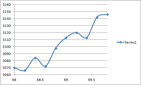

I am working up a new load for my 300WSM and tried the Satterlee method. I am using RL26, I loaded in .2 grain increments. Just curious where you guys would start after looking at these results. Is it normal to get lower velocity with higher powder charge this often (or is my scale drifting). Let me know, I have my thoughts on it but would like some input from some guys with more experience than myself. Thanks.
68.0 - 3070
68.2 - 3066
68.4 - 3084
68.6 - 3072
68.8 - 3098
69.0 - 3113
69.2 - 3120
69.4 - 3113
69.6 - 3142
69.8 - 3146
You get the lower speed with a higher charge weight because you have zero clue as to what the actual averages or spread of velocities is for each charge weight, only the snap shot of one round. Its statistically meaningless. I bet if you shot enough of of 68.6 it would average 3090 and enough of 69.4 it would be up around 3130.
So if you are going to go off of a chrono only then you need to pump those sample numbers up
Better would be to look at how they actually shoot instead
I’ve done the satterlee twice.
1st time was easy.
2nd was a bit less conclusive.
I think a satterlee done twice and the results averaged is probably a consistent way to find a good load.
From what I see you have a few options
69.6-69.8 if it’s got some pressure headroom is an obvious area to explore but may be a narrow window.
69-69.4 shows promise.
68-68.2 could be worth exploring if speed is acceptable.
My first choice is 69-69.4

BUt just to graph the lack of data for visual learners
