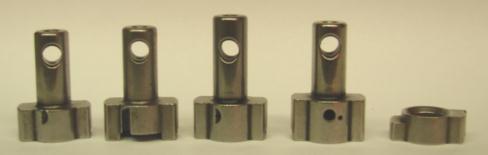

You must have one of the old staggered-feed receivers used for the WSM's and UltraMags which used CRF instead of push-feed if there's no ejector in the boltface. Confirm the bottom of your boltface is cut away allowing the case to slide into the extractor?
There's a standing ejector (should be, unless your receiver is missing it) at the rear of the receiver that pops up through a slot in the left side of the bolthead to eject the case. CRF bolthead second from left.

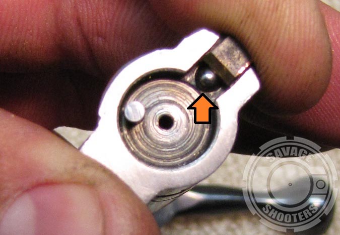

Installing a 9/64” detent ball under the extractor solved the problem in the past. On the push feeds anyways
Agreed. If that’s what you have. It’ll solve it.

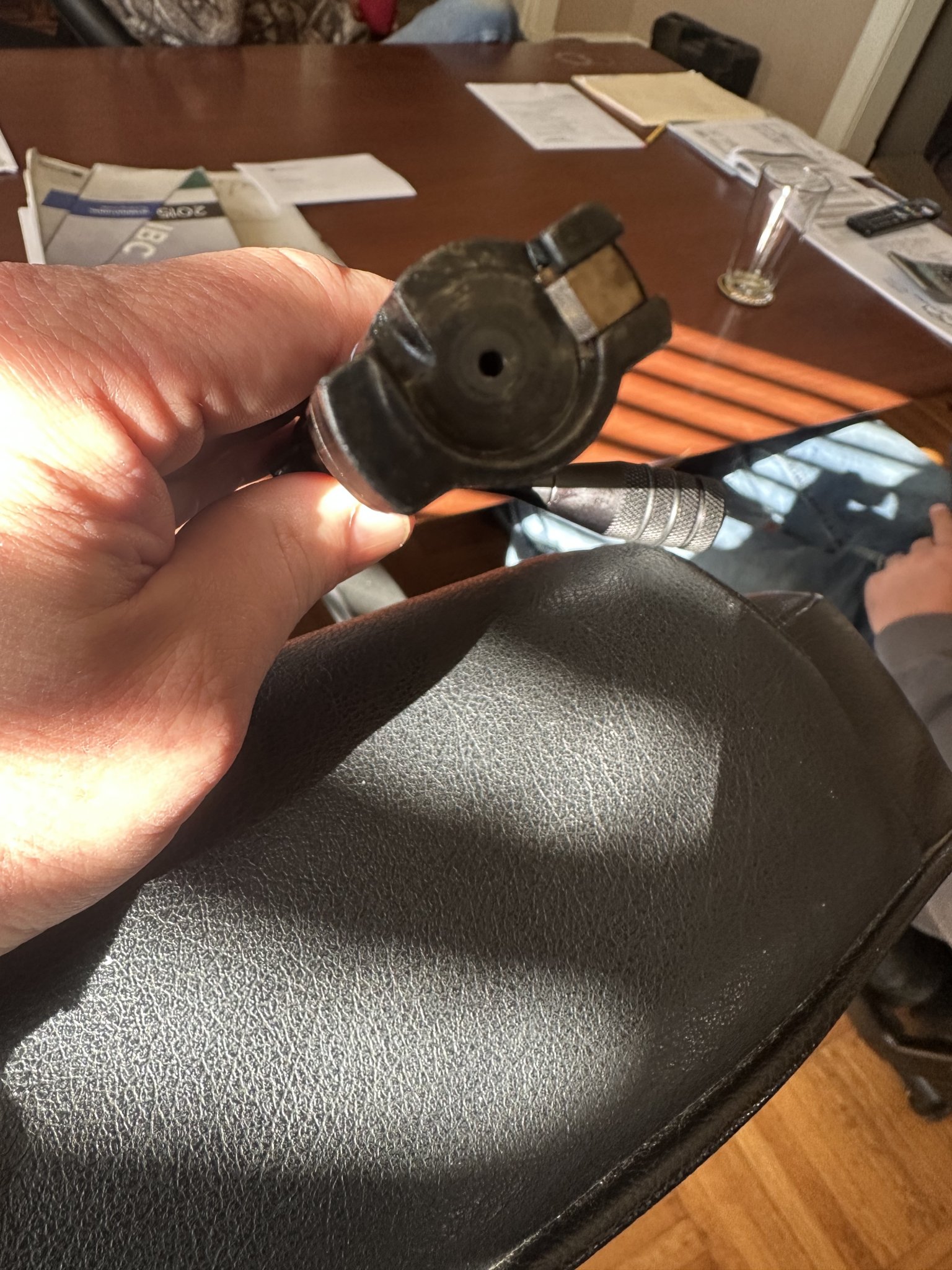

Pic of bolt face

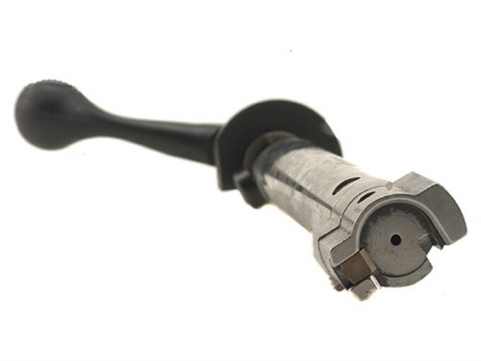

That looks fucked-up. Here's a pic of what the CRF bolthead should look like, your receiver should be as I mentioned above- or you have a mismatched bolthead. If your receiver is not set up with the ejector for CRF, the bolt is mismatched- get a push-feed magnum boltface.

The bigger extent ball aids with ejection. The savages have a habit of dropping the case off the bolt face before the spent case can eject due to the weak extractor

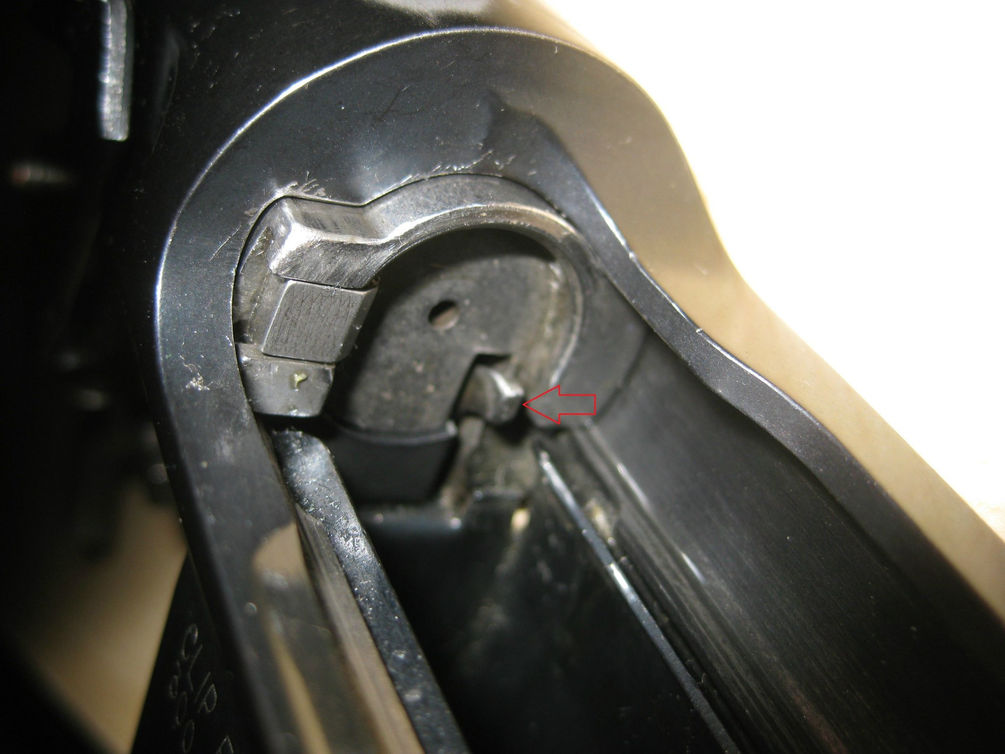

If your bolt head is cut for a mechanical ejector, you should have an ejector piece mounted to the frame that will fit into the slot on the bolt head when the bolt is fully retracted, as pictured here.
Some shooters bend the ejector down to aid in a smoother bolt throw, so you might have to carefully bend it up a little to get it to work right.
If you don't see the ejector there, you will need to buy a short action magnum bolt head with ejector, as mechanical ejector's are very hard to find.

It’s under the extractor. Put the end of the bolt in a plastic bag to keep the parts from flying around. Just simply push the extractor toward the center of the bolt head until it pops out. The ball and spring are under it. Replace the ball and just slide the extractor back over
A small flat heat screwdriver is best. You’ll use it to hold the ball/spring down to slide extractor back on
If you slip while putting back together your detent ball and maybe extractor/spring fill go flying. Hence the plastic bag trick
It’s super simple. I’d also check for burrs on the extractor while apart. I also put a drop of oil in the hole when I have apart
I carry a bottle of those balls in my truck. Can change on the seat in 30 seconds if need be. Have come across enough savages that do that to justify carrying them in my truck to help others when needed.
This is what you’re replacing
I push to center to remove then install back in from outside like this pic
