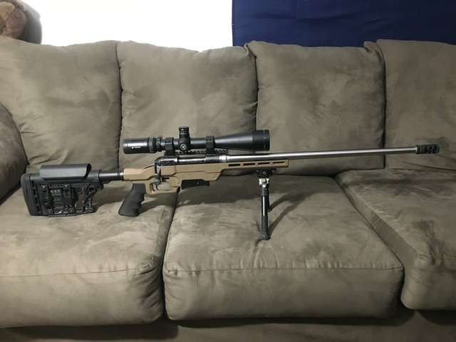

I have a Savage 10 fcp-sr short action chambered in 308 and have shot that for the last two years while learning the basics of marksmanship and intermediate/long range shooting. I have it in a MDT LSS chassis with a LUTH-AR buttstock, and topped with a Vortex HS-LR 6-24. The gun does great and is a ton of fun to shoot. That being said I was looking to upgrade to a bit more of a wind cheater and decided to go with the 6.5 PRC. I’m a hunter and the game I chase will make this rifle a do-all set up for me.

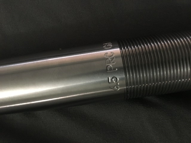

Barrel:
I bought an small shank X-Caliber prefit, stainless steel match barrel. 22 inches long in a #5 heavy sporter contour. It weighs 3.01lbs bare for those interested. It is also threaded for a muzzle device.
Freebore:
After a lot of researching, I decided to go with the GA reamer spec and get my barrel chambered for .130 freebore. I chose this over the .188 FB because I will be reloading and wanted the option to play with seating depth and not be limited to mag length with a larger jump. Time will tell if that was the right choice but that’s what I did. X-Caliber were the only company I talked to that would help with this without spending a buttload more money for a ultra top tier barrel. They rented the reamer from 4D reamer rentals I believe, and all I had to do was pay an additional rental fee.

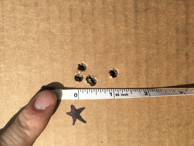

I have only shot a 20 shot break-in as of now and the velocities were a little low (2680 average w/52 grains of H4831SC) but were climbing as I fired more rounds so I’m hoping to end up around 2850 or better with 147 eldm once I work up a load.

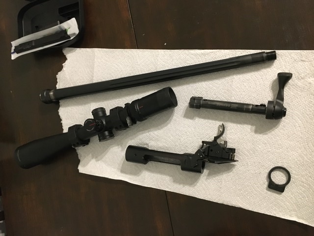

For any interested parties here are some weights of the original parts:
Action with accutrigger 1 lbs 1 oz
Bolt with modified knob 12.8 oz
308 20in fluted,threaded barrel w/ oem nut 3 lbs 1 oz
Oem recoil lug 0.7 oz
