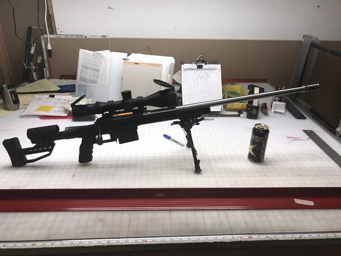

For mating the Athlon scope 30mm tube with the 10FCP, Seekins Lows and a Seekins 20MOA base will fit the bill just fine. It will allow enough space to install Aadmount caps, and be low enough that you won't have to stack tons of crap on the stock to get a good cheek weld. That is, IF you are not planning on using a chassis with a full handguard.
