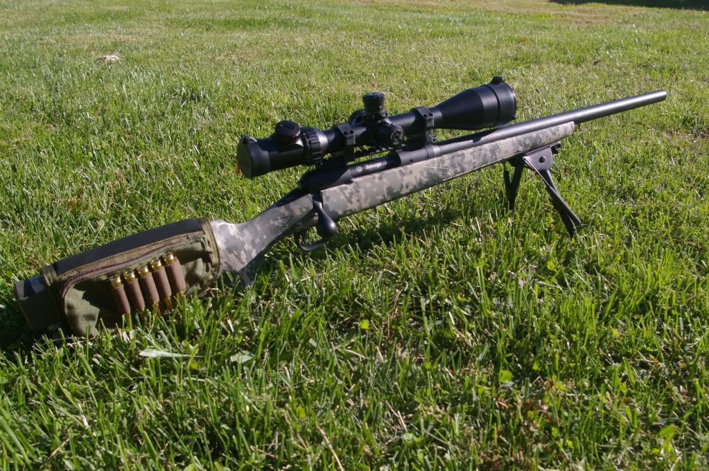

I have a 10PC with a Millett TRS 1. I went with Badger 20MOA base and medium rings. My thinking was that these will serve me well even if I decide to move out to further ranges or upgrade my optics. Instead of a karsten cheek piece, I opted for a Eagle butt pack.
