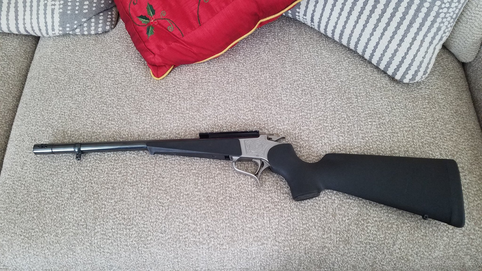

Hits hard on both ends, but the worst is my 16"TC Contender in 45-70.
Typically, it's fired with 400gr Speer flat nose bullets.
I tried a red dot on it last year and it broke the internals, and the front lens nearly came completely out. 😂 Ouch.

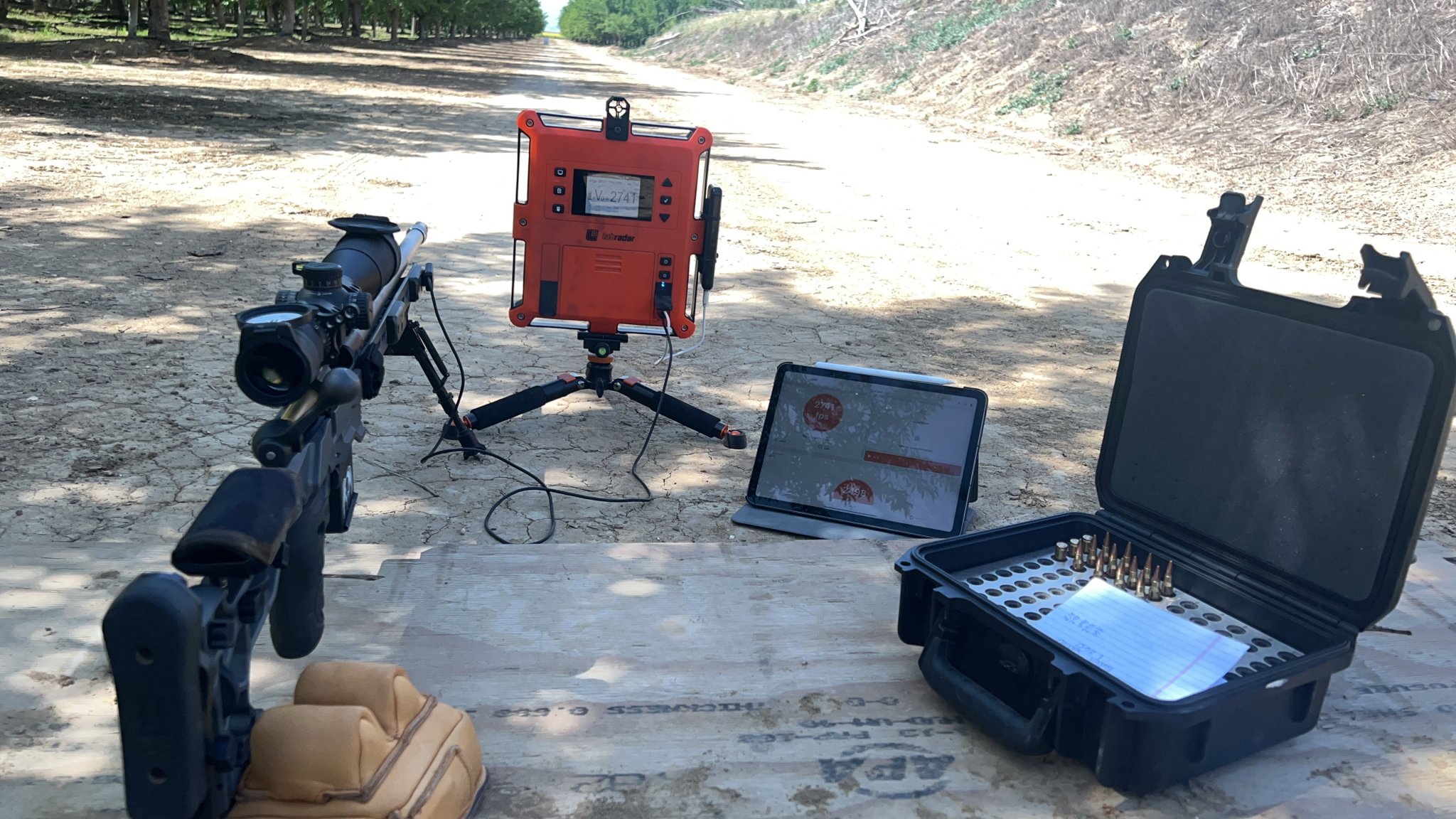

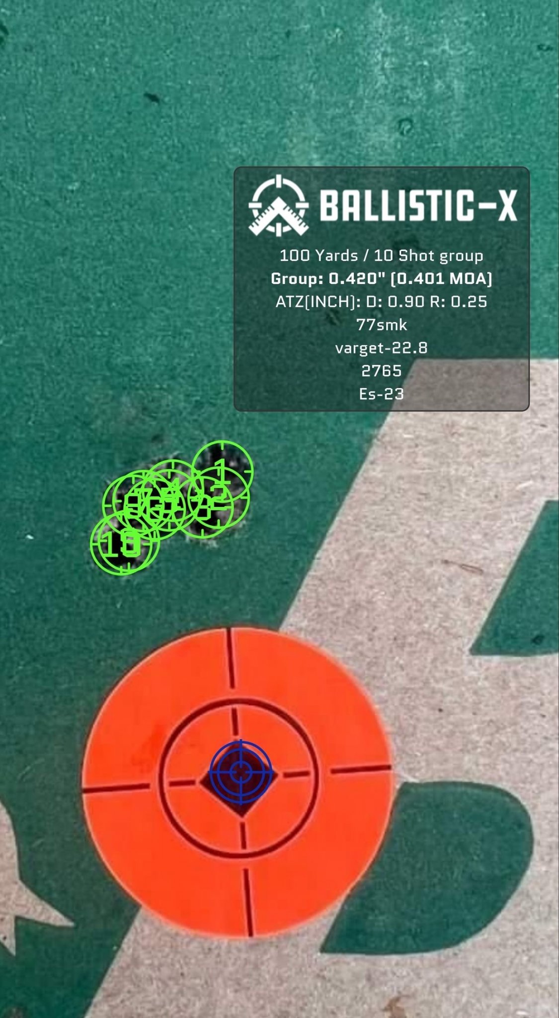

After owning the savage 223 I’ve had 2 issues one can’t get an ES lower then 10 unlike all my other rifles even after trying multiple powders but I stuck with Varget, 77smk, neck turned lapua brass with about 2760 fps but I do average about 15-22 es with 10 shots and a harrell tuner break with my best group being .282 3 shots but under half MOA with 10 shots every time! So far no issues an amazing trainer and have taken it out to 1000 yards no issues besides the wind lol killed 3 coyotes with it! Only mod I had to do was file down the magazine on the accurate 10 rnd mags
