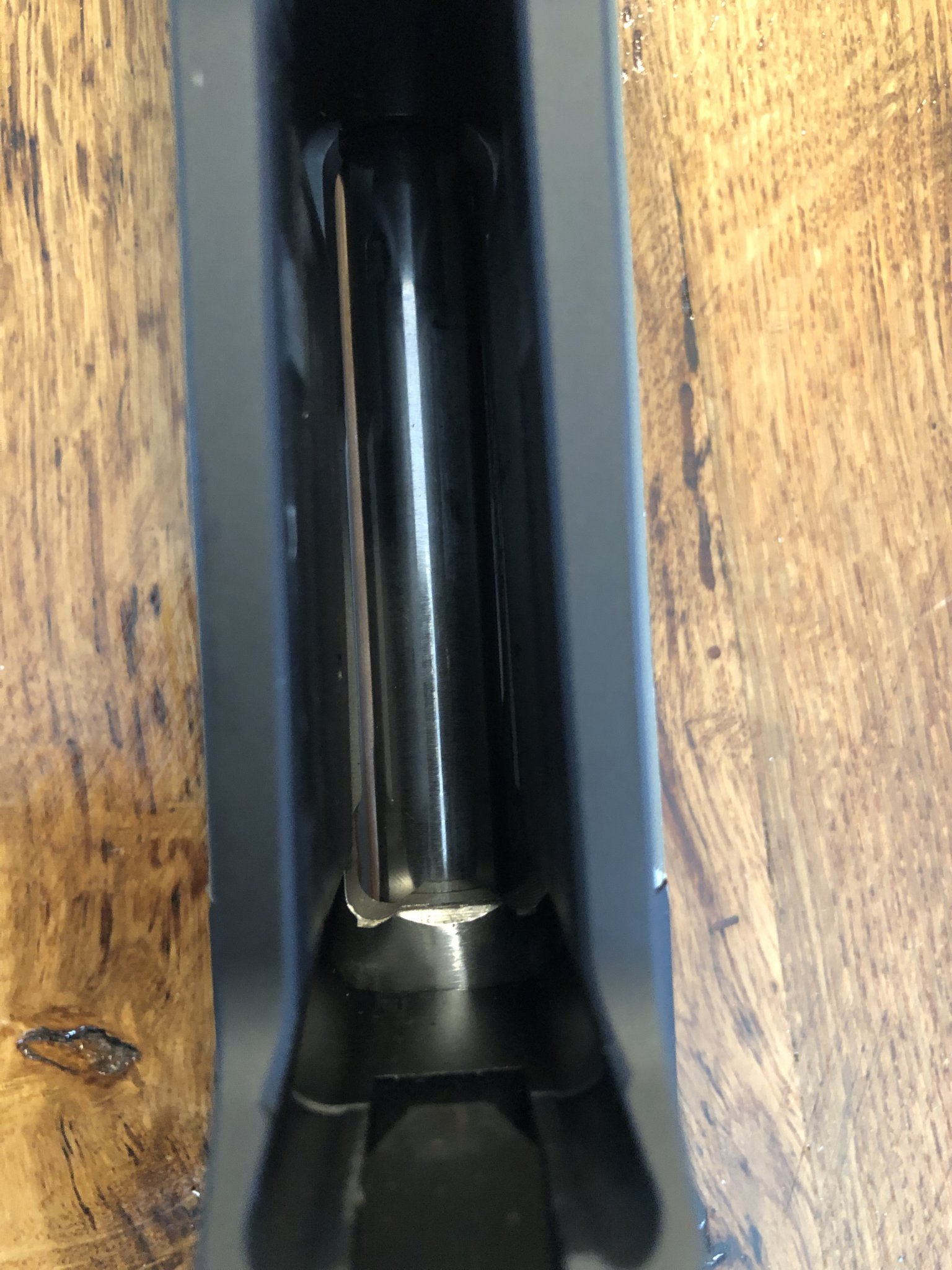

Looks like mine needs .320” removed!
The line is back of the mag well on the chassis. That metal covers up that much of the AICS Mag and would not allow proper feeding even if it would somehow seat.

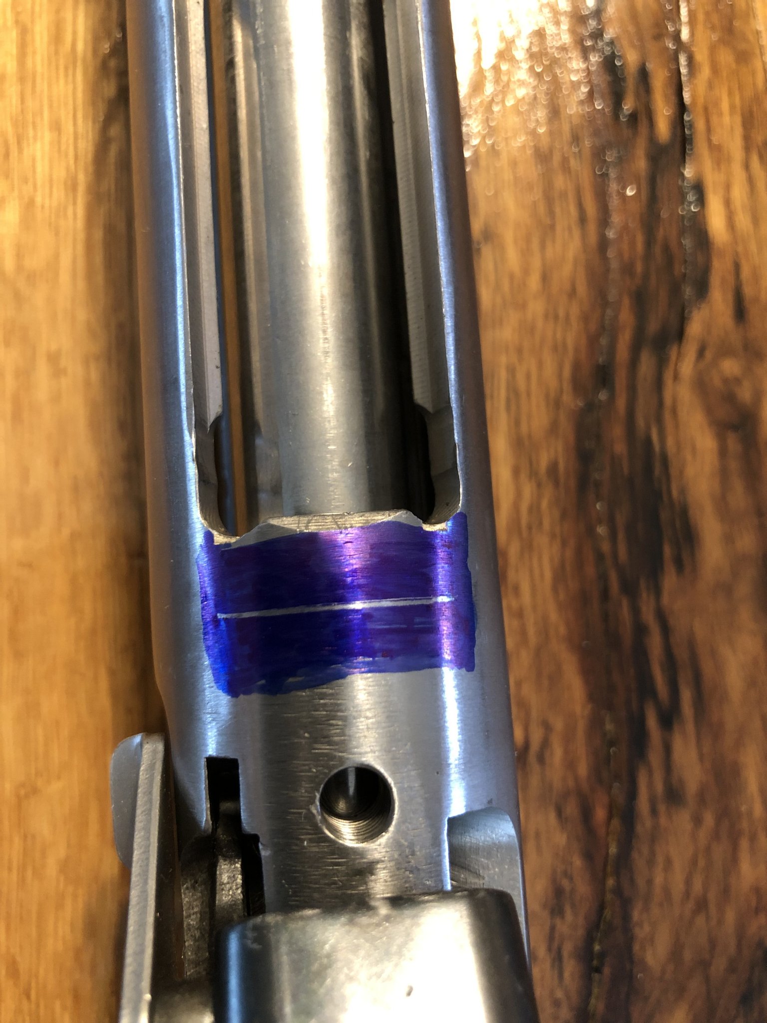

For future reference, I milled out my old Savage 116 stagger feed action to fit the 3.715" AICS mags used in the Oryx long action chassis. In the photo above, I scribed a line on the bottom of the action where it met the mag well opening. Having zero information other than "that material needs to be removed", I milled it out. This allowed the mag to fit perfectly; almost! Applying pressure to the bottom of the mag allowed it rise up and would prevent forward movement of the bolt once retracted. 🤔 🤔

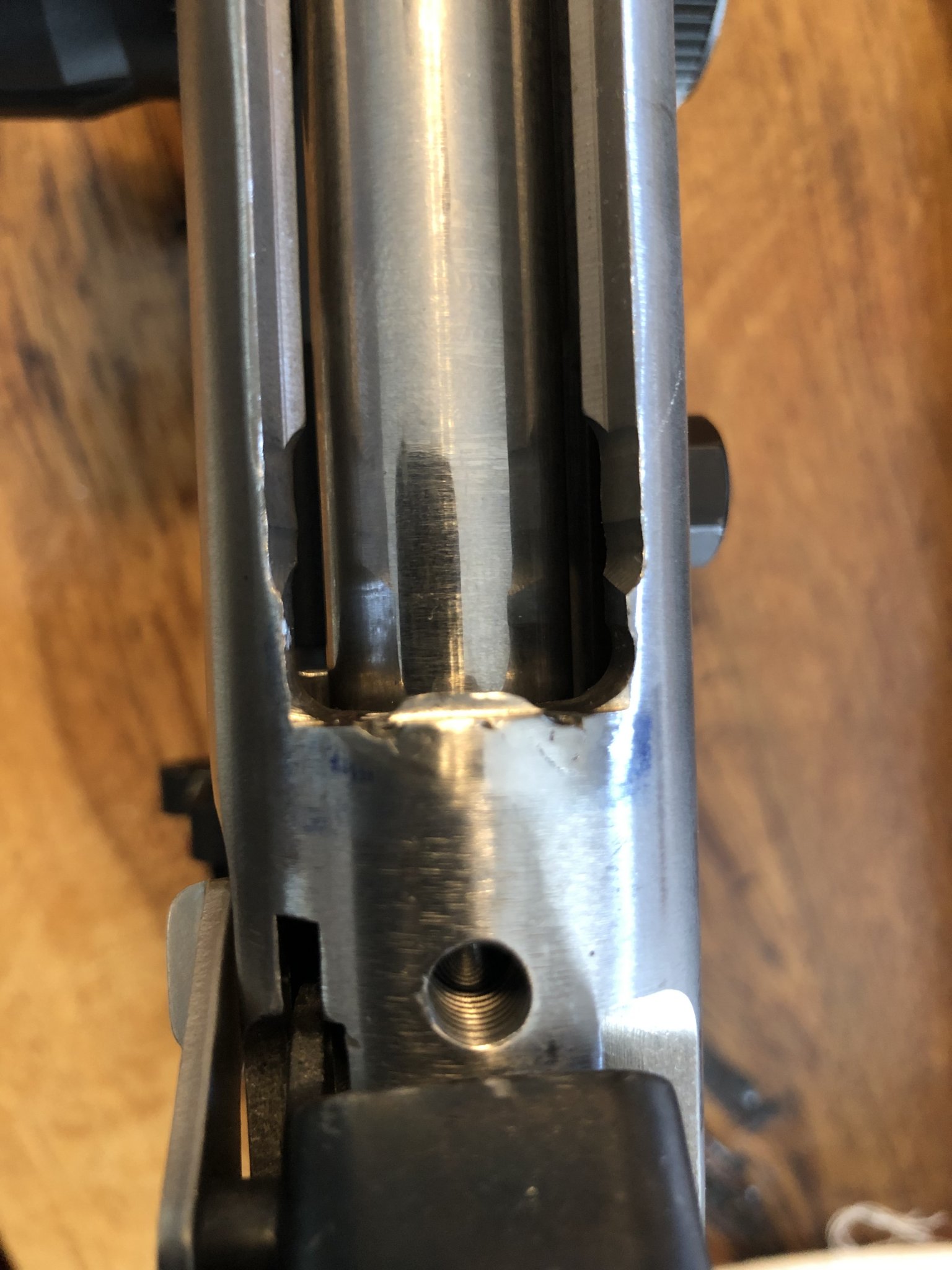

A magazine stop was needed. The old adage "measure twice, cut once" was not applicable here as I had nothing to reference and a mag that was longer than the cutout in the action. Fortunately, I own a welder :oops:, and since this a Savage action, what did I have to lose:ROFLMAO:? So, I loaded 1 round in the mag, inserted it and pushed the bolt partially forward, then retracted it and scribed a line with a dental pick along the back edge of the AICS mag / action interface. My measurement (with Mitutoyo digital calipers) showed .065" from the bottom of the action should stop the upward travel of the magazine, but material needed to be added. A couple of zaps with the welder (with 308L stainless wire, in this case)
and the protrusion was formed. A few light passes with the mill down .065", a little light cleaning and polishing, and Viola, a mag stop is born! [See pic below]
Feeds and functions great, or a good as a retro-fitted Savage can!
So, to anyone attempting this, be sure to leave a little (.100"+) forward of your scribed line, mill down .050" along your scribed line and do the final fitting from there.
