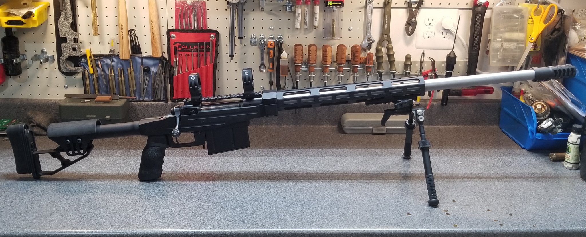

This one started out as a pre Accutrigger package rifle in 30.06 given to me.
Swap bolt heads/firing pin for 300WM, Timney trigger Shilen Select match No.7 barrel. XLR chassis with mercury recoil reducer, Witt clamp on break. It will cost you a small fortune.

Spot on! But it was free, at least at first.🤪
I do run a bolt lift kit and extended bolt handle. The mag well on the reciever needed opened up to take full advantage of the Accurate Mag length.
I've had the rifle for over 12years, it's been in more than one stock. Its had both a factory 300wm (free again) as well as the current Shilen (not so free and chambered and threaded with a shoulder instead of the barrel nut.)
I felt bad with it sitting in the case for so long in the old laminate stock and no scope that I went with the chassis which also got me a detachable mag vs the old blind mag feed. To save a bit I bought a FFP V3i Leupold in the PX.
A factory rifle would have probably been cheaper, but what's the fun in that.

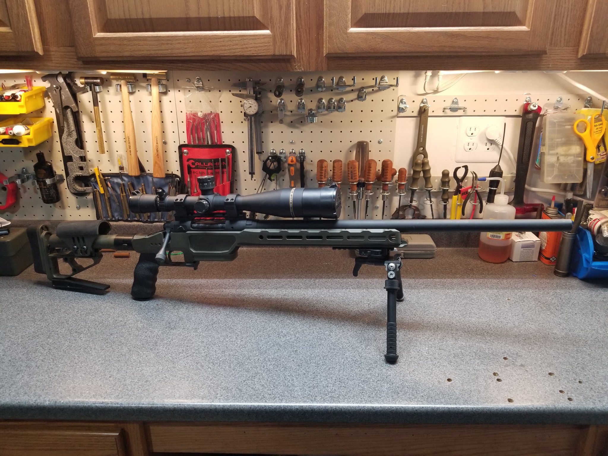

The one on the right is an old flat top that I've been hunting with for years.
6.5-284 norma. New barrel coming for it hopefully in May. Same caliber
I put it in a XLR chassis about two years ago.
The one the middle I've been shooting in matches since 2012. It came out of savage's coustom shop, the way I wanted it.
260 rem. target action, with the red blade. Accurate Mag bottom metal and mags. Left hand bolt right hand port.
26" barrel threaded for a break.
Bolt runs smooth . No failure to eject!!!
Put it in a MDT chassis about 2 years ago. Its the nicest bolt gun i own!
And just today, the one on the left, I picked up this afternoon.
Their 110 Timberline left hand in
300 WM.
It may turn out to be my go to hunting rifle?
I'm such a sucker! 😱😉
