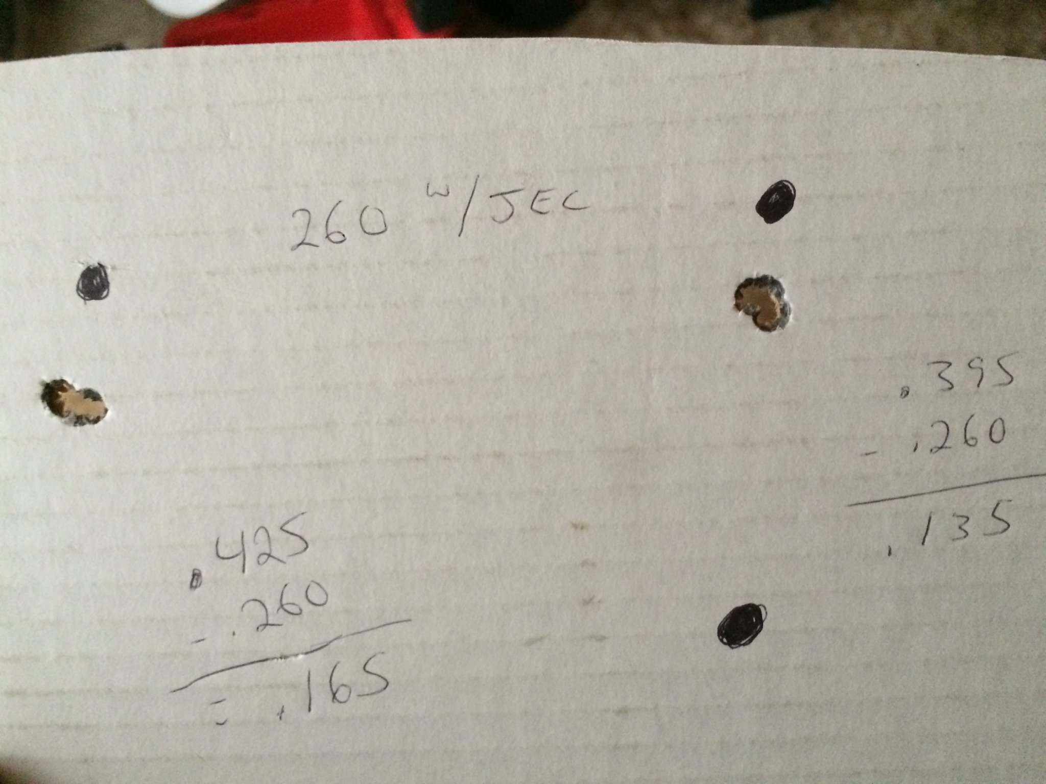

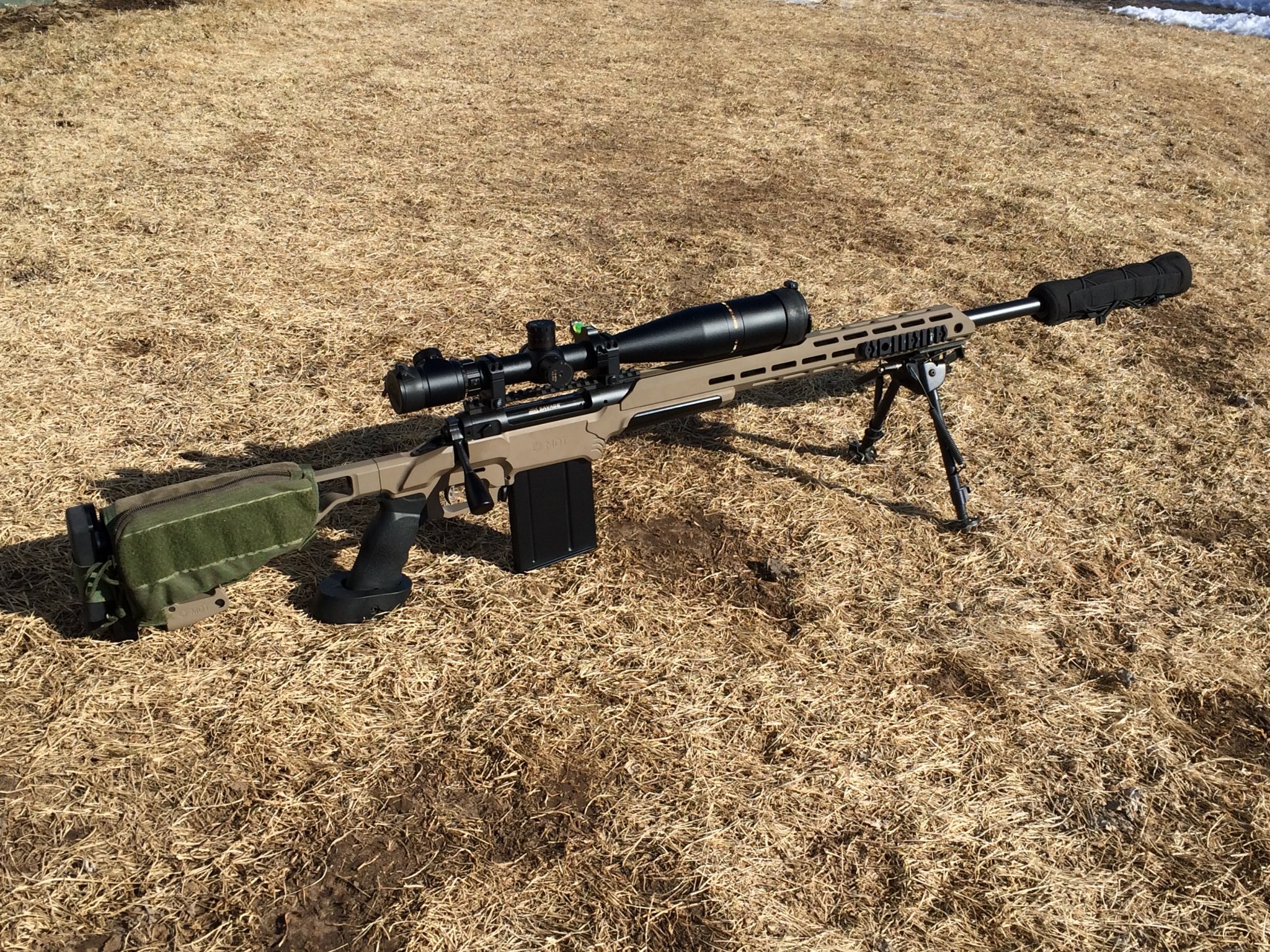

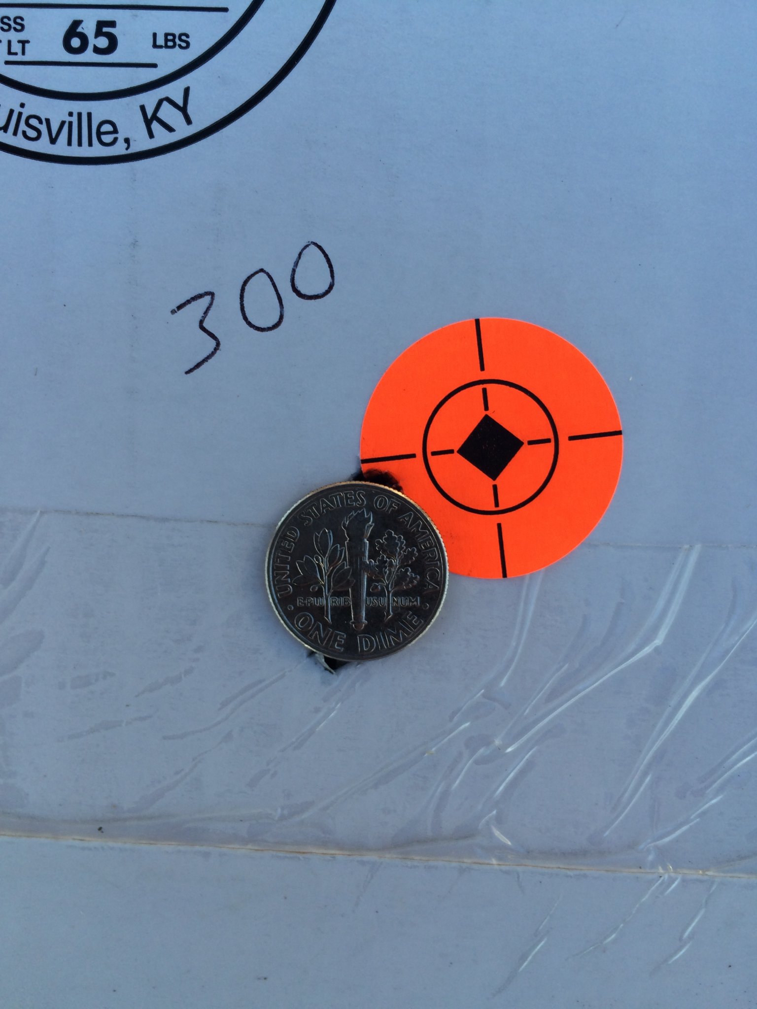

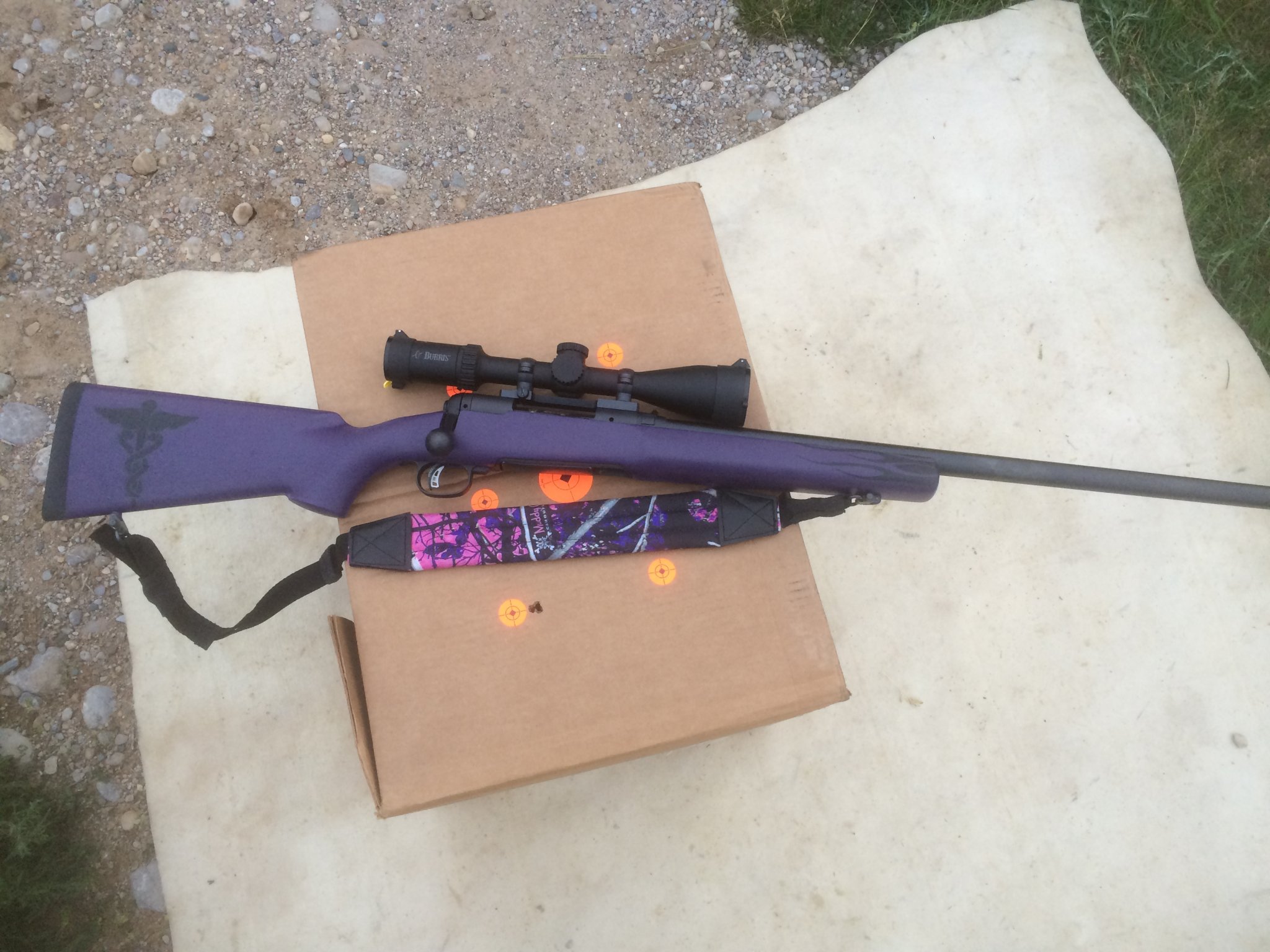

The 2 below are mine that I built for long range (260/300). Other is my wife’s 308
The 260 (black/stainless) rifle is my first real Savage build I did. Few groups out of the CBI barrel. 100/300/600 (5shots under bic) yards.

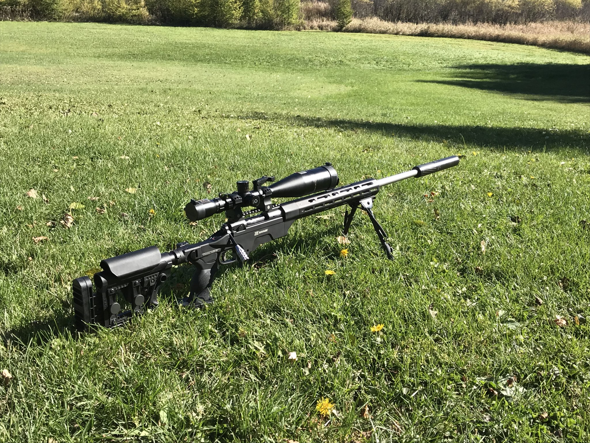

I used a 308 for many years. Since went to the 260 pictured above. Have shot that rifle to 1,792 yards with decent results
