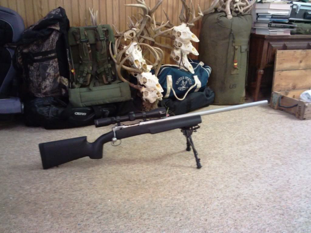

Here it is, at long last. 6.5x.284 Norma, 26" Shilen 8 twist ratchet rifled 4 groove, B&C medalist stock, and that's a Burris 2.5 to 10x42mm 30mm tube on it for now.
I still have a paint job to do on the stock, but I'll do it after the barrel break-in.
